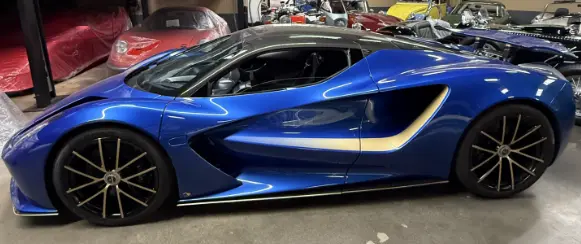

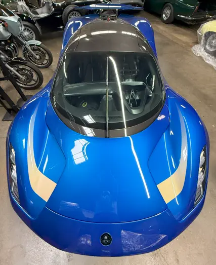

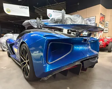

Looky what I was blessed to see when I dropped of my car. If I trade my Emira in I only have to pay $2,200,000 more. Deal or no deal!?

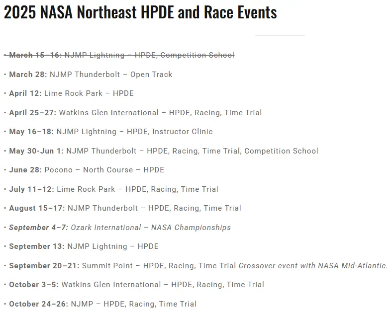

Tracking the Lightning track at New Jersey Motorsports with www.nasane.com on 5/18 if anybody wants to join me or watch.

Anyone down for 5/18 or any other events?

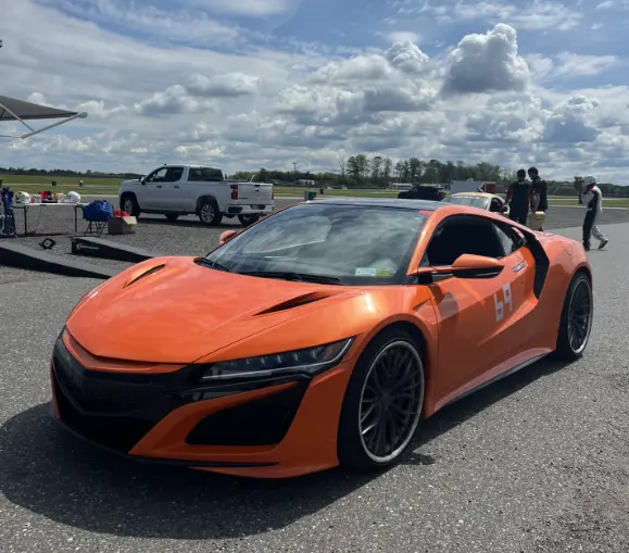

I'll be tracking my tuned 2019 NSX as well to drive in a different group
