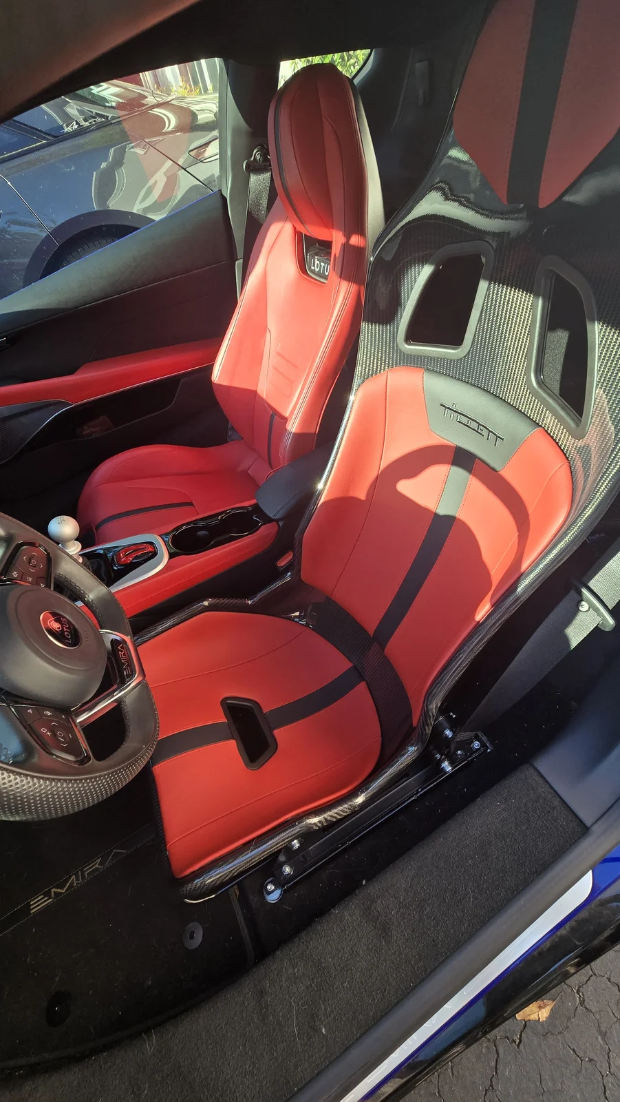

Here are some pictures of the red leather version.
They look incredible. Just waiting fort the next sale at GRP now that the US Market passenger seat dilemma has been solved.

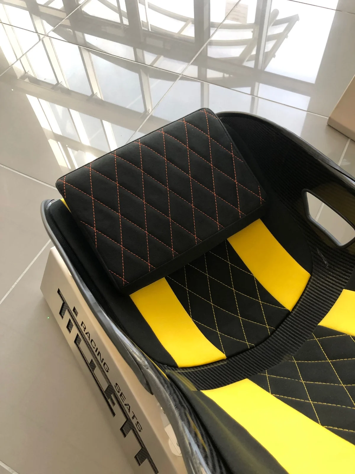

One thing I do find is sometimes people sit the seats too upright. Then the front goes down and the under leg support is lost. It's usually better to have the seat with the bolts set parallel and then pull the steering closer.
During use the body is properly supported so you will not notice the foam missing under the legs. If you do we can make a support cushion such as this.
This is rarely required though.
