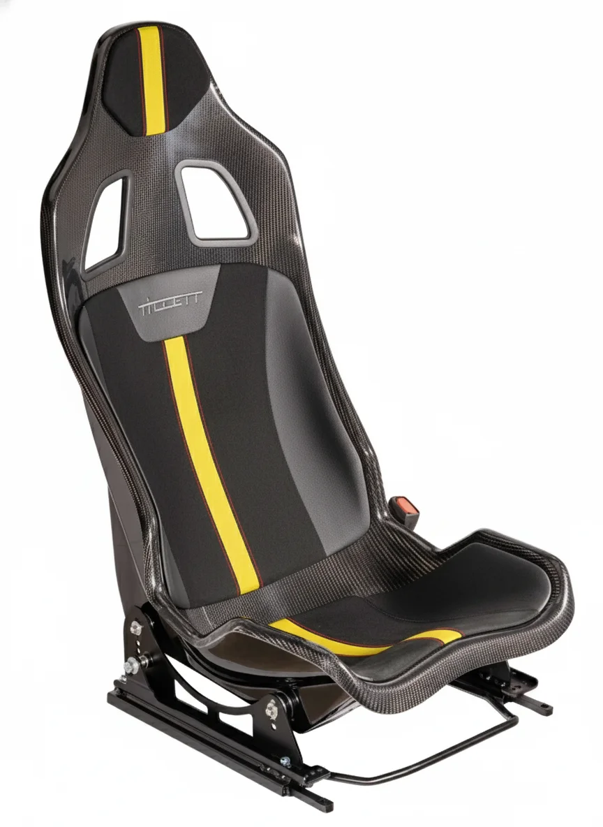

Seats are clearly a big upgrade for weigh reduction and that will be on my list probably for 2026. I’m not fully sold on these but they are growing on me and love the color match leather options.
My question is for those that have the seats any discomfort with the bottom opening in the middle? Seems like it’s right by the family jewels…
Do you drive in the nude? 😁 in that circumstance your dangly bits may get more freedom than required. If so, we are more than happy to make you seats without the crotch hole.
You will be stunned how much more comfortable they are than jiggling around on top of the foam standard seats. I struggle with people’s perceptions based on the look of them due to having little foam but I can promise you that it will change how the car feels completely.
Haha no nude driving for me. 🤣
Yeah I heard the positive reviews. Just from the looks of the opening seems close to where you would sit and see how others have found that to be an issue or not.
Hi @Steve Tillett , I appreciate if you can help me on this, I want to buy a B10XL but have some uncertainty.
I have athletic lats while being an average guy 190lbs, waist 34, 35. I cannot bear the feeling of seat bolsters poking into my lats. I sat in a Porsche GT4 bucket seats today and that barely felt right. I could already feel it poking into my lats.
I measured the width of area that supports lats in that car from side edge to side edge and it is around 17" (43.18 cm). When I look at B10XL, the inner width around the lat area is 38.5cm.
Is this an apples to apples comparison? or is the design of B10XL somewhat different such that I don't have edges poking into my lats? Really appreciate your guidance on this and any thoughts on how GT4 buckets and Tillet B10XL compare and contrast. I just want something that let my shoulders and lat be free while provide support at rib cage ideally.

You would want the XL. My son is the same size as you and is also wide under the lats. He uses the B10 XL in his M4. The lats down to the rib area is important for support in our seats, as it does this without impacting the arms. I prefer this over the shoulder support which is like someone jogging you mid corner.
Of course they have to fit and as with all hard seats it's not possible to suit every person perfectly, but compared to OEM seats they are surprisingly adaptable to many different body shapes. You cannot go by measurements to compare. With all OEM seats they sit you on thick padding and then give you 14 adjustments to attempt to give the body support despite the moving surface.

Thanks Steve! I just went ahead and ordered 2 XLs with Tan/Black, edges on from GRP. (Please let me know if edges on wouldn’t fit into Emira)

Edges on fit great with plenty of room to spare.

@GRP looks like passenger kit is already shipped! can you explain what part we need to scavenge from stock seat? and do I need to purchase a seat pressure/weight sensor to use with my new seat?

The module that sits under the factory seat cushion needs to be reused, they are unobtanium otherwise.
Those directions should be pretty detailed but let me know if any questions come up!
