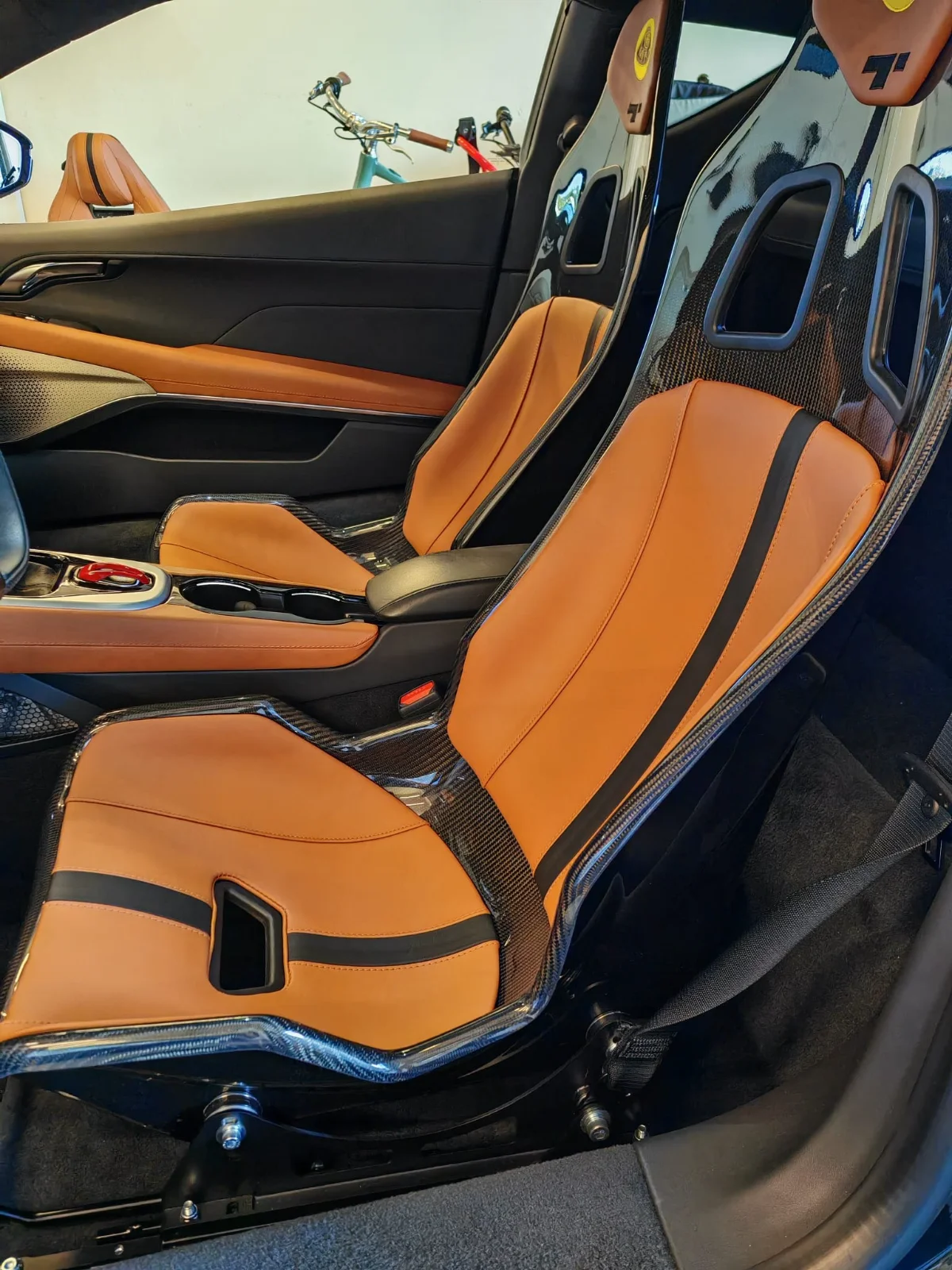

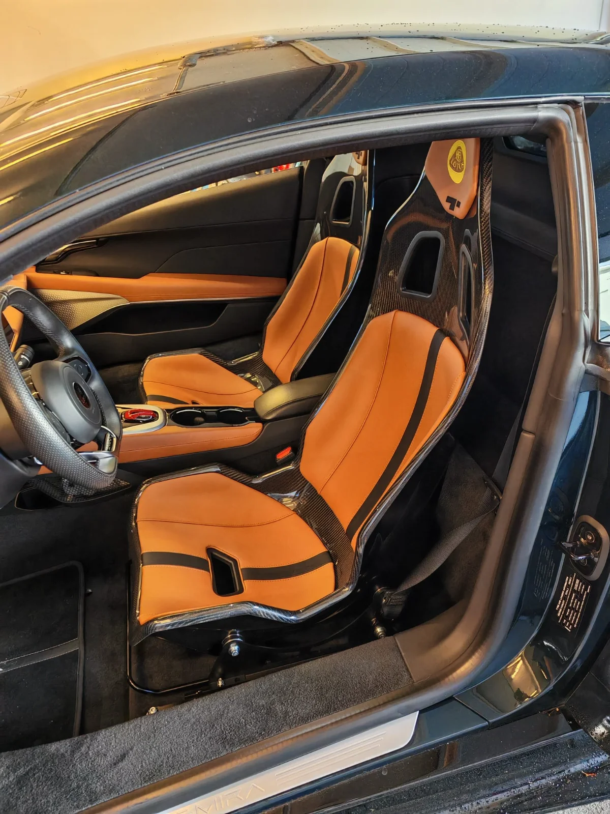

I recently had a customer kindly send me pictures of the Tan seats installed.

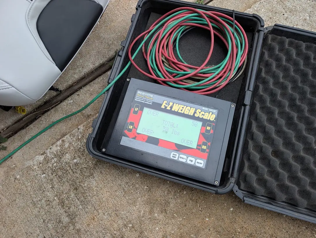

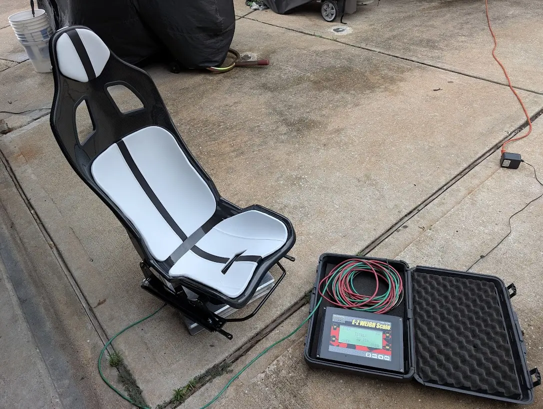

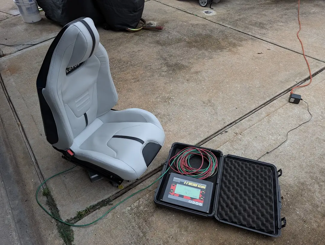

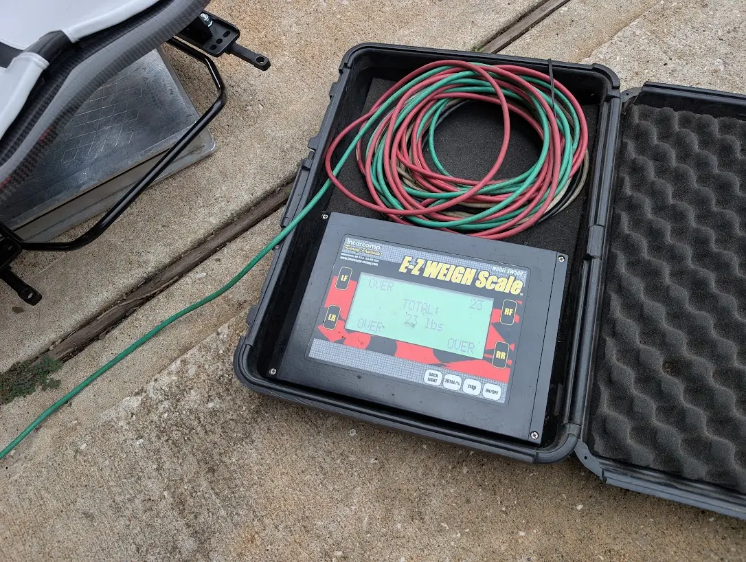

I just installed my seat in today and decided to do some weigh ins.
OEM - 58lbs
Tillett B10 * Tillett rails - Seat pads are EVA foam and upholstered from a local shop = 23 lbs
OEM - 58lbs

The seat pads look really good. Replacing just the driver seat doesn't look like it's out of place. How much does this cost?
Thank you! I'm pleased with how it turned out, especially being ignorant to upholstery/leather work.
I bought EVA foam for the seat pads and sourced leather that was 8/10 match for ice white.
I cut, shaped, and heat molded the EVA to the desired shape then took it, along with the leather materials to a local upholstery shop to upholster the leather.
Upholstery shop charged me $400.
OEM - 58lbs

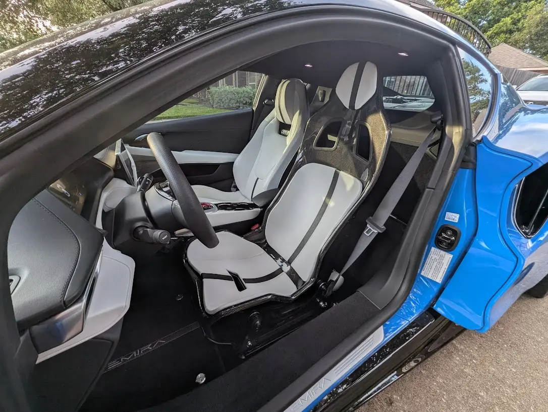

Can you perhaps take a picture from the front screen? Im curious to see how much higher the tillet seats headreat is compared to the stock one. And is the tillet installer on the lowest points? Thanks
OEM - 58lbs
I have it installed in the highest position and it was identical to my previous driving position. I'm 5'6" with a shorter torso, 30" inseam.
