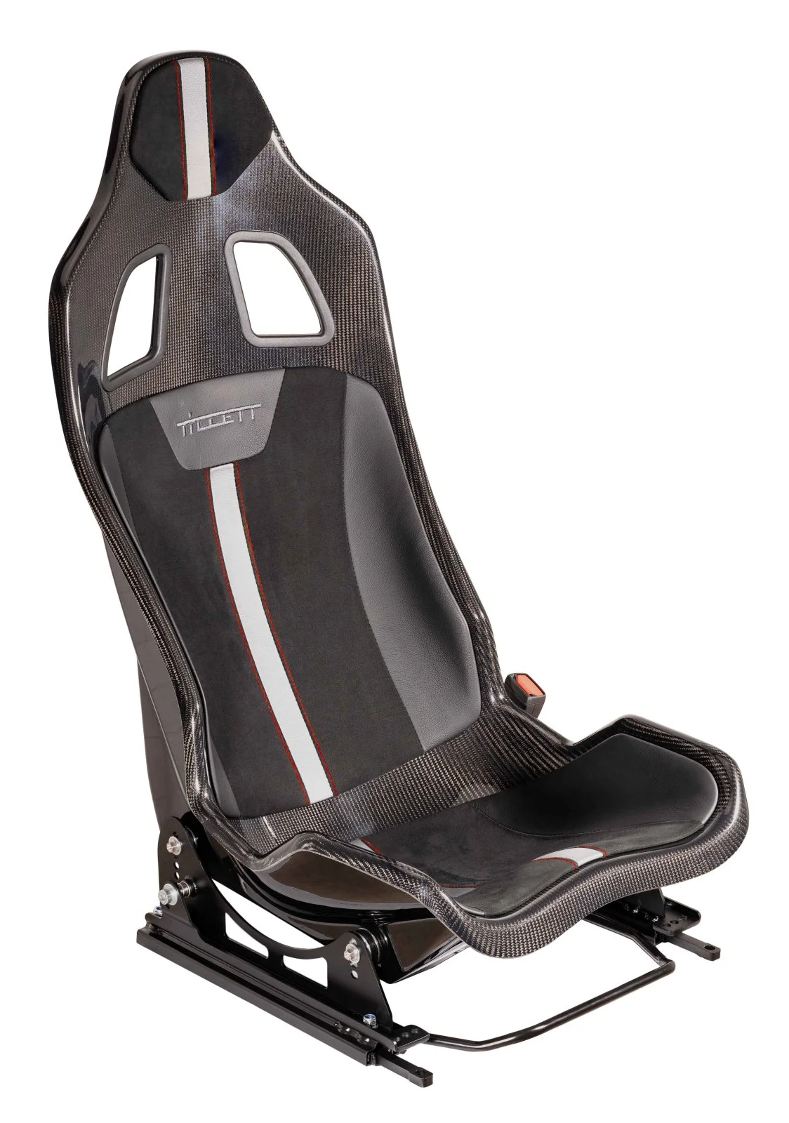

We could always do something like this
A White leather stripe and stitching, then it would not matter if the white was not perfect shade.
We did look at getting the actual Bridge of Weir leather but it’s not a consistent supply. Here one minute gone the next, Therefore it’s hard to sell products on the basis of colours that may go out of stock next week. The tan is easy to match with a standard colour.
i would personally not want alcantara at all.. The red stitch to be yellow, so now my mind is running and I might have to look into this more. :)

We could do them all leather with red stitching. But really we can do what people want within reason.
We don't use Alcantara, Our Dinamica autograde suede material is what Merc and Audi use. I am told it's harder wearing and more colour fast.

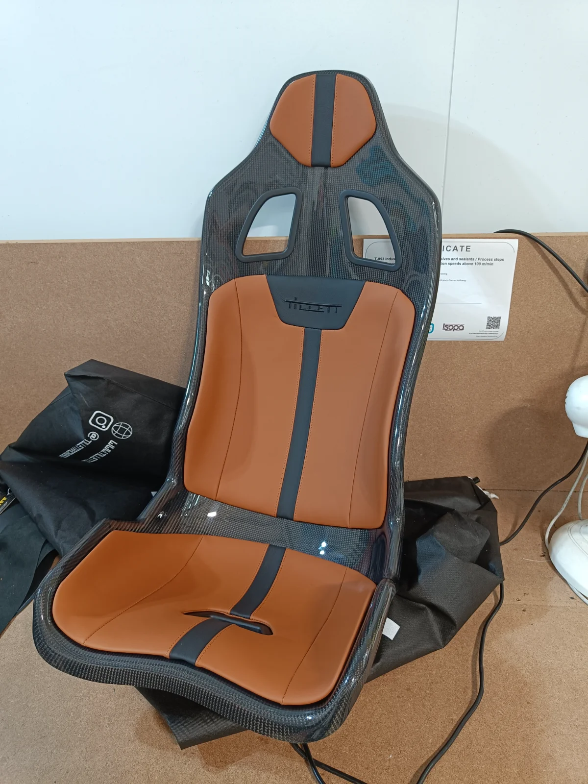

Is there a photo of these tan seats installed anywhere?
I will see if I can locate a customer and get a picture of them in the car.
I have another picture of the seat out of the car.
Thanks for that. I can’t wait to see what these seats look like with the tan leather interior.

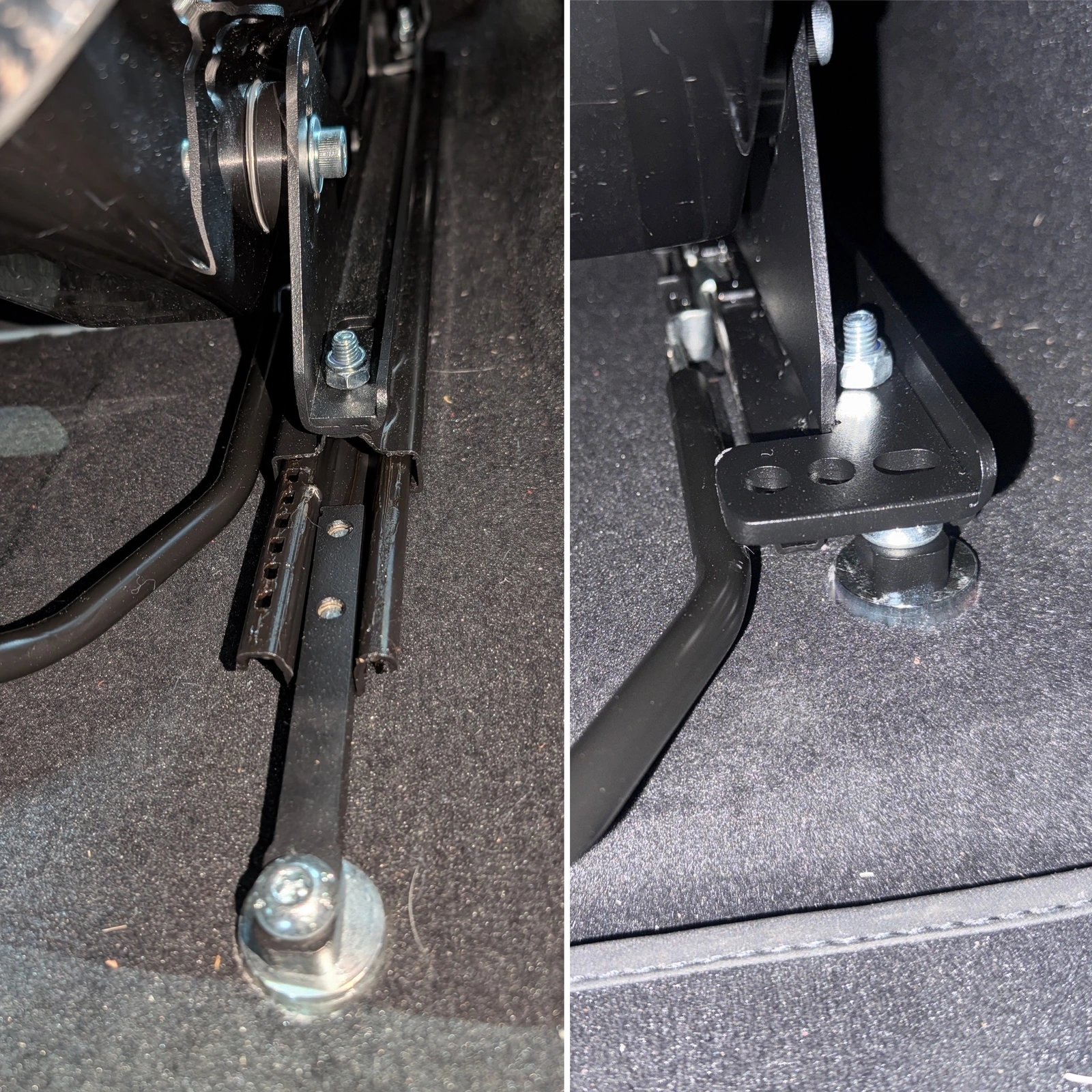

What’s the difference between these 2 sliders @Steve Tillett?
Different models or is one a revised version?

Revised model. Batch one was made with the tab to be an Exige passenger bracket too. But we decided to take it off as it made the bracket lighter and better looking.
