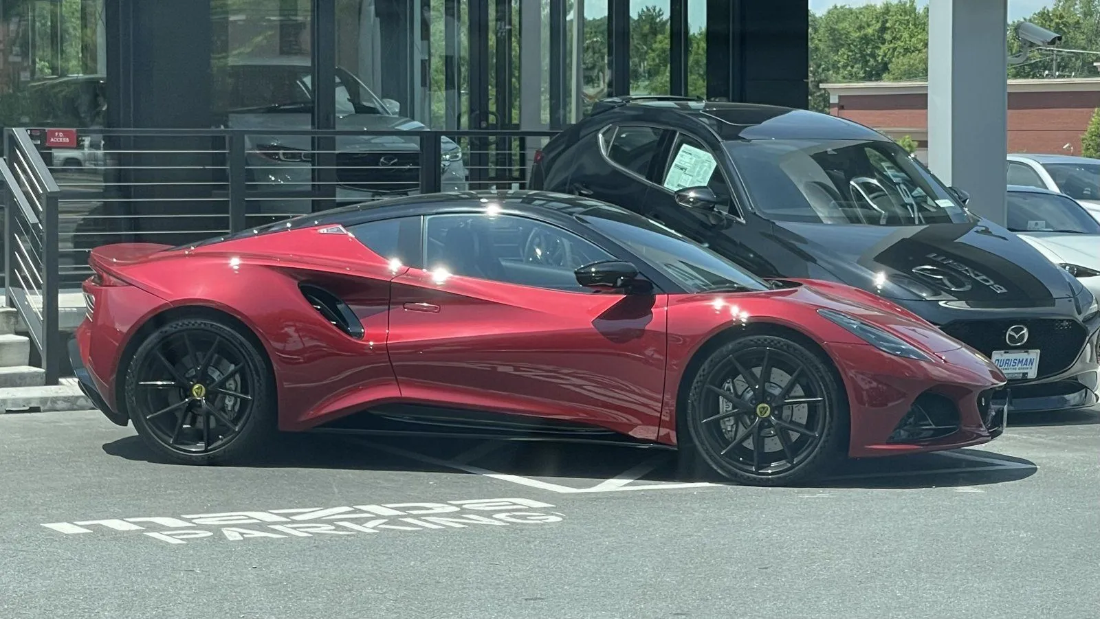

I think the lowered Emira’s look weird with the wheel edge at the top of the arch and the slides of the arch at the normal distance. Not a fan of such a big drop.

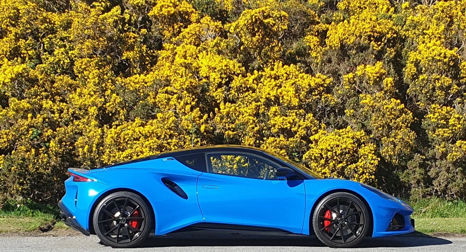

Stock Magma with Cup 2 tires. Shadows are covering part of the tire sidewall, so it looks higher than it is.

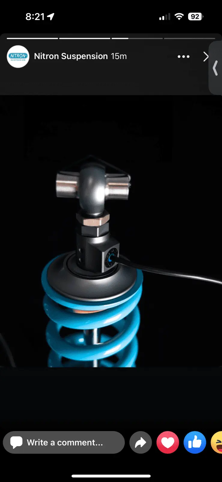

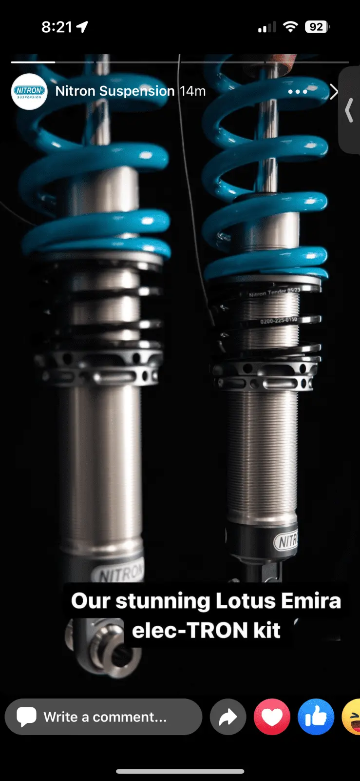

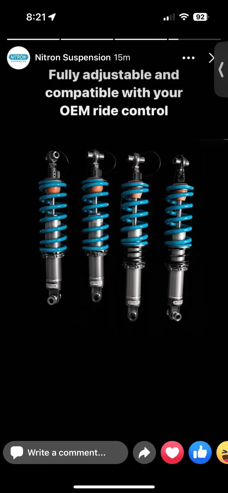

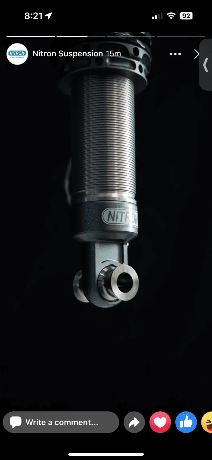

Looks like Nitron's elec-TRON kit is ready
Hope they release more about the controller and how it’s tuned, what kind of adjustment is available, or if it’s dynamic like the DSC systems.
yeah, that last one says "compatible with oem ride control" wonder if they mean it can be tied to tour, sport and track modes. That would be really cool.
Must be a generic description since Lotus has passive Bilsteins and the different drive modes can't change dampening.
yeah no I know that, I meant I wonder if they are going to make the electronic control module for their elec-TRON supension work with the OEM switch.
