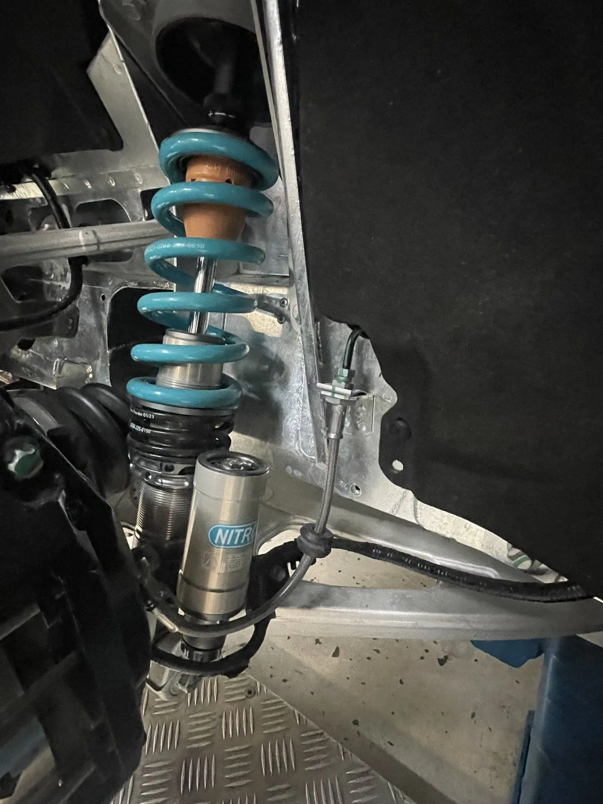

Ooh, fancy!
Do you have to take the wheels off to access the adjusters?
Rear rebound looks like it would be difficult.
