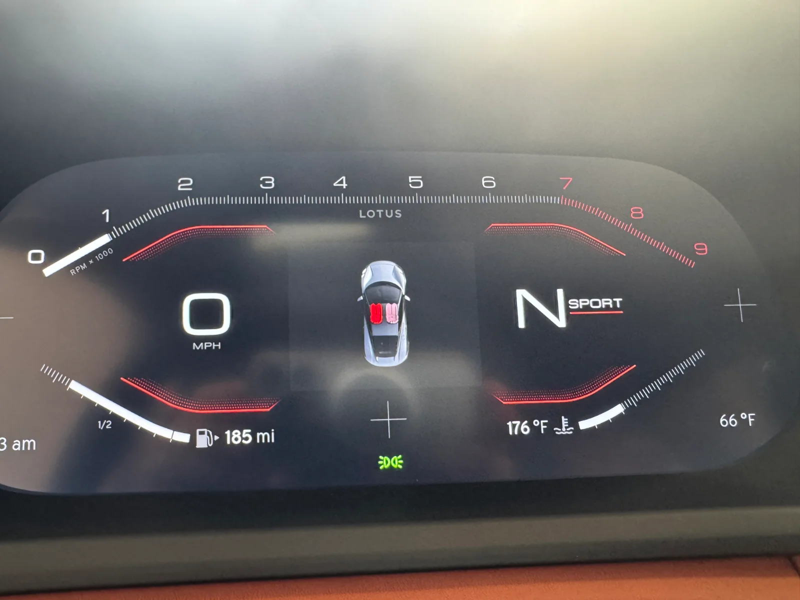

It raises it in all modes yea next time I’ll take one in sport.^^^ Thanks, is it only raised in Track mode? Can you take pic of Sport dash?
Interesting bc sport shows 7k. I usually only drive in track mode like 99% of the time if I do the other modes it’s only for cruising on highway, but when I want to get on it, it’s always track for me.It raises it in all modes yea next time I’ll take one in sport.
