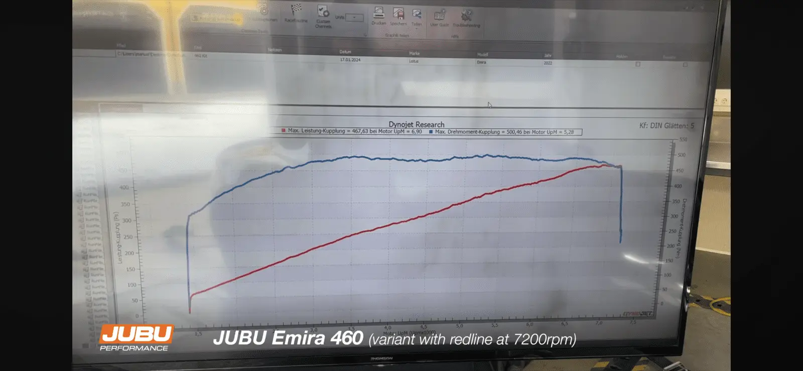

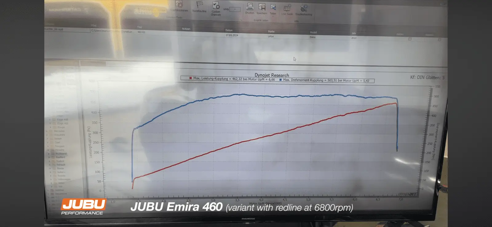

I was about to post that! They also posted a version with redline at stock 6800

Neat. It looks like they dial down the torque output from 6800-7200 so the HP just stays flat at 460.

Shame, it won't be pulling quite as hard in those latter stages. I guess they must have their reasons.
A cynic might think that if the torque stayed flat @ 500ish nm, the HP produced at 7.2k might be a bit too close to the very costly 500hp upgrade.
Or am I just a grumpy old bugger?
It really depends.
Mechanical systems often have limits which act more like inflection points, rather than a linear line or a curve. Prior to or even close to the inflection point, the system works nominally and there is only marginal long term wear for each marginal increase in power output. But at or beyond the inflection point, all heck breaks loose and the system is prone to sudden failure.
For example, the valve weight plus the valve spring rate, in addition to the friction in the system, and the oil weight, has a resonant frequency at which point the valve will simply float open rather than close. So, without upgrading some engine internals, there may be such an inflection point that getting beyond 460HP at 7200 RPMS would get too close to, and result in intermittent faults that degrade engine life.
It's really not an issue to have the HP stay flat from 6800 to 7200 RPM, you are still getting 460HP during that range, which is nothing to sneeze at.

460 all the way, yes, but the pull will be declining, as the twisting force actually getting to the wheels is reducing with every extra rpm.
It is what is I guess.
