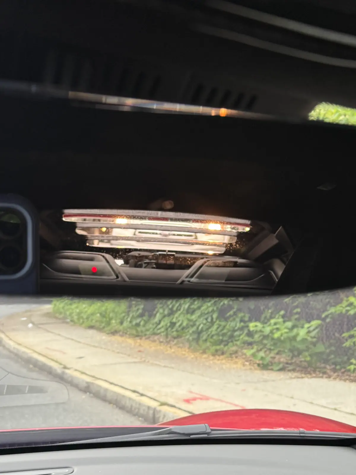

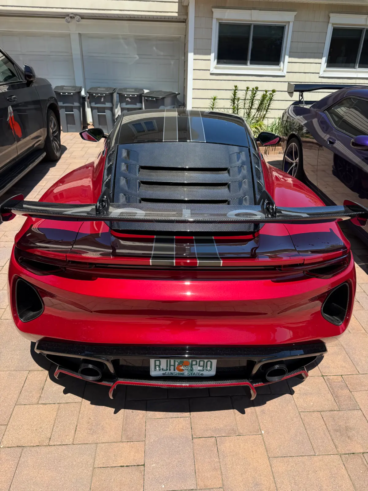

But if you install the JB4, your supercharger will get hotter, so you need this mod and remove the windshield, if you truly want to track the car. My car was driven under 4k and I couldn’t believe how hot the air was coming out of louvres. And it looks sexier also.
You can see photos of my car and also see the visibility from the rear view mirror.
