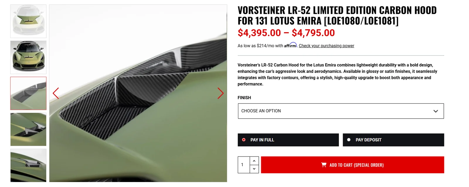

This looks better, but it would be nice if it were functional like the ZR1 hood
