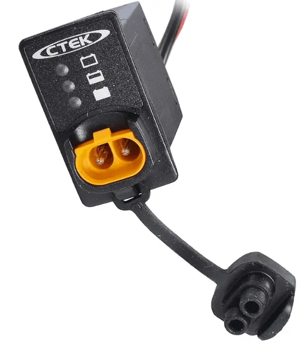

I am considering mounting one of these somewhere in the boot (assuming we ever get the car in the US). I'd rather have an outlet like this to plug into than a cable dangling around in there.
https://smartercharger.com/collections/accessories/products/ctek-comfort-indicator-panel
(edit: it didn't like my Amazon link, so added a link to the US CTEK site instead and a better picture).

Yep, I had one of these fitted by the dealer before pickup. I got the idea from someone on this forum — they’d mounted theirs sideways on the battery cover, but my dealer managed to get it vertical, about a third of the way along the cover. Looks terrific (and they’ve now added it as a permanent “extra option”).

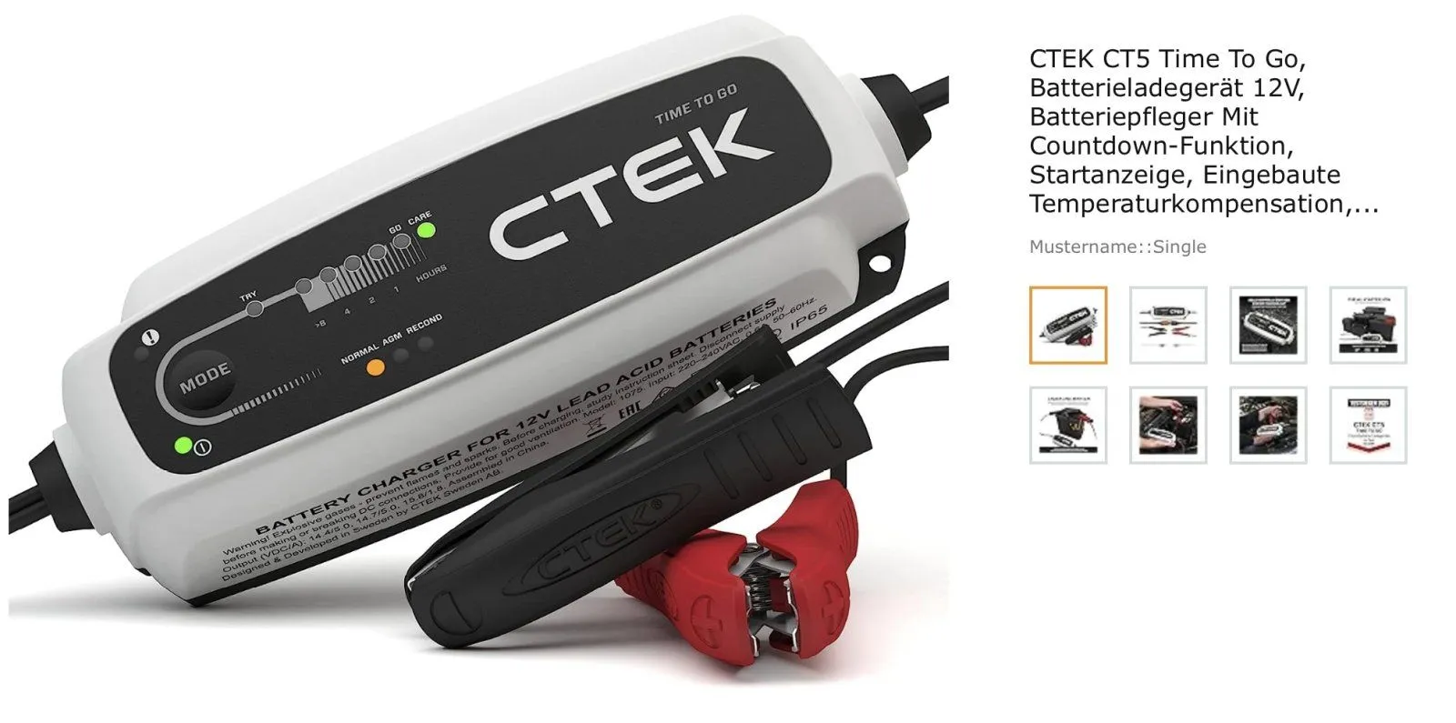

Just tested my new CTEK CT5 „Time to go“ for charging my battery. As my Emira wasn't used very often due to weather and temperatures, my battery was pretty flat.
So connected the battery charger and it showed me a nearly empty battary. It took approx. 4 hours untill the device finished loading the battery and showed „go“ on the display. Worked perfectly in AGM mode! 😃
I have a LiP0 battery and I want to install the ctek comfort panel indicator. It's the one that's just the indicator, and has two blade connectors on the back, but cteks quick connector on the front.
There doesn't seem to be an assembled dongle to attach it. Should I just make one out of 12 gauge wire?
Link for those interested.
Curious to see pics of the back (Amazon only shows front). I might order one for my tractor to test out and see if it's a clean enough DIY for the Emira. It would look slick sitting flush on the battery cover or trunk liner with nothing dangling about.
