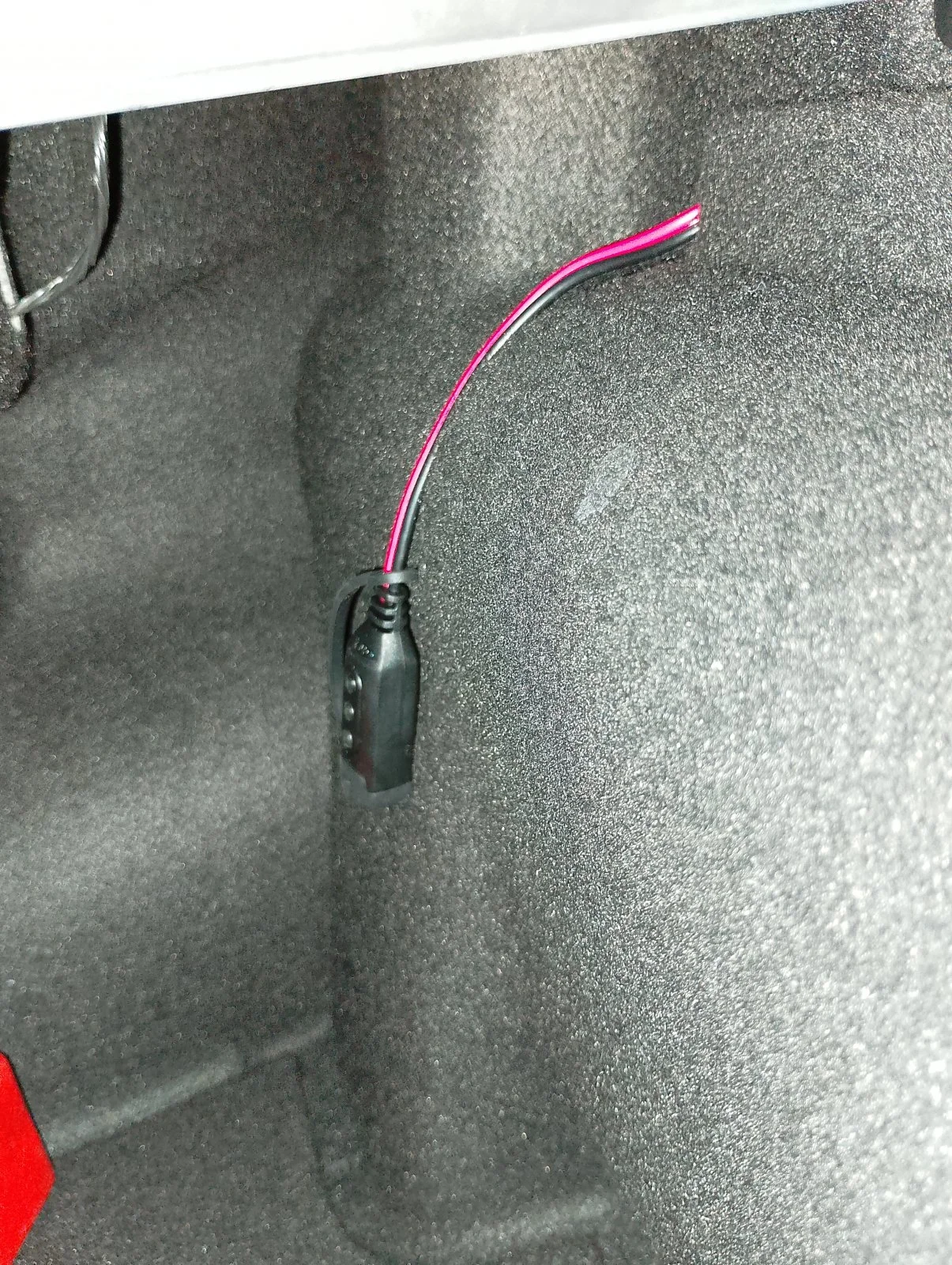

I installed the NOCO adapter at the weekend. Getting the cover off the Red terminal the most annoying aspect of it all and then trying to work out how to feed the cable out through the cover.
In the end was pretty simple, but took a good 10mins to work it out
The main cover that hides the entire battery doesnt fit too well afterwards, but its good enough

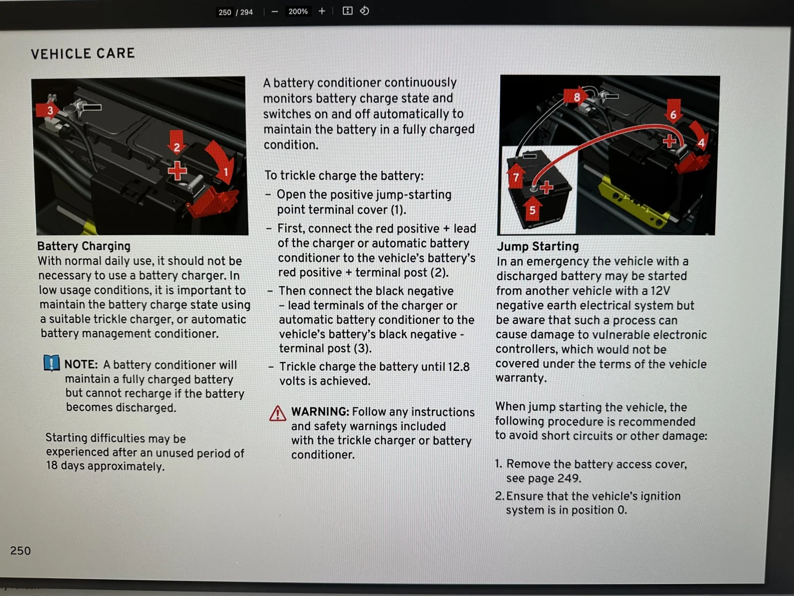

In case it helps anyone, here's a screen shot of page 250 from the Emira Owner's Handbook, indicating how to temporarily hook up a battery tender, rather than fitting "permanent connections" which looks to be the focus of this thread so far.
The downside is that the cover is now connected to the battery, right?
There is no quick disconnect for the cable?
Thanks
Marc
There is a quick disconnect via pulling the two blade connectors. Very simple.

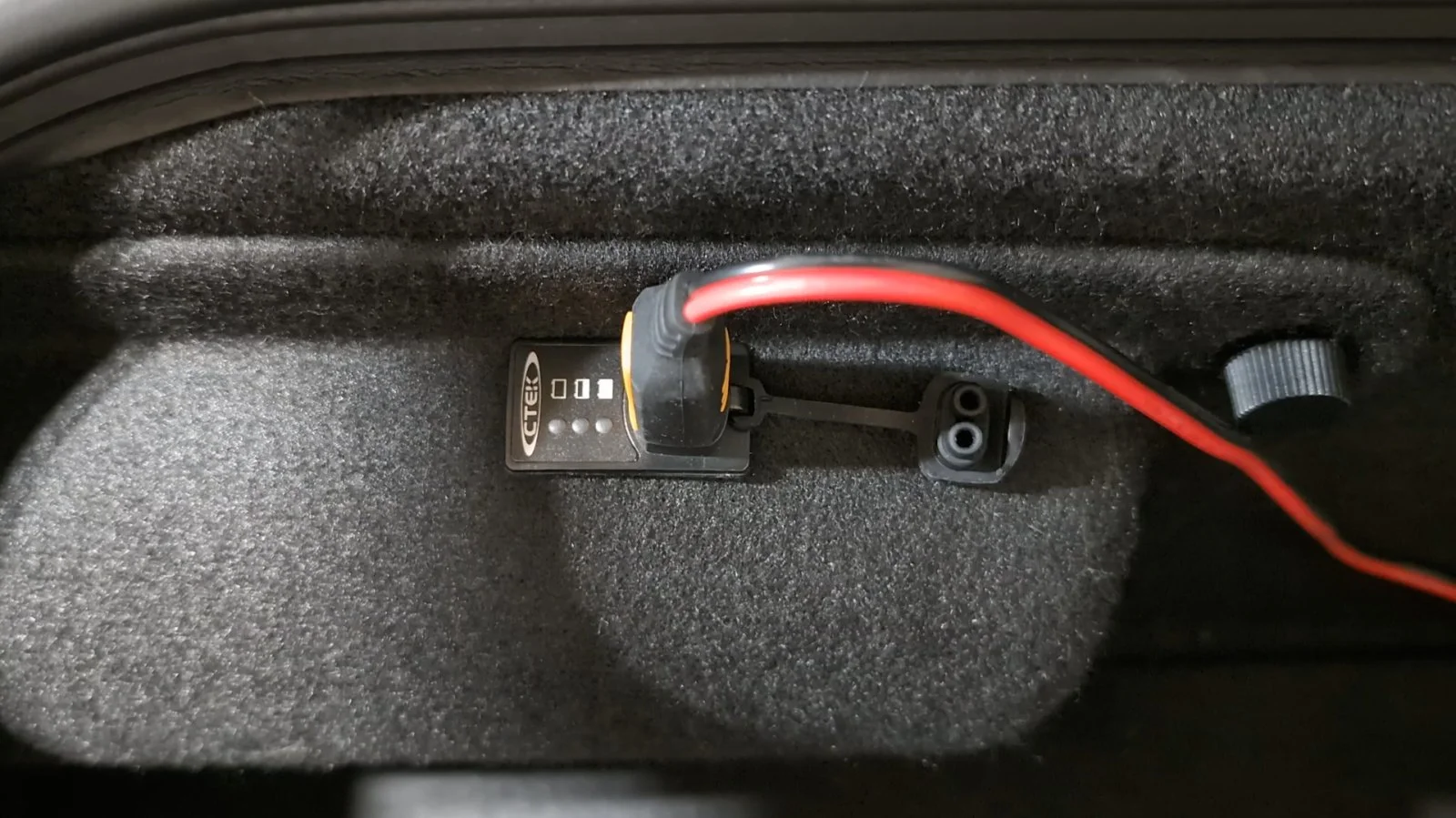

Installed the CTEK Comfort Indicator into my battery cover. Works great and not intrusive at all.
Done that last Friday; very easy install and the result is incredibly clean an neat, looks like almost OEM!
Thanks for sharing!
The only “issue” is that it shows an amber light even after only one day of parking and when I’ve installed it, it has been parked for two weeks before the job, it showed red light but….no problems at all with the battery in either cases! The car just turned on like a charm!
Weird 🤷🏼‍♂️

That is weird. Mine shows green even after not charging for a week. My battery is an antigravity lithium though. 🤷🏻‍♂️
