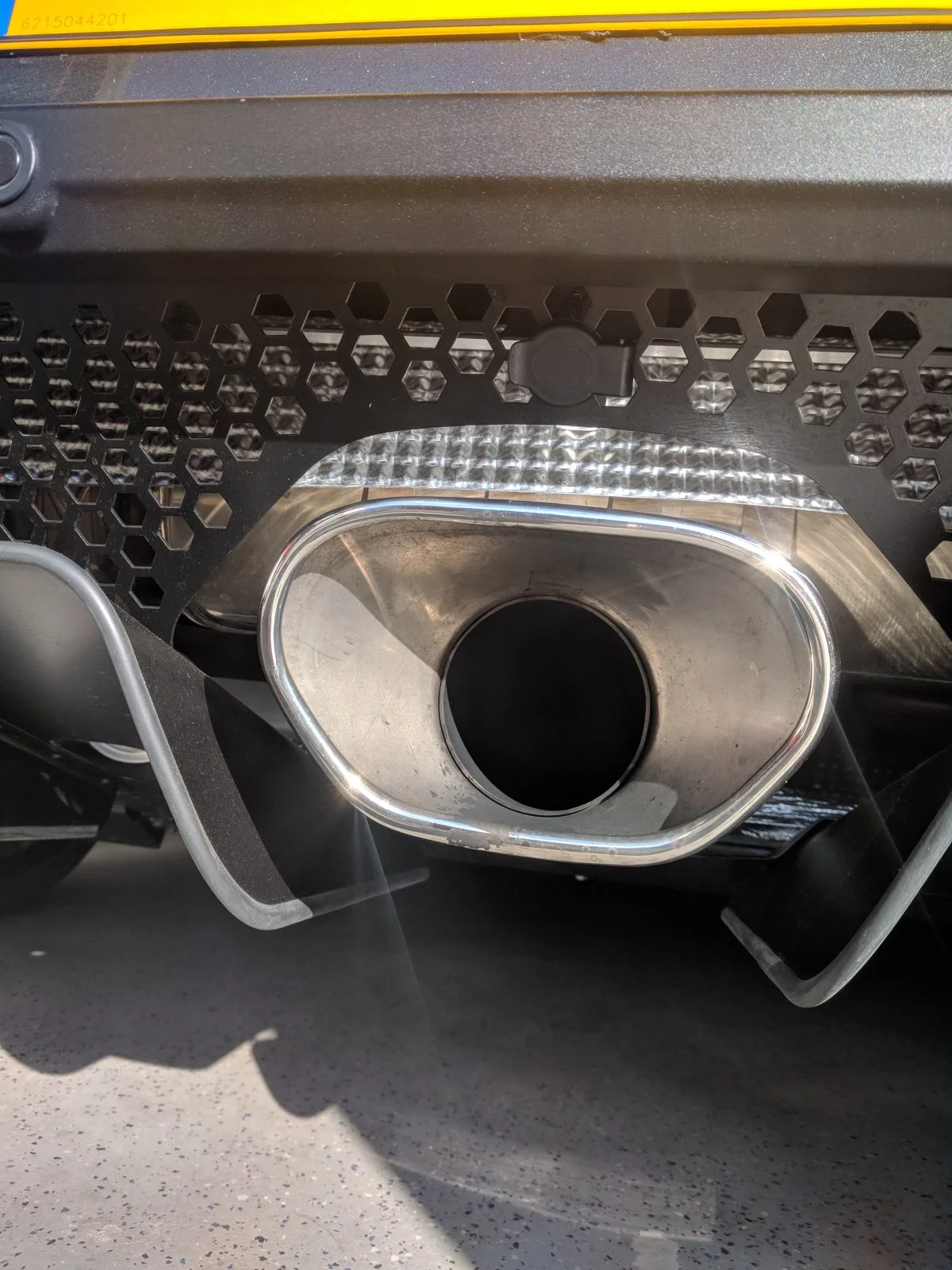

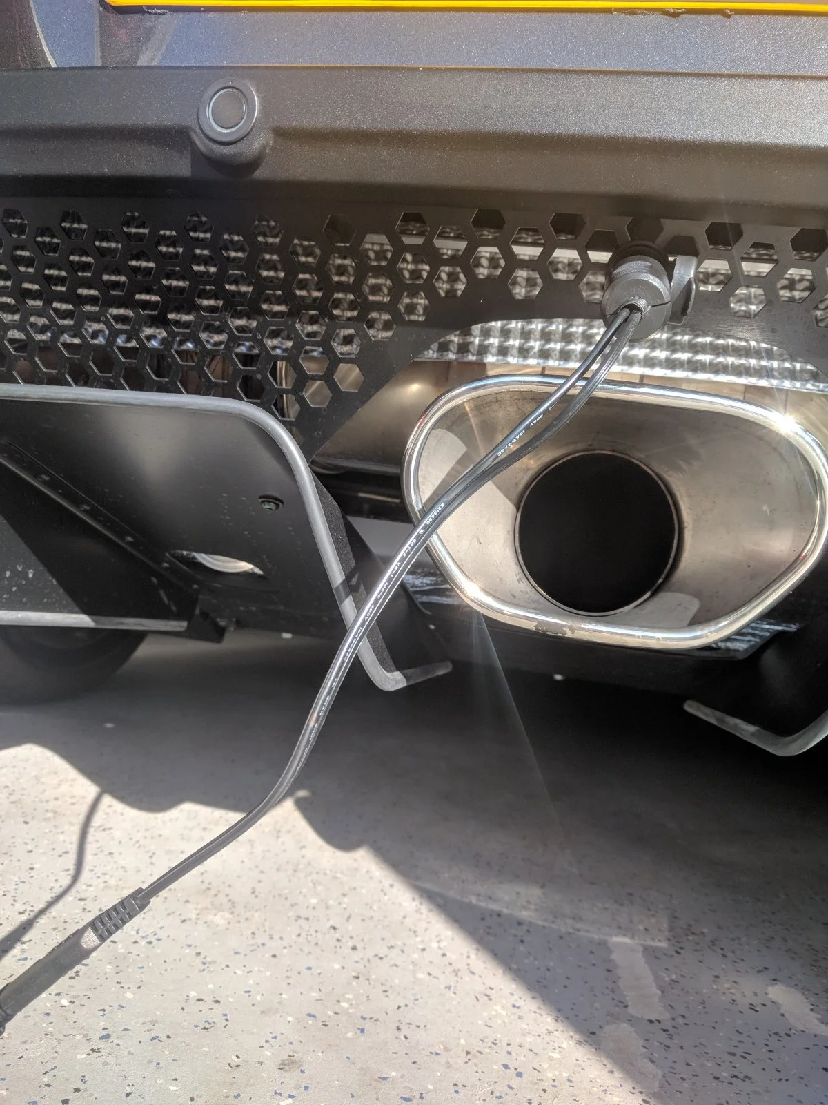

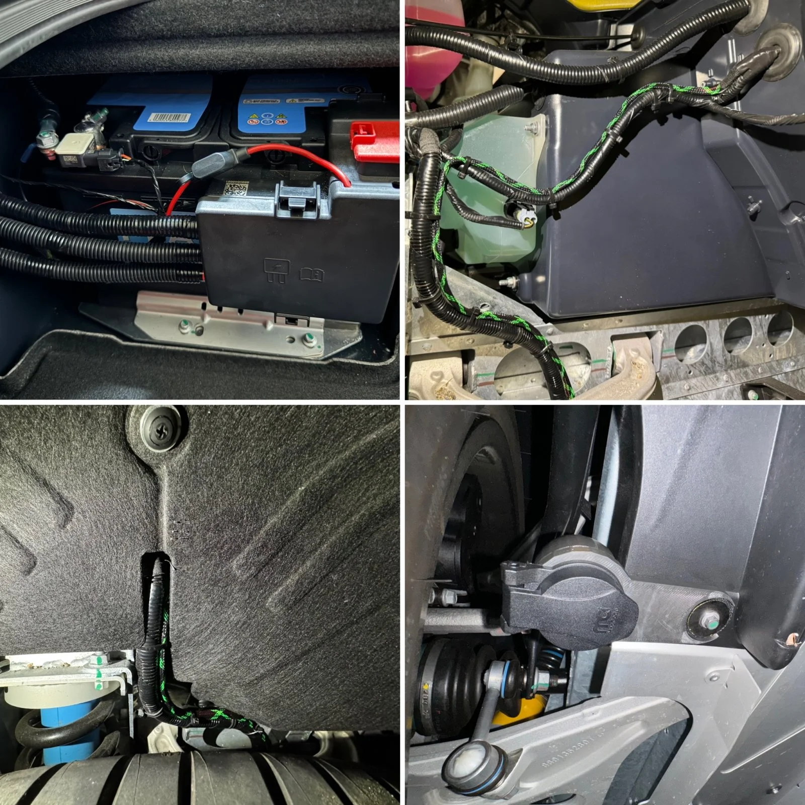

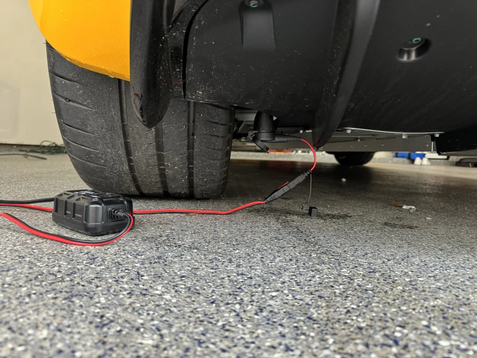

That was prob me. Here are some old pictures. I’ve since redesigned the bracket with a screw-on top so that the internals are sealed.
This is the kit I used

Just warning, I went through two of these kits with my lotus evora, and they both failed due to corrosion, same location, even though the car rarely saw rain. Ended up stranded on the highway in limp mode, so be sure to check it is charging properly. I gave up.
Never had any problem........
I did experience corrosion, I had to open the magnetic connector and clean it out to get it to work again.
That’s why I changed the design of the bracket to a screw-on top. It has a hole on the top for the cables which I then sealed with silicone. No issues since.

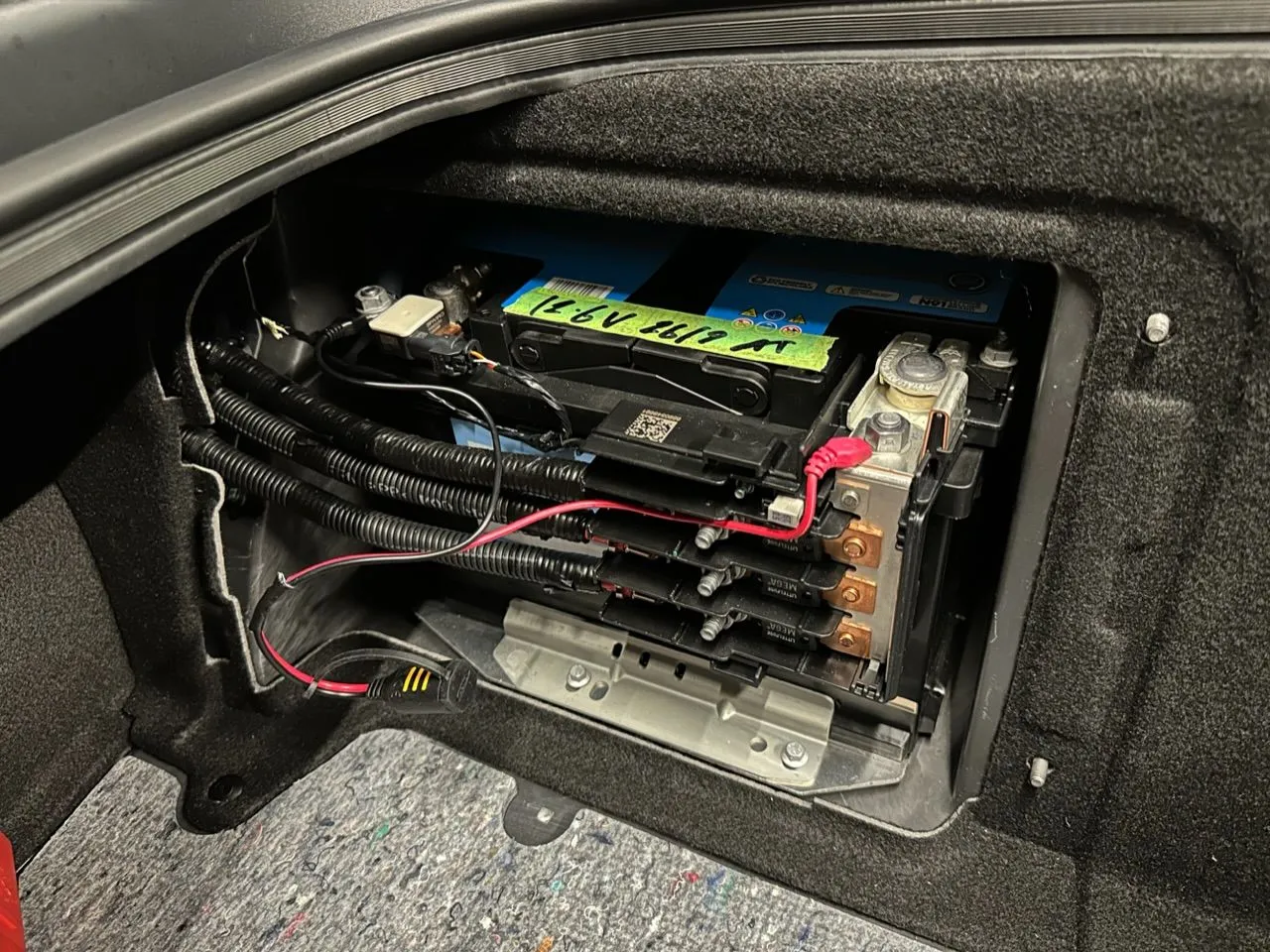

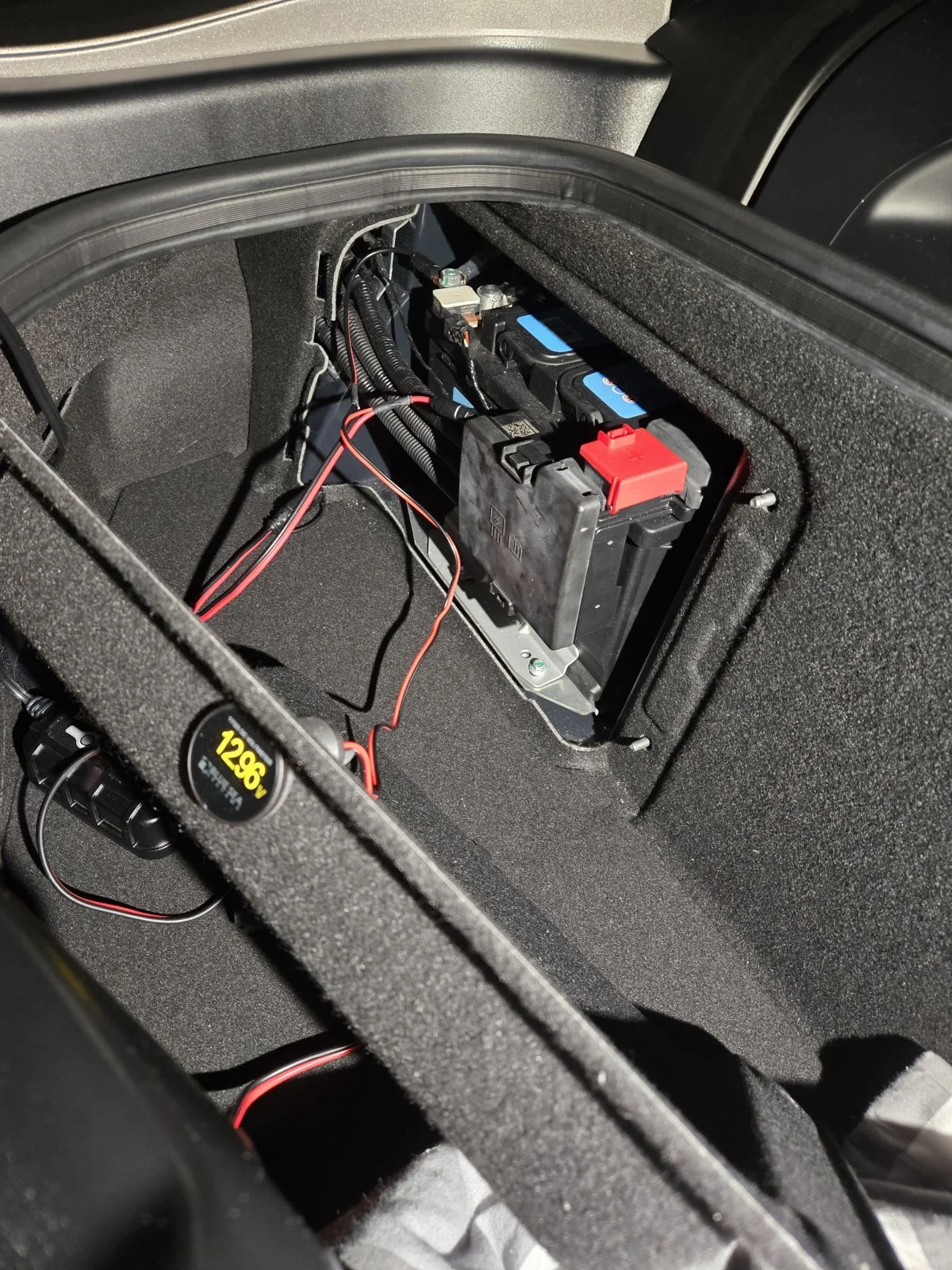

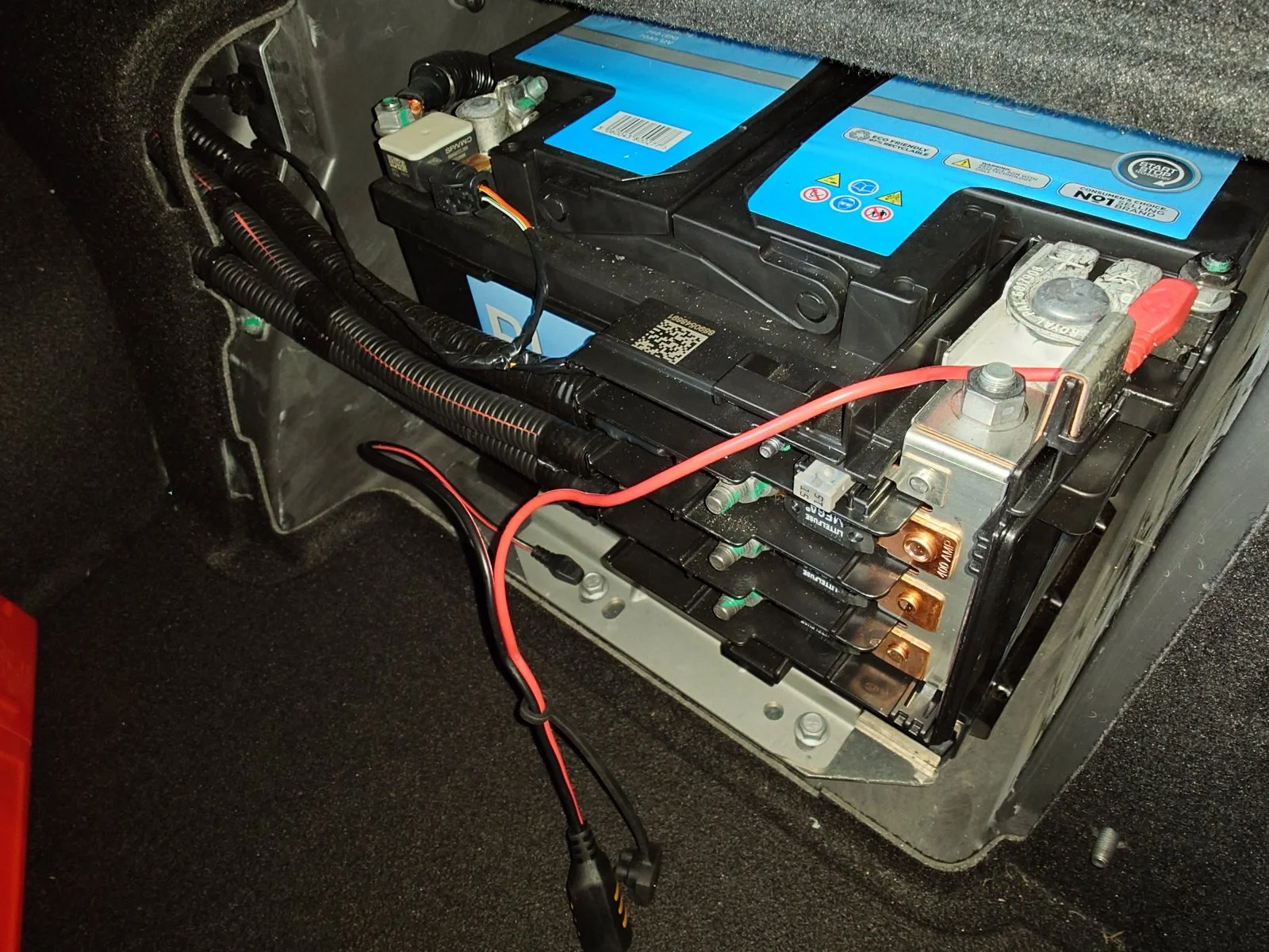

This is how I fitted mine just now. Used the ground on the battery mount and just attached another 10mm nut on top of the existing exposed positive. No battery disconnect required.

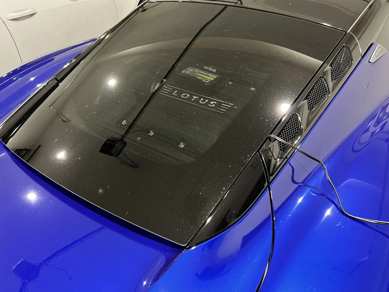

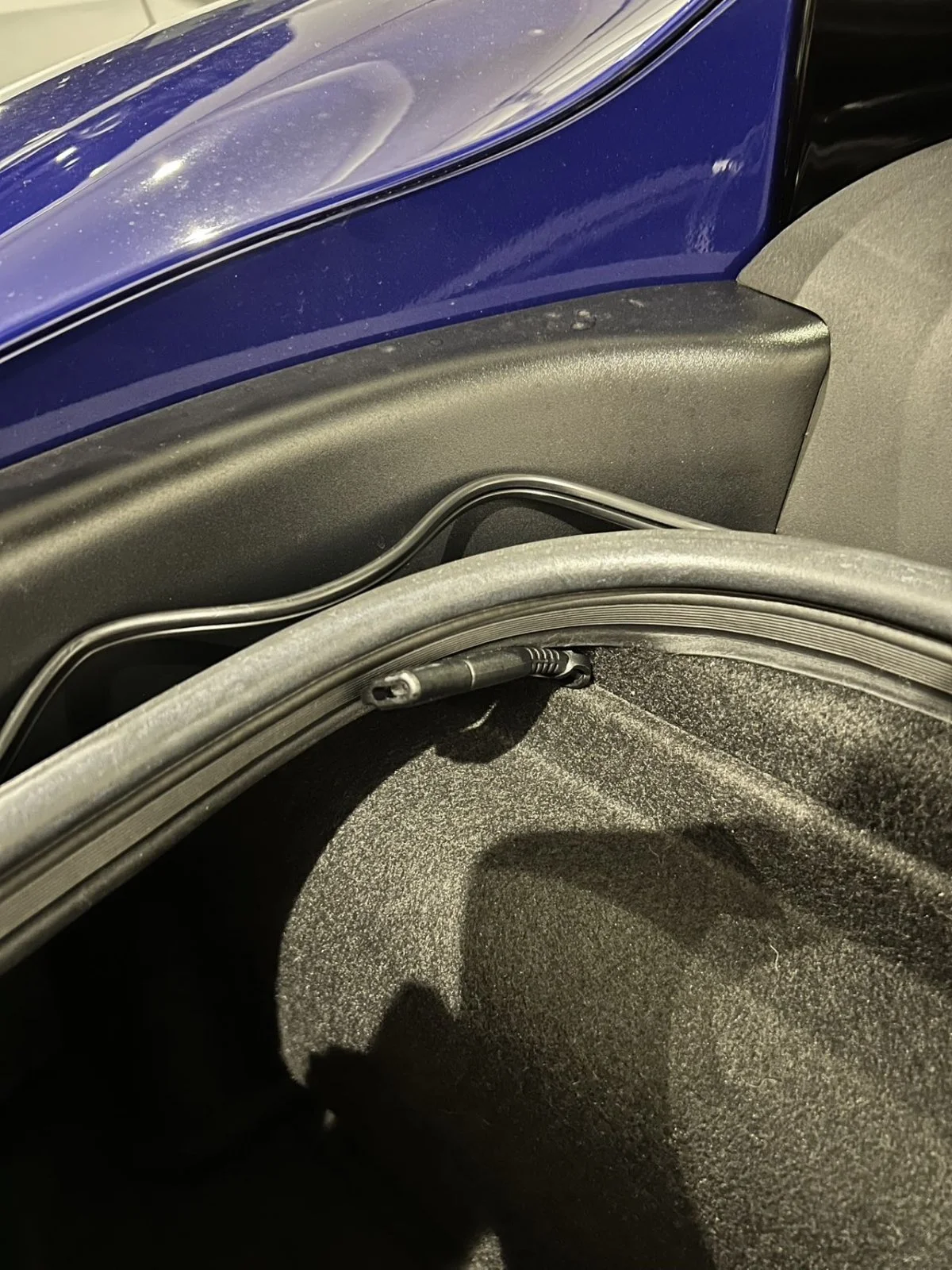

The simple solution to this is running the battery charger cable under the rear deck lid (glass) where it vents for the engine hot air (you know, where the water goes when you wash the car) -- then you can close your trunk without worry.
Just hooked up the Lotus supplied battery tender. I connected the eyelets to the battery nuts, and Dremelled a little cutout on the battery cover to run the wire. I didn't fully close the trunk just to be easy on the trunk rubber seal.

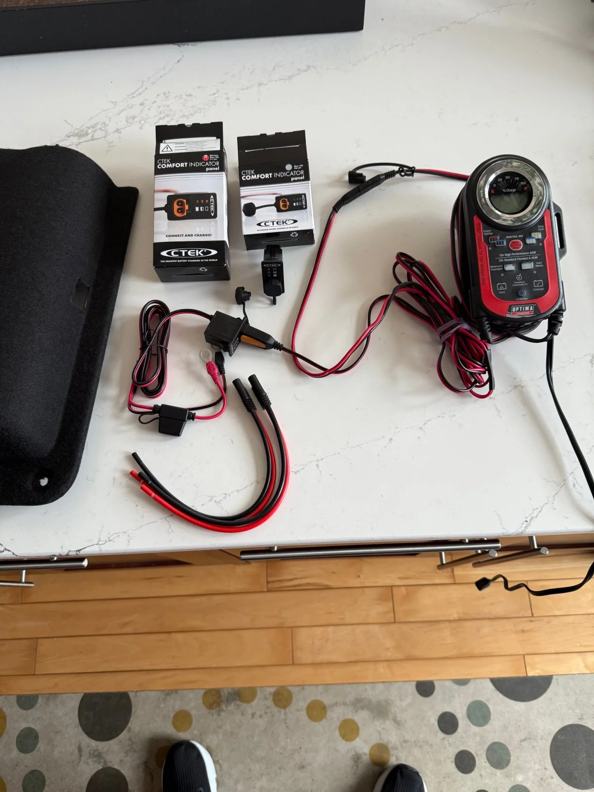

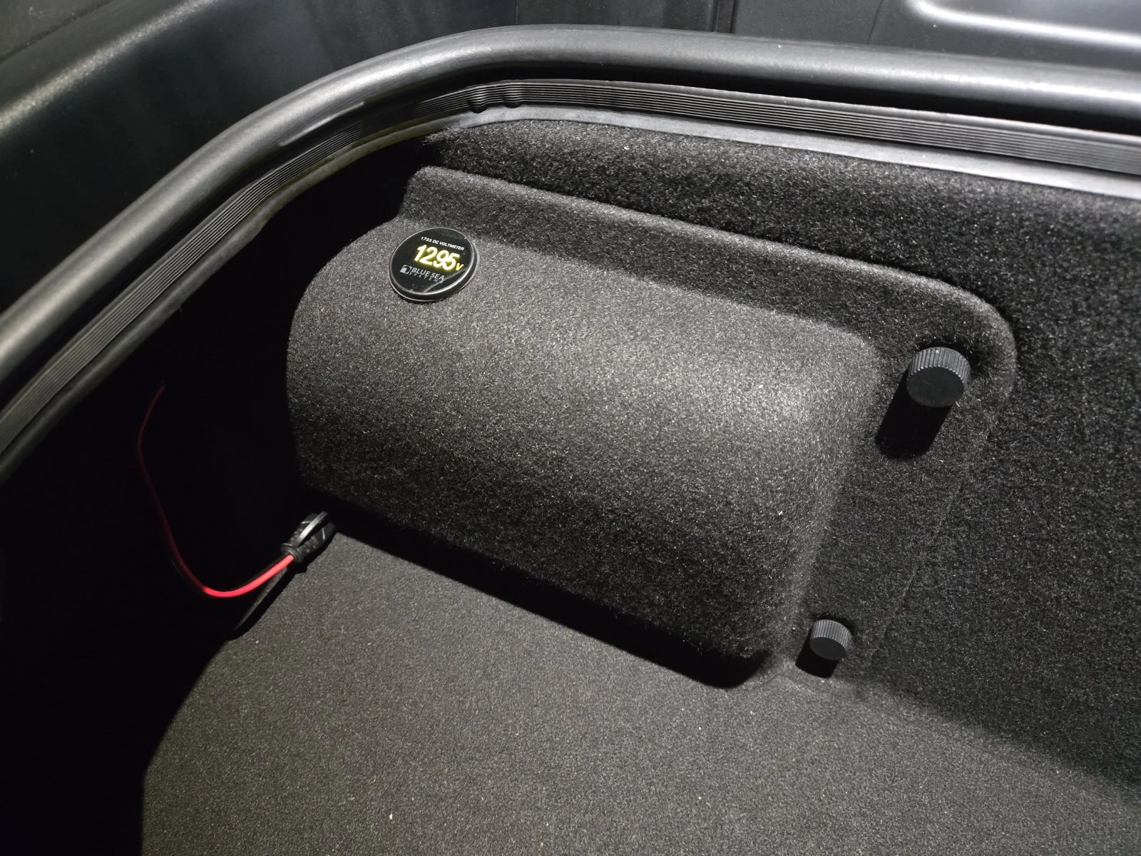

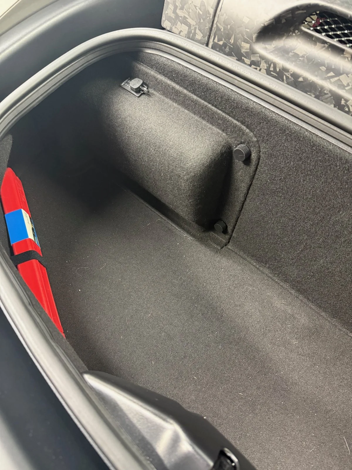

I also wanted to install the CTEK Comfort Indicator Panel for a nice flush look with some added functionality, but I currently use an Optimum battery charger which has the same SAE connections as the Lotus supplied Battery Tender. I decided to use my rusty soldering skills to Frankenstein an adapter cable to connect the Optimum (or Battery Tender) charger to the CTEK Comfort Indicator. I purchased a CTEK extension cable to make the new adapter cable which also allows me not to have to use an extension cord to plug the whole thing in. There are two versions of the CTEK Comfort Indicator Panel, one has a 3-foot fused lead and the other has no leads and spades used to attach this to your own custom harness. I ordered both and decided to add an SAE quick disconnect to the model that has leads. Either model would work but you do need to take into consideration where the wires would exit each version based on where you want to place the panel.
I really like how it turned out; it does appear OEM and I’m hoping the Comfort Indicator adds some real function. Much batter than that dongle laying in the trunk before.
@Pdl2thmdl, this may answer your question as this works but will require an adapter cable.
Pics of the battery charger connections for reference if anyone needs to know how there’s will fit…

This just has spades on the back. I soldered the wires on and tapped into the pigtail for the NOCO battery charger I installed.
I really like 1) the precision of this voltmeter, 2) the low current draw due to the OLED display, and 3) the readability of the display in all light conditions.
