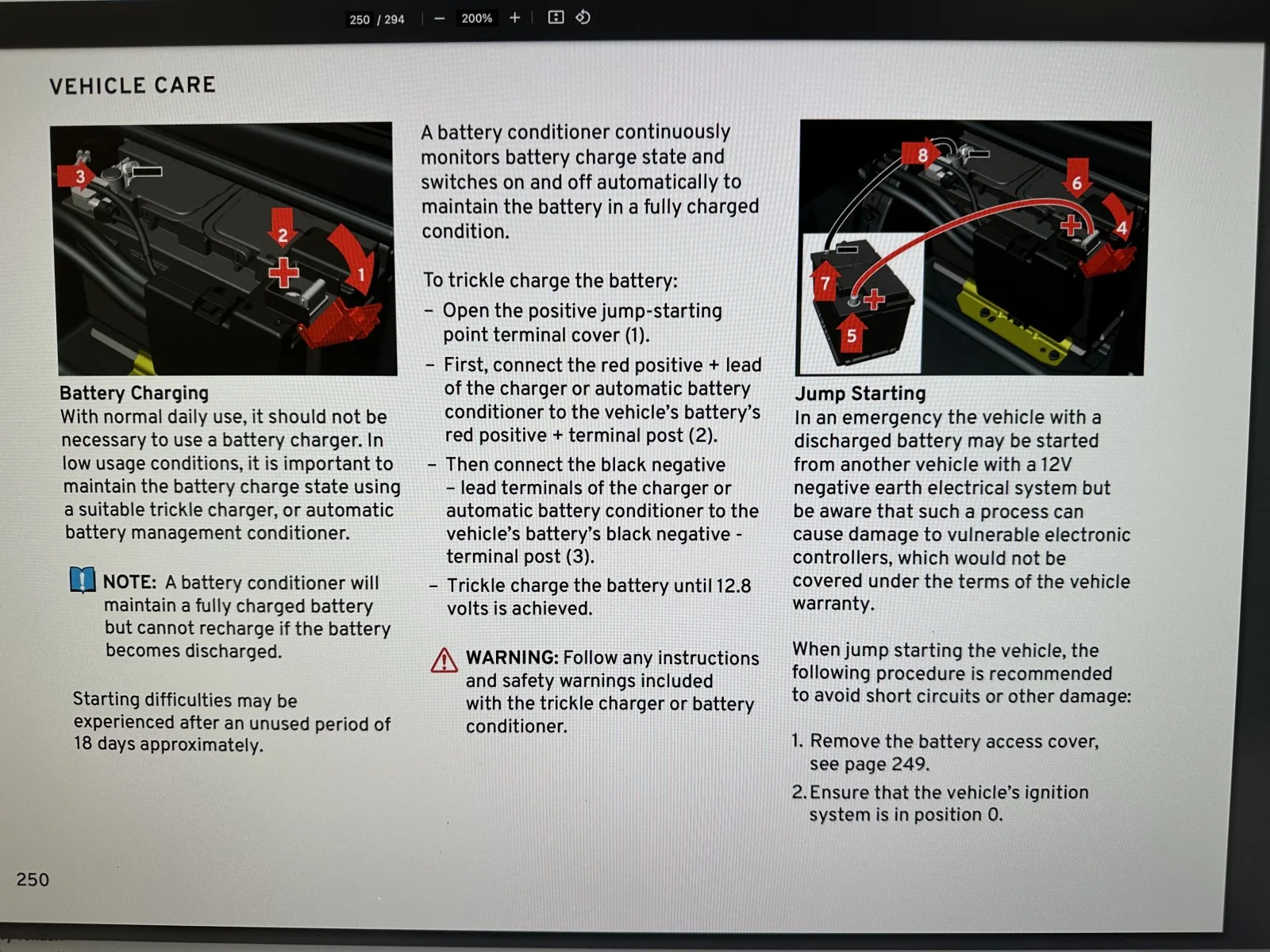

In case it helps anyone, here's a screen shot of page 250 from the Emira Owner's Handbook, indicating how to temporarily hook up a battery tender, rather than fitting "permanent connections" which looks to be the focus of this thread so far.
Thanks for this. I'm not sure why everyone is so happy to put in the extra work to wire up a quick disconnect when I can just open up the cover, clip, clip, and I'm done. Maybe I'm just lazier than most. But I'm also someone who is out of the city every 2 weeks, so I'd be doing this once a month.
Also, what is the benefit of using the CTEK specific extension cord rather than a regular old extension cord from the wall outlet to the car?

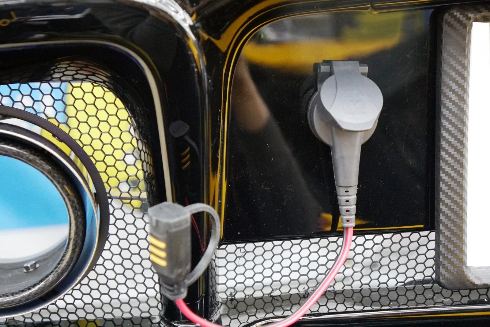

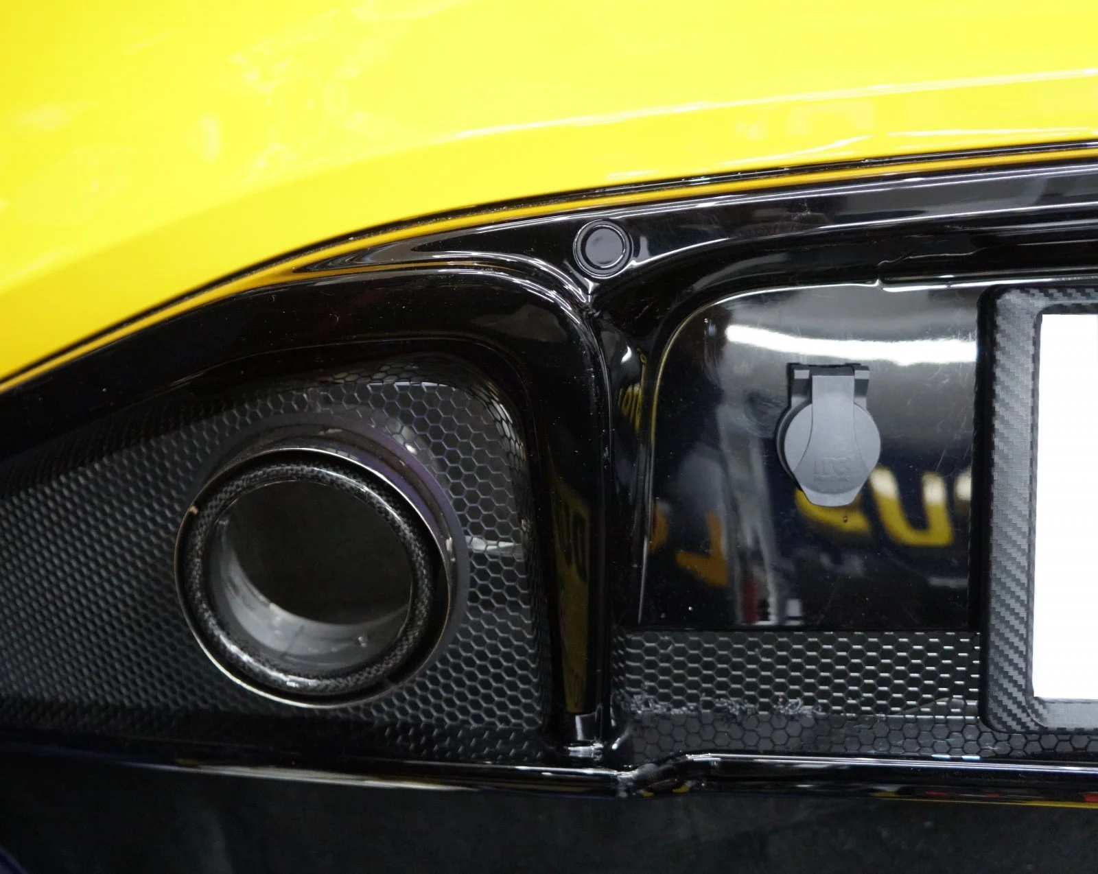

Since it's convenient, I installed the CTEK "Battery Charger Connection Kit" on the rear bumper myself.
I looked for a more inconspicuous place to install it, but I couldn't find a good place even if I removed the rear bumper.
I ended up installing it in this position.
It was less noticeable than I worried.
So far, there have been no problems driving in the rain.

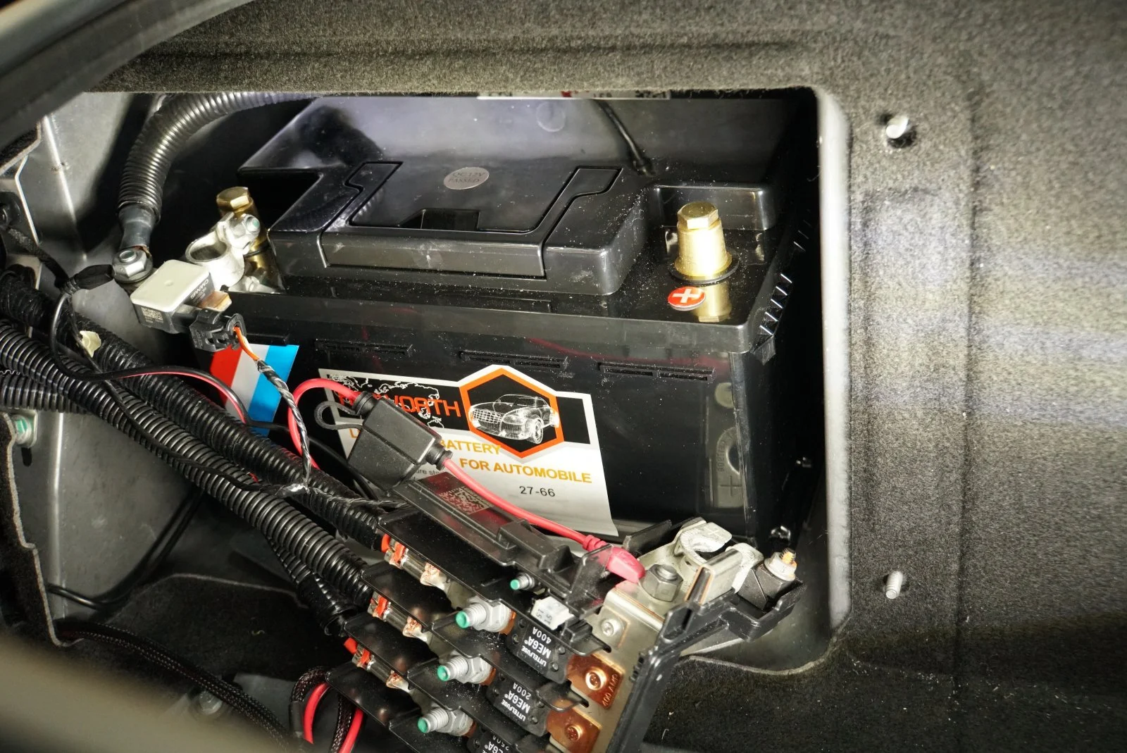

At the same time, I replaced the battery with a "LiFePO4" battery.

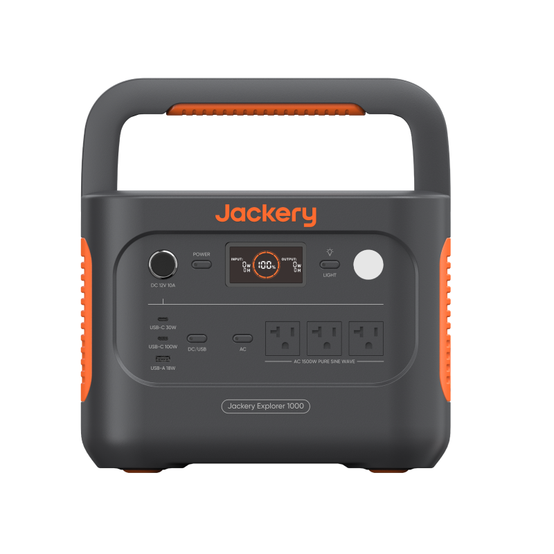

I use a 1KW/Hr Portable Power Station that fits in the trunk to power the trickle charger
If using Jackery suggest get the newer LiFePO4 versions for longer lifespan and lower operating temperature.
Jackery product defaults to turning off after 12 hours or less than 25w draw,
disable the automatic shutoff by pressing and holding both the Power and AC buttons simultaneously for a couple of seconds.
Nice solution.........congratulations.........!
That Lifepo4 Kepworth Battery you have installed really fits very well !
Question: ......as far as I can see it is the "type 27-66" 42Ah / 1300CCA version of Kepworth........the weight however is 8kg which seems a little "heavy" for a lifepo4 battery..
(BTW my '21 Evora GT 410 Sport is OEM/standard equipped with a 25Ah / 1045 CCA Lifepo4 "SuperB" starter battery / 4,3 kg.......very, very expensive; approx $1500,-)
Have you considered a lower Ah lifepo4 battery as the 20 Ah / 680-720 CCA / 3,3 kg from Kepworth, which would also be sufficiently suitable for your Emira at normal conditions ?
Regards, Ruud
Regards, Ruud
Hi Ruud.
It's true that the 42Ah battery is heavier than the 20Ah.
I don't do circuit so I don't really care about weight reduction.
However, the weight of the 42Ah Lifepo4 battery is about half that of the EMIRA OEM battery.
The reason I chose the Kepworth 42Ah is that it has almost the same dimensions as the OME battery and I chose the lightest battery among them.
So I didn't consider the "20Ah / 680-720 CCA / 3.3kg".
I bought a "type 27-66" 42Ah / 1300CCA" battery on Alibaba for USD218.00 including shipping to Japan.
