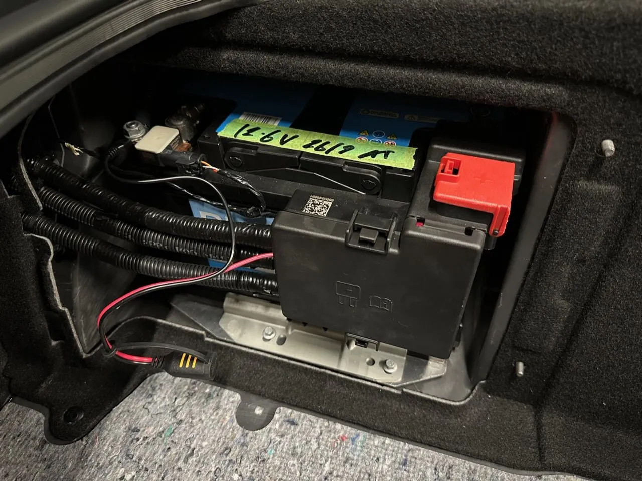

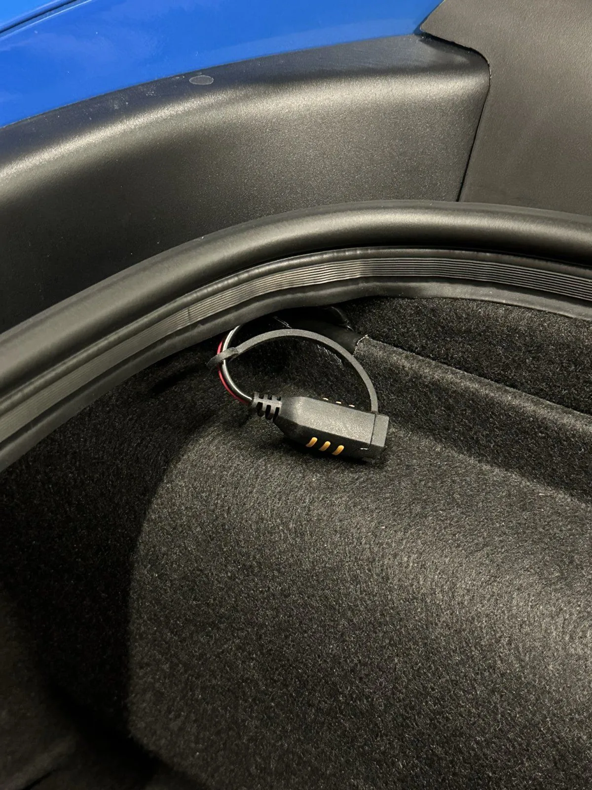

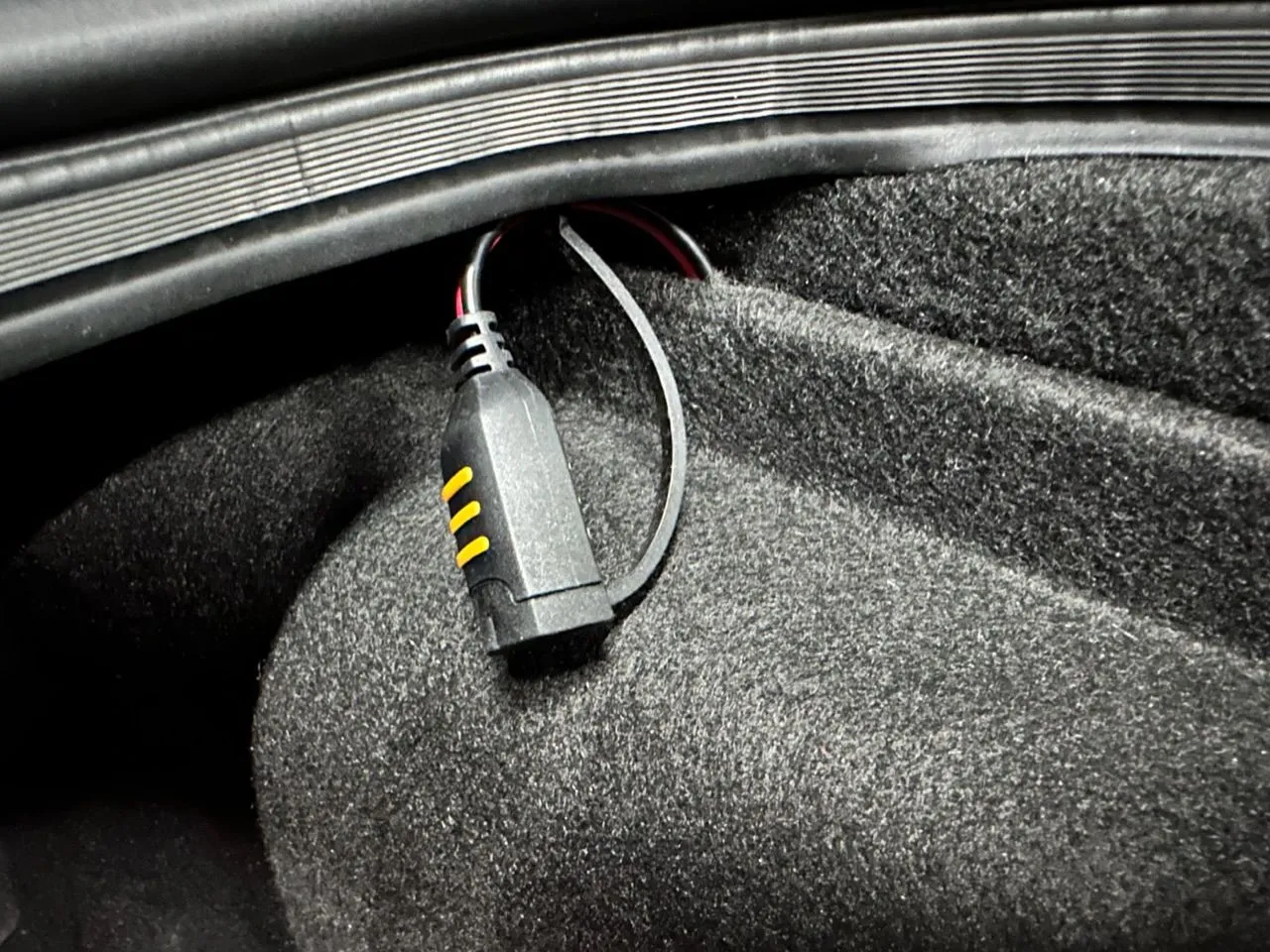

I fitted a CTEK battery charger today . It needed M8 sized connectors to connect to the battery - which i had. I added some additional duct tape to the cable and the shroud just in case there is any rubbing. I will probably cut a very small neat recess in the shroud with my Dremel later on for a neater finish.
The charger lights up perfectly and all looks to be working perfectly.... one problem, after installation an error light has been thrown up on the dash saying "12V Battery needs service".
I'm thinking this is due to me disconnecting the battery as i fitted the connectors. Does anyone have experience with this on other Lotus's? I'm hoping that it will clear itself after a while... could I use an ODB reader to clear the code? Does an Emira even have this port? If so any idea where?

On the Evora, if you disconnected the battery too soon after turning off the ignition then it would confuse the ECU and throw an airbag warning light when you re-connected. The ECU needs time to settle after the ignition is turned off, so the car needs to be left for 15-30 minutes before disconnecting the battery. It needed the right type of ODB reader or a visit to the dealer to reset the airbag light.
This issue sounds like it could be similar.

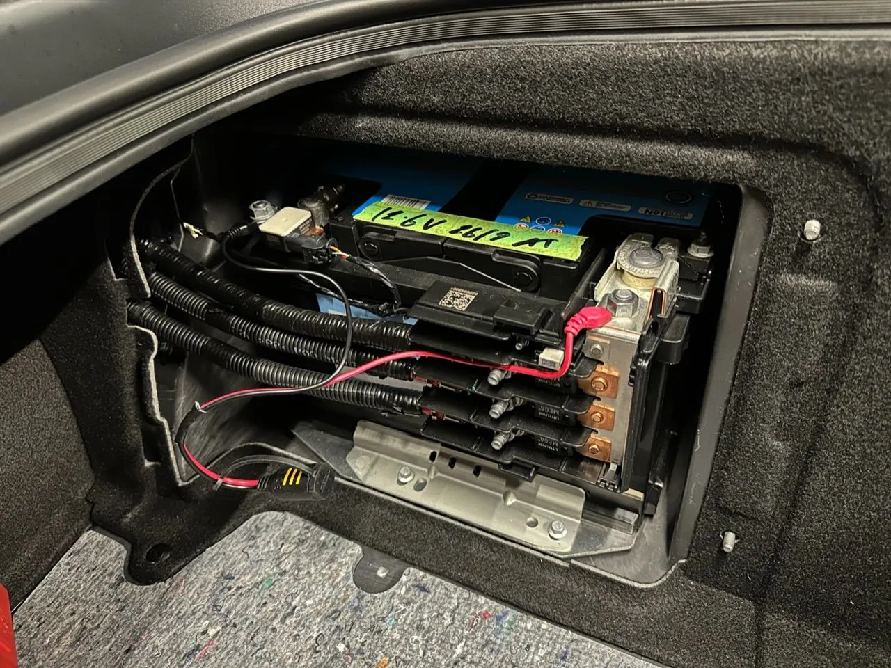

Pics of the battery charger connections for reference if anyone needs to know how there’s will fit…

Thanks @Jimblob. Useful pictures. Not seen a bus bar on a battery like that before.
Did the nuts come off cleanly or were they semi-captive (ie not designed to easily come off?
Did you fully disconnect the battery when doing this?
The unit attached to the earth looks like the one on my Jaguar which I think is the battery condition sensor. It tells me if the battery is low. Perhaps that got disconnected and that’s what is throwing the error code?
IIRC the Jaguar guys told me to try and avoid disconnecting this when I fitted the CTEK fly lead but if I did the error code would clear itself after a number of start stops (once the system had enough clean starts). When I fitted the fly lead I popped the nut off but kept pressure on the leads so everything else is was still connected as I did it. No issue.
Not sure my Evora was as intelligent as that and I don’t recall the battery having all that extra hardware attached when I attached the fly lead.
I fully disconnected the negative terminal first - I thought that was good practise (maybe not though!).
The reason I did that was that I wanted to connect the negative terminal to the actual negative battery terminal.
I tried to do that but the bolt that clamps onto the terminal is captive at both ends so I had nowhere to put my circular connector. That’s why I connected to the bolt where I did…
I was aware that there was “something” between that and the negative terminal - I guess that’s the conditioning serape you mention.
