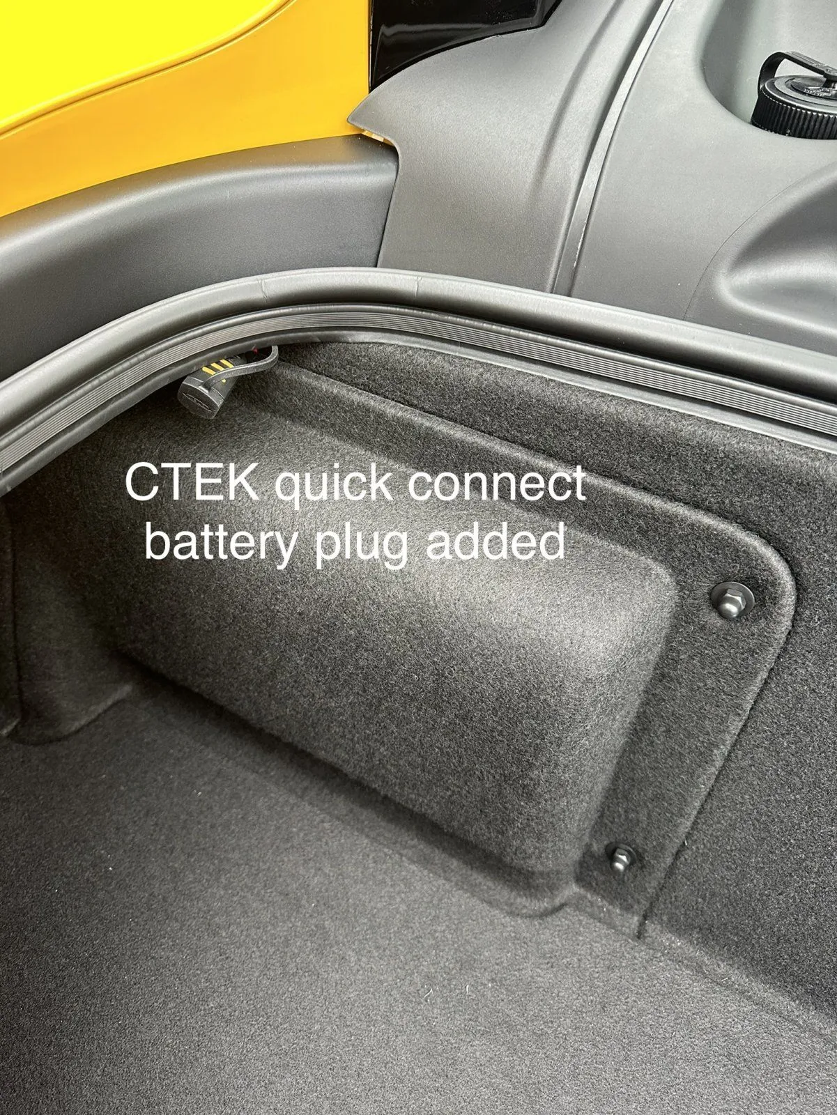

Hi Jimblob, glad to hear that you resolved the issues. Which model of the CTEK chargers did you use and does the cable fit ok past the boot seal?
Not sure the model - it’s branded Porsche from a previous car. The cable goes past boot seal perfectly and I can still move it slightly meaning it’s not being pinched at all.

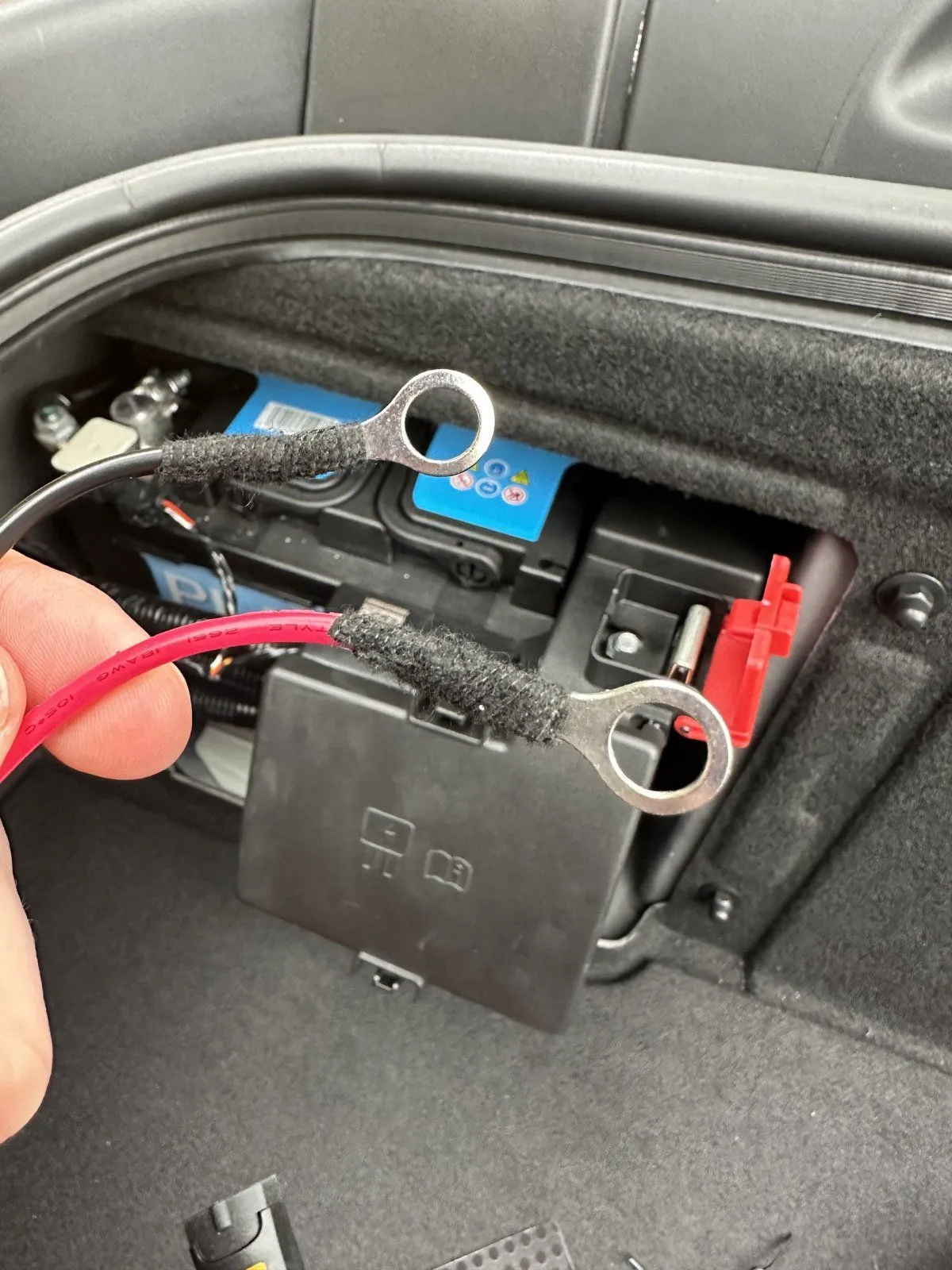

I feel like I'm making a sequel of single white female called magma red emira....I also have a ctek awaiting new duties - M6 eyelets (IIRC from another thread) so £6.99 off ebay?
I used 8mm and the one with the traffic lights on the connector so you get a quick visual of the battery condition. Turns out the tracker also gives the battery voltage. Not sure 6mm would fit on the +ve stud I used.
I bought the M6 being lazy but a quick snip and crimp with a dive into the odds and sods box and I had new connectors on the end. But yeah don’t by the 6mm one.

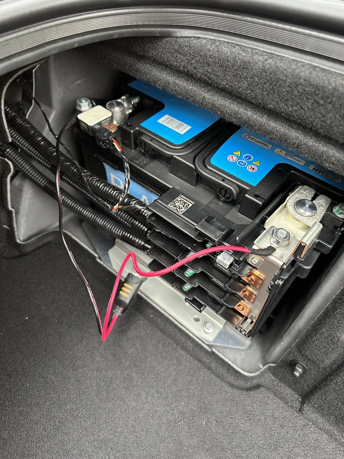

Make sure you wait at least 30 minutes after the car was last turned on before doing this. (I did and had zero errors/warning lights come on) Always disconnect positive first Owners manual asks for negative (black) to be disconnected first and is reconnected last. I didn’t even disrupt the circuit to be honest and the quick connector isn’t a complete circuit as long as it’s not got anything plugged into it.

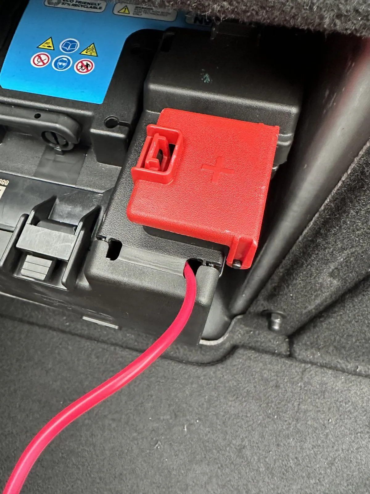

There is a nice gap when the cover goes on for the positive wire to poke through.
The finished position of the wire has to poke out on the left hand side of the boot cover case otherwise the hand tight black nuts won’t go back on if you’re too far to the right.
is
Good point about waiting for 30 mins after switching everything off. However in the end I didn’t disconnect the battery at all. I went on the the nut on the positive side, same as you and for the earth went onto one of the bolts on the bracket at the bottom that secures the battery down. I checked for continuity first to make sure it was a good earth. At the end of the day with the covers back on mine pokes out just the same as yours.
