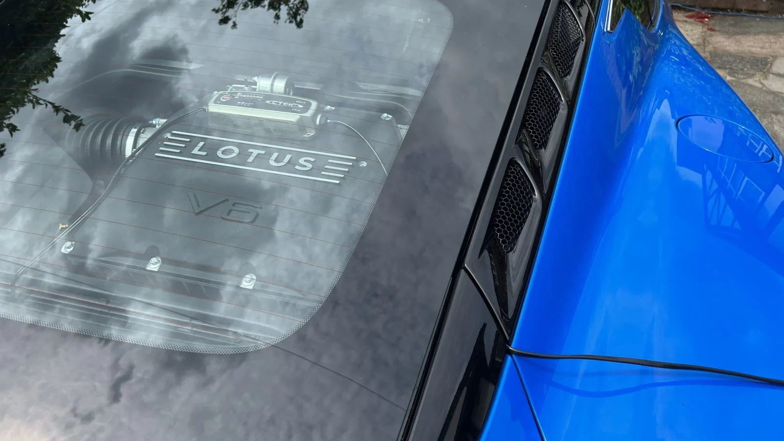

I sit my ctek on the engine window and run the cable under the window (where the water drains) then into boot. Means I am not stressing the boot seals/lock.

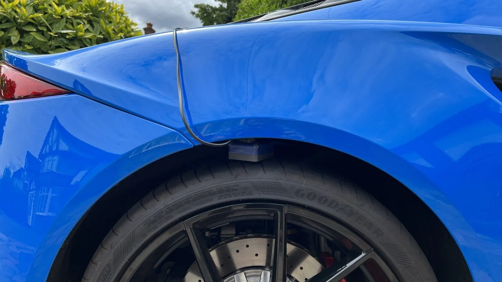

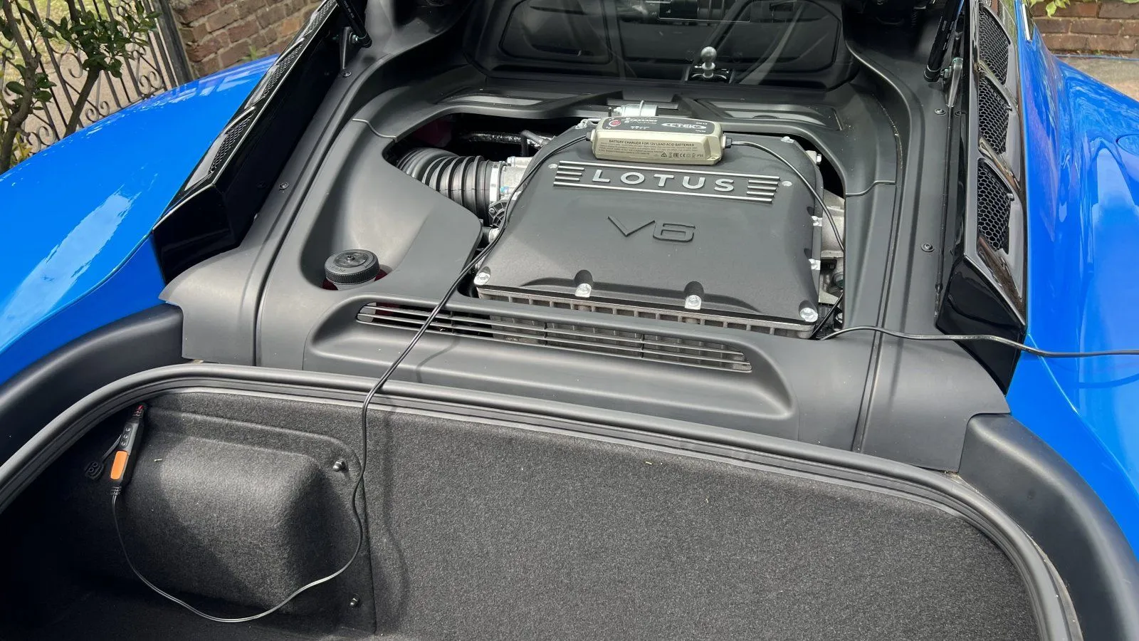

My car lives outside and here’s how I wire up the ctek:
Put the unit on top of the supercharger.
Two advantages:
You can see the state of charge without unlocking the car.
As it’s a vented area heat from the ctek isn’t an issue. It does get warm. On a frosty morning there’s a de-iced area in the glass above it.
The mains cable comes out at the cross of the panels where there’s a little more room.
My extension cable is too thick to go through that gap so I put the socket on top of the tyre where it’s out of the wind and rain.
Then the extension cable can be run to however far away the power source is.
Might be a solution for anyone like me who has to park outside.
