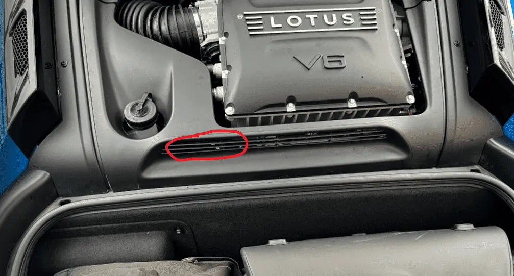

Question for those who have looked around their Emira Battery/Engine compartment.....
When routing the Battery Tender cable from the battery, rather than going thru the Battery Cover and into the boot, like this;
or this....
Can you route the battery tender cable towards the engine compartment and out thru the vents in the plastic engine cover (red circle);
Seems like there would be a path and it would eliminate the cable pinching the boot weather seal when the hatch is closed and charger in use.
or this....
Thanks for your input and thoughts!
I wouldn’t do that, in that position it is exposed to the outside conditions whereas in the boot is proctected
OK, yet is it really exposed to "outside conditions" under the hatch? It's the same as being under the bonnet (hood) of a front engine cars, isn't it? Actually a little less "outside conditions" than a front engine car with the battery adjacent to the engine radiator........

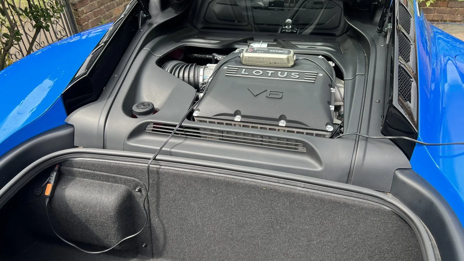

The cable does not pinch.
There’s plenty of give in the rubber seal.
Good to hear, yet the concern is that the rubber seal will hold the pinched shape of the cable being closed on for long storage periods, like 4-5 months storage over the winter.

I've used a similar arrangement for my 2011 Evora for 11 years with the CTEK cable running across the boot seal and had no noticeable impact on the rubber seal or the CTEK cable. The car is on the CTEK all the time it isn't being driven, including periods of 3-5 months storage.

in front of that grille the boot is open, it is the small space between the rear glass and the rear of the car, that’s why I wouldn’t do it, on another hand TomE did something similar with no issues at all so I’m sure it might work but….just not my cup of tea 😅

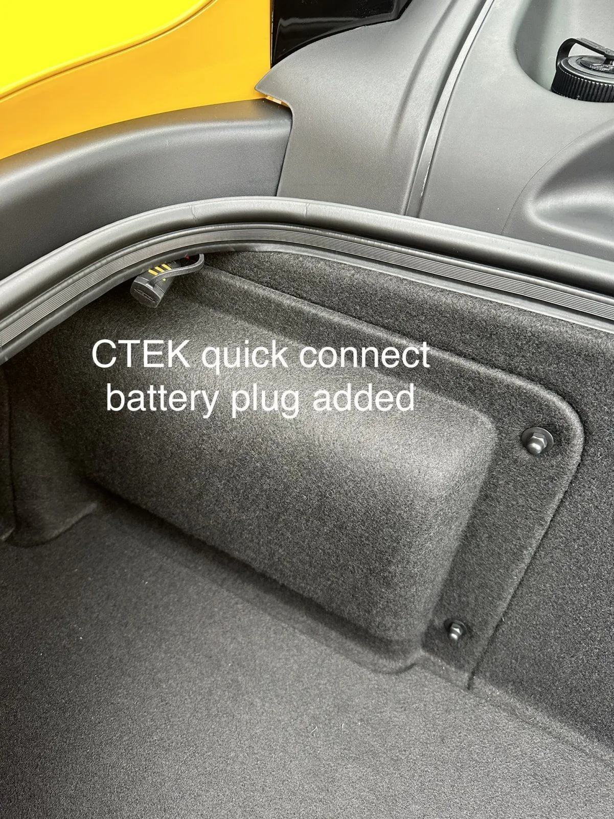

I had Lotus Melbourne install the Comfort Plug in the battery cover before delivery. First time they’ve done it, and they’ll be recommending it from now on. A very neat solution.
@DJS is right — the plug tends to go amber quite often. I’ll then connect the charger and it will show three amber lights. Eventually it will show a green. I doubt the battery is really discharging this fast… more likely the voltage interrogation is erring on the low side.

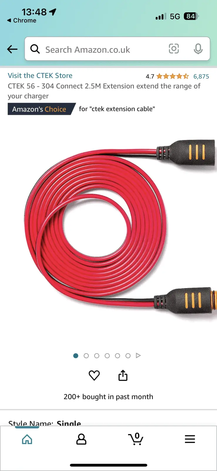

Lastly, you must also buy the 2.5m CTek extension cable. Otherwise the charger hangs out of the boot and sits on the bodywork.
