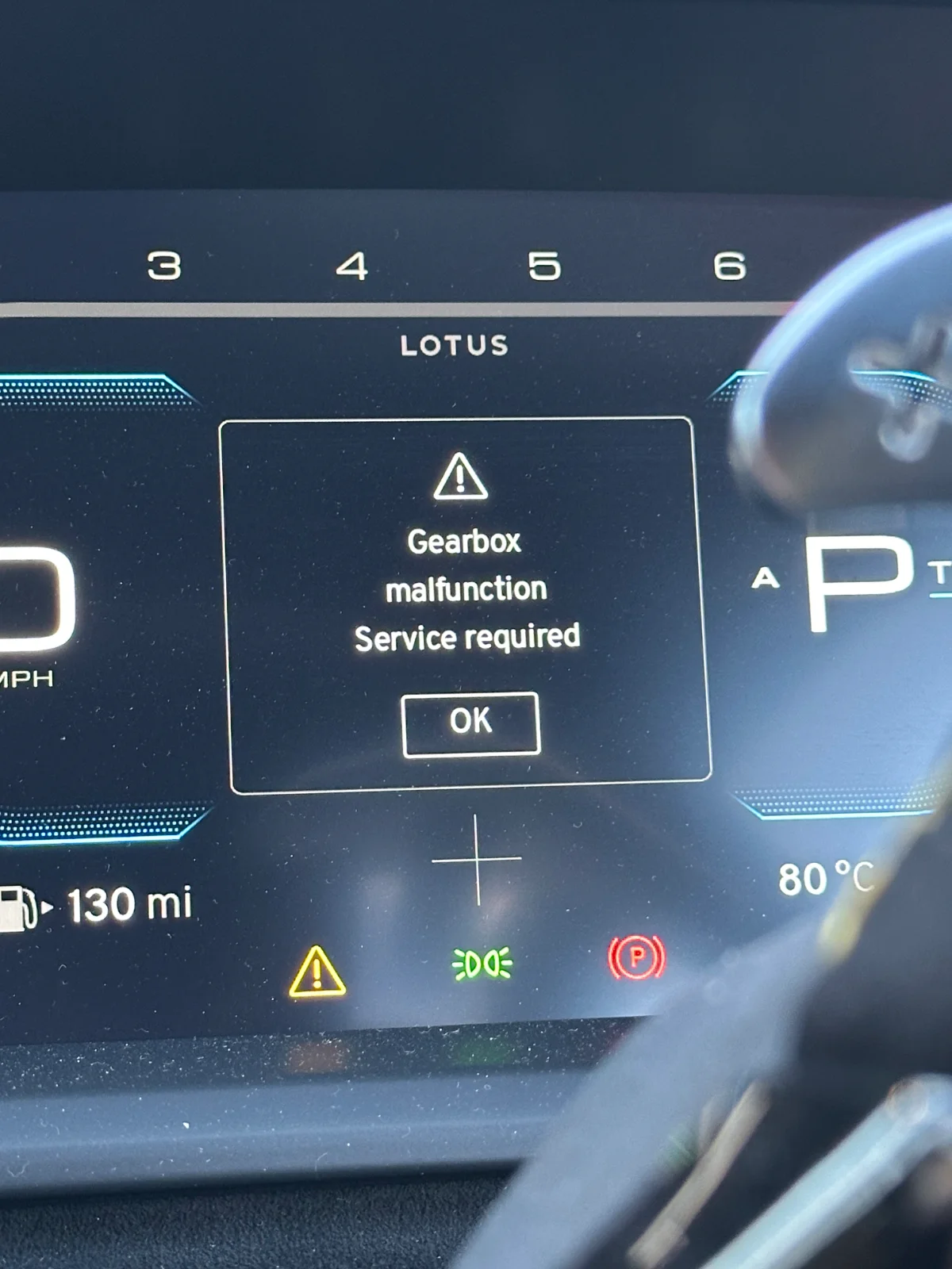

Gearbox malfunction service required message appeared today in my Emira V6 Auto. 1,700 miles 2024 model. Message still after engine restart. I have booked into HR Owen Stockport this week. Will post results once it’s been checked.

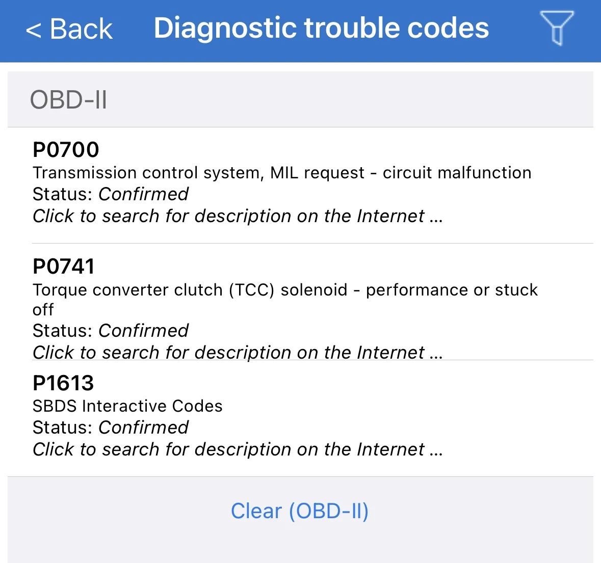

Was on the M4 today when it dropped out of 6th gear into 5th and engine warning light and gearbox error came up again and then couldn’t get it out of 5th gear, either up or down a gear via paddles. (It’s the autobox V6). When I came off the motorway and got down to 20mph it was then throwing a wobbly flipping between 5th and 3rd gear on the screen.
When I started it up again it seemed ok, and had to drive to get home anyway, which it did with no issues.
It’s showing the below codes, p0700 p0741 and p1613
Anyone had anything similar?
