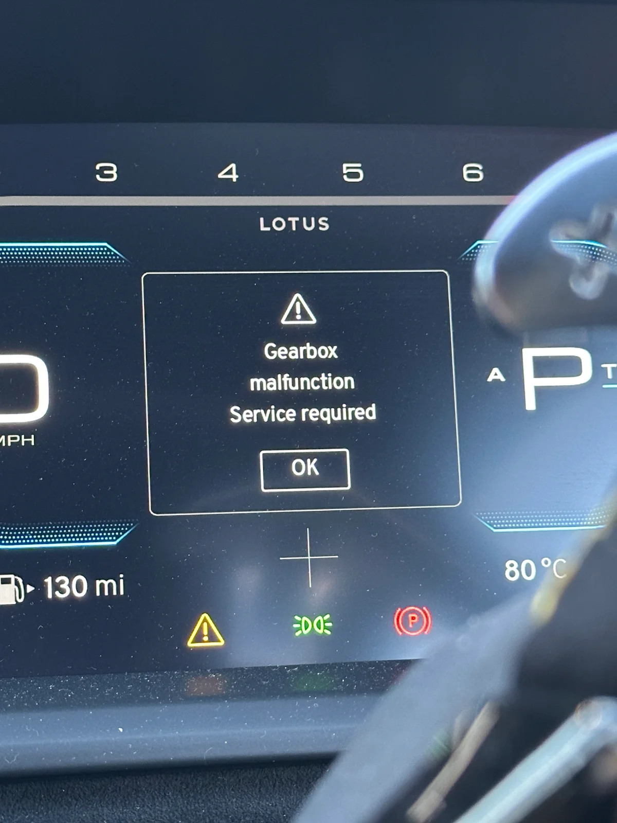

Had this flash up on the dash, along with yellow engine light the other week. Thought it might just be battery gremlins, car ran ok so cleared it, and have driven it since for a week ok.
Was on the M4 today when it dropped out of 6th gear into 5th and engine warning light and gearbox error came up again and then couldn’t get it out of 5th gear, either up or down a gear via paddles. (It’s the autobox V6). When I came off the motorway and got down to 20mph it was then throwing a wobbly flipping between 5th and 3rd gear on the screen.
When I started it up again it seemed ok, and had to drive to get home anyway, which it did with no issues.

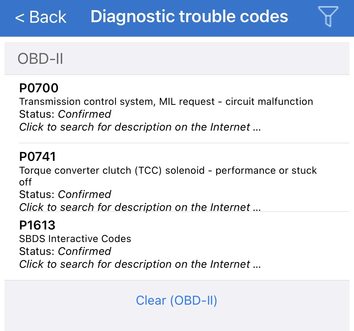

It’s showing the below codes, p0700 p0741 and p1613
Anyone had anything similar?
I dont think they gave good quality control for the v6 auto I also get random p0700
Apparently, many Evoras also had the problem with air in the line, because the line is about 9 meters long. After fixing it, I've now driven 18,000 kilometers without any problems.
I'd get that to a dealer. Reading your post on Pistonheads too, just sounds a dangerous position to be in.

Kinda. What no one is addressing is the why (there is air in the lines...)? It's well known in the Evora community that the auto trans. is prone to overheating. So much that it went through different iterations of cooling methods over the various Evora iterations (different Transmission coolers, etc.). In general, the V6 auto trans on the Toyota V6 while impressive out of the gate, is not well suited for heavy/track like usage. Said another way, if you drive it hard, it will "hiccup" eventually.
I had a 20212 Evora S IPS for a few years and never heard of any issues on the gearbox. I loved it. I didn't track it but it was used for some long runs of spirited driving on a few occasions. Honestly, I loved it! Now I have to do throttle blips on the downshift manually!
I had a similar issue on my Evora IPS - turned out to be water ingress/corrosion in the wiring loom connector between the main car loom and the gearbox loom.......

They had the car for a week, found the gearbox oil was low which was believed to be the problem.
No leak showing so they were not sure why it was low, had only done about 5000 miles since last service.
Gearbox oil topped up, and has been fine since!
