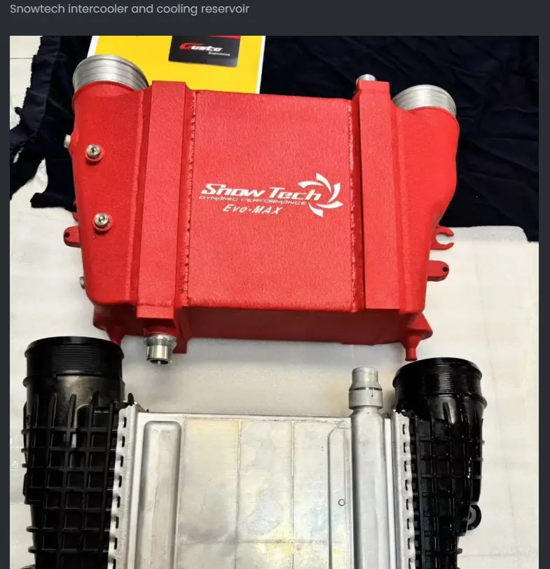

What's the point of installing the JB4 if you can't run MAP 2 or 3 for a track event because of over heating?
Isn't it better to install a piggy back that will unleash more power by getting the rev limiter past the 6,800 RPM wall?

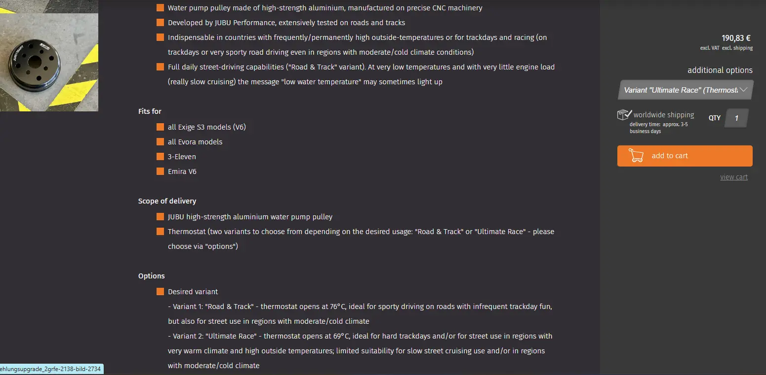

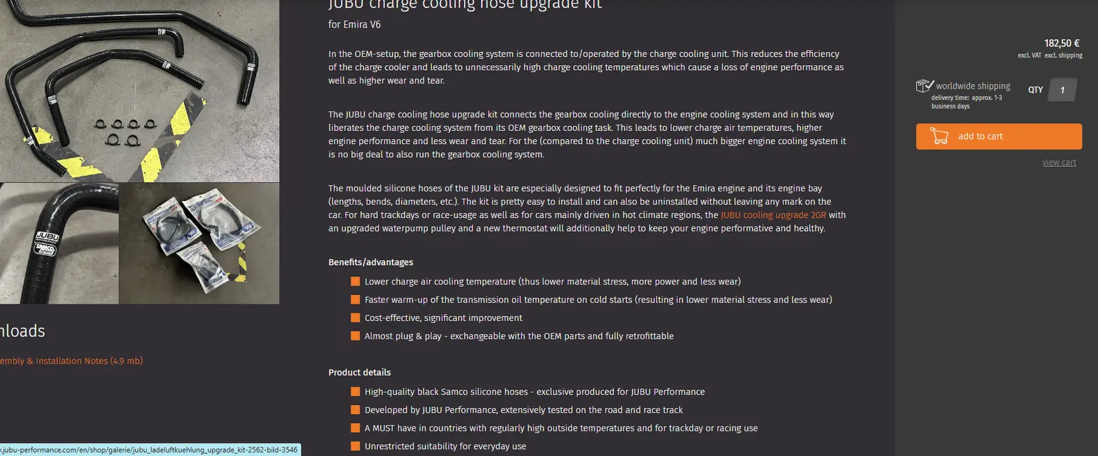

What are the best fixes available that can be installed to keep the temps low?
I removed the rear windsheild and installed the JUBU louvre which allows more heat to escape already.
Will the new VF Tuner supercharger lid help to keep temperatures low?
Yea only option is a JUBU tuning. New ECU and can do all this. Currently have the 460 kit with the cooling upgrade. I run track mode and run it hard and engine temp is max 175 degrees Fahrenheit. I love it!
