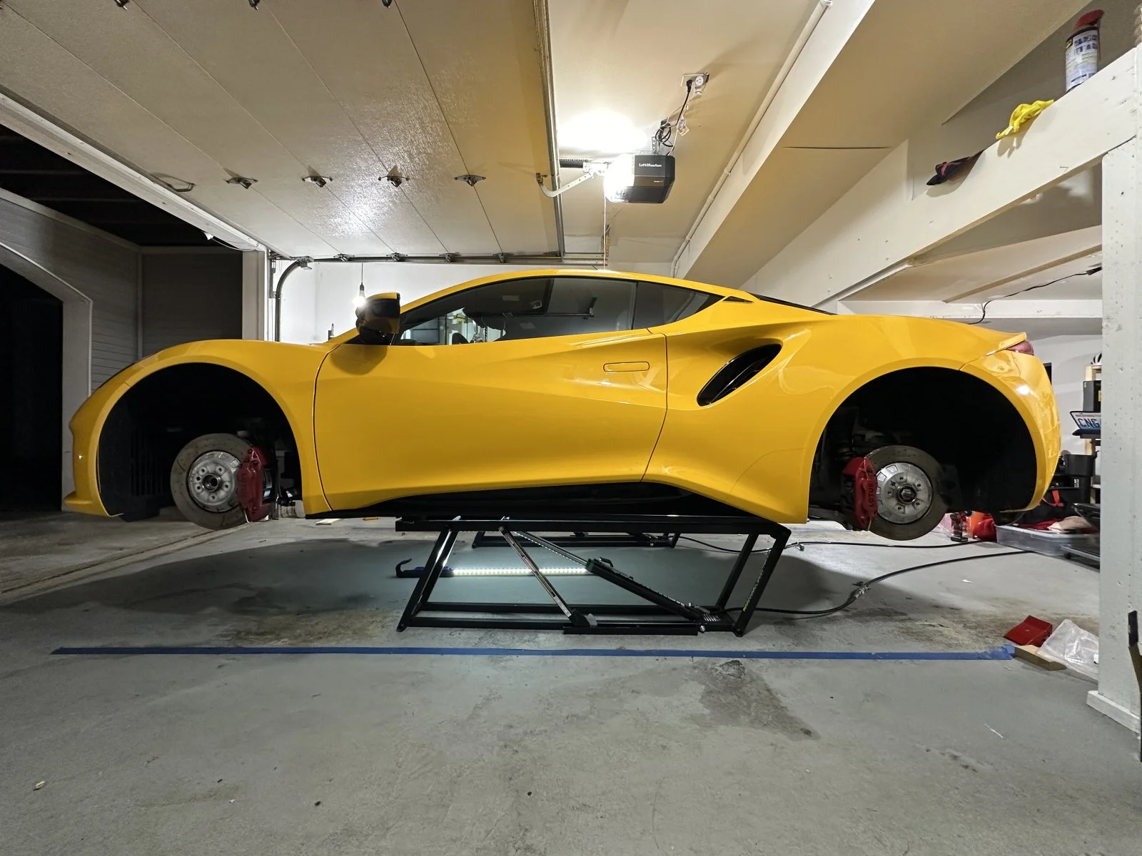

You don't need to angle it. I did a little bit the first time but not the second. I have the 6000 ELX. I positioned the rear at the inside edge of the lift points and the crossbeam on the front. You could however spin it and lift with the fixed points on the front and the crossbeam extended wider than the quick jack for the rear points.

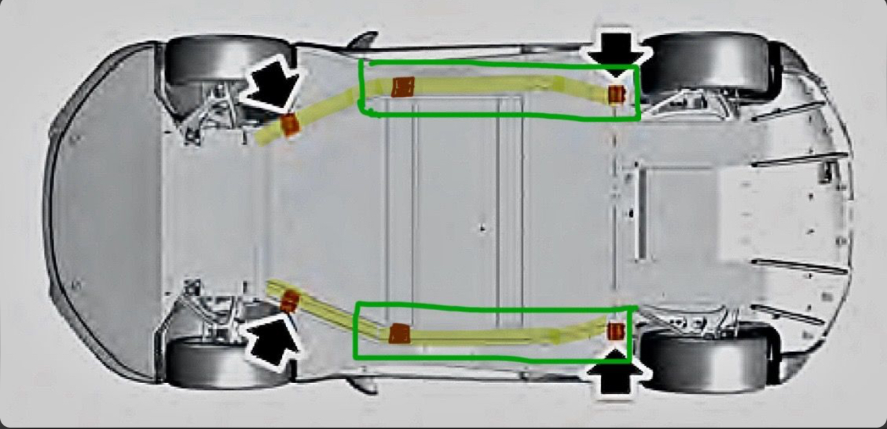

I bought the QJ5000TLX for use on all my cars including the Emira. I don’t have my Emira yet, but I read this fits without hitting the tires and to use the rear lift points as indicated and the front points in the picture which the factory uses for their robot movers. See picture……. (This is Silent Cilantro’s 🌿 image btw). This is how I have lifted multiple cars. Just how I and many others have done it. Chime in if ya agree or disagree… all good.😊

I understand that the sticker end has to be at the rear jack point and the front aspect has to be at the frame point where it begins to turn inward.
My car is currently up on the quickjack 7000tl
