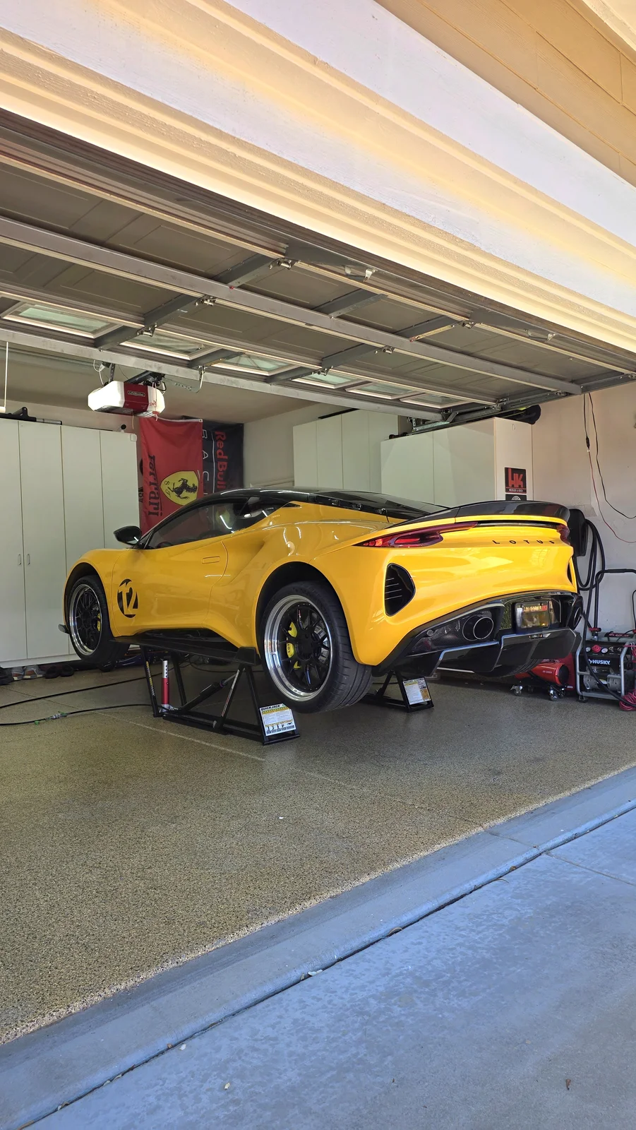

All, I had success using the QuickJack 6000TL this weekend. I used the rear jacking point and placed the front lift point just rearward of the "kink" in the frame. Worked perfectly. No issues at all.

TLs or TLXs will work with zero issues on the Emira. Only difference is whether the front blocks will be positioned before the angle or after the angle.

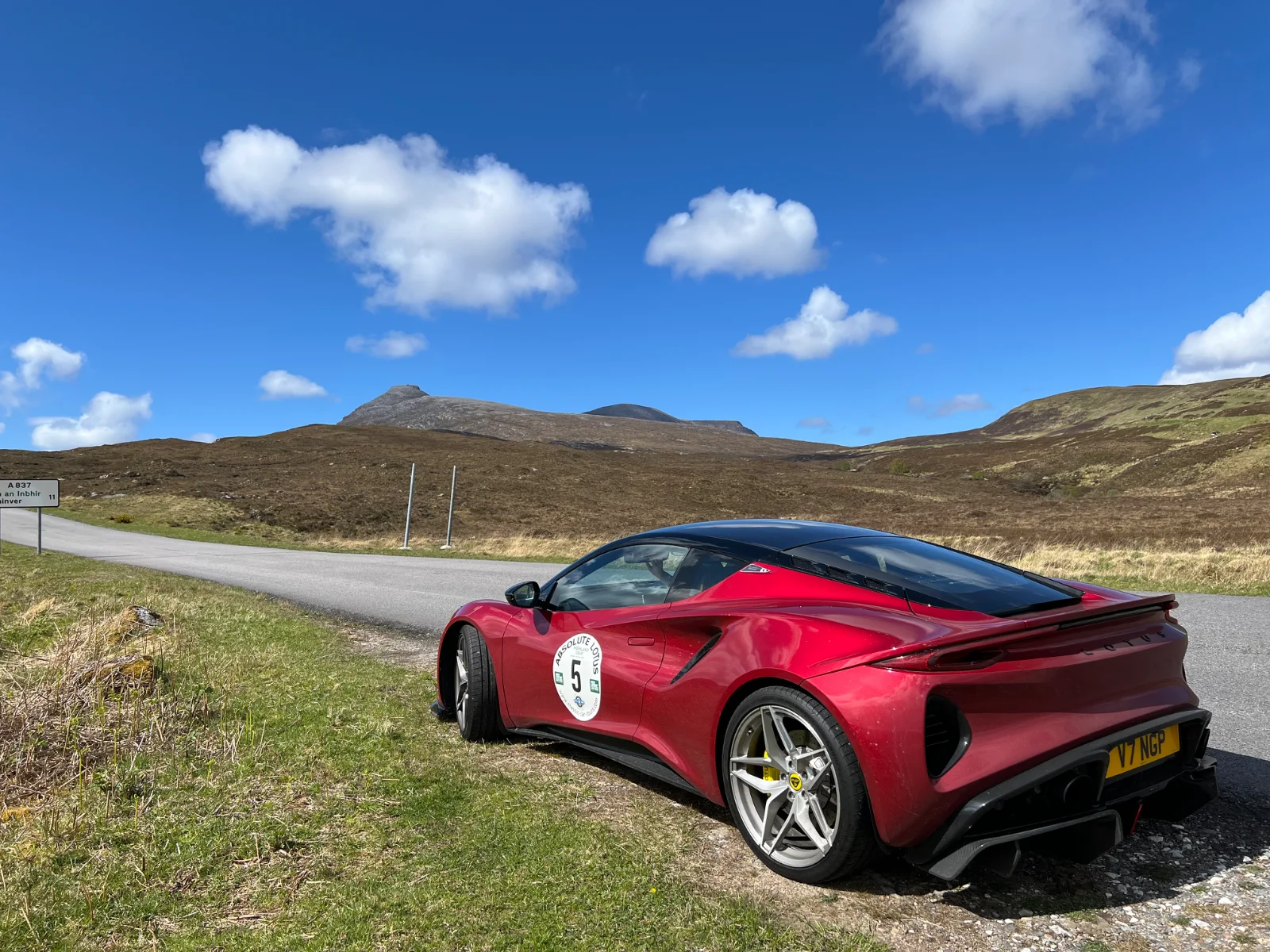

The vent block and the fact it sticks over the OEM one, were the reasons I went for a different diffuser. Mine replaces the OEM diffuser, has the valve vent and is about 5kg lighter than OEM.
