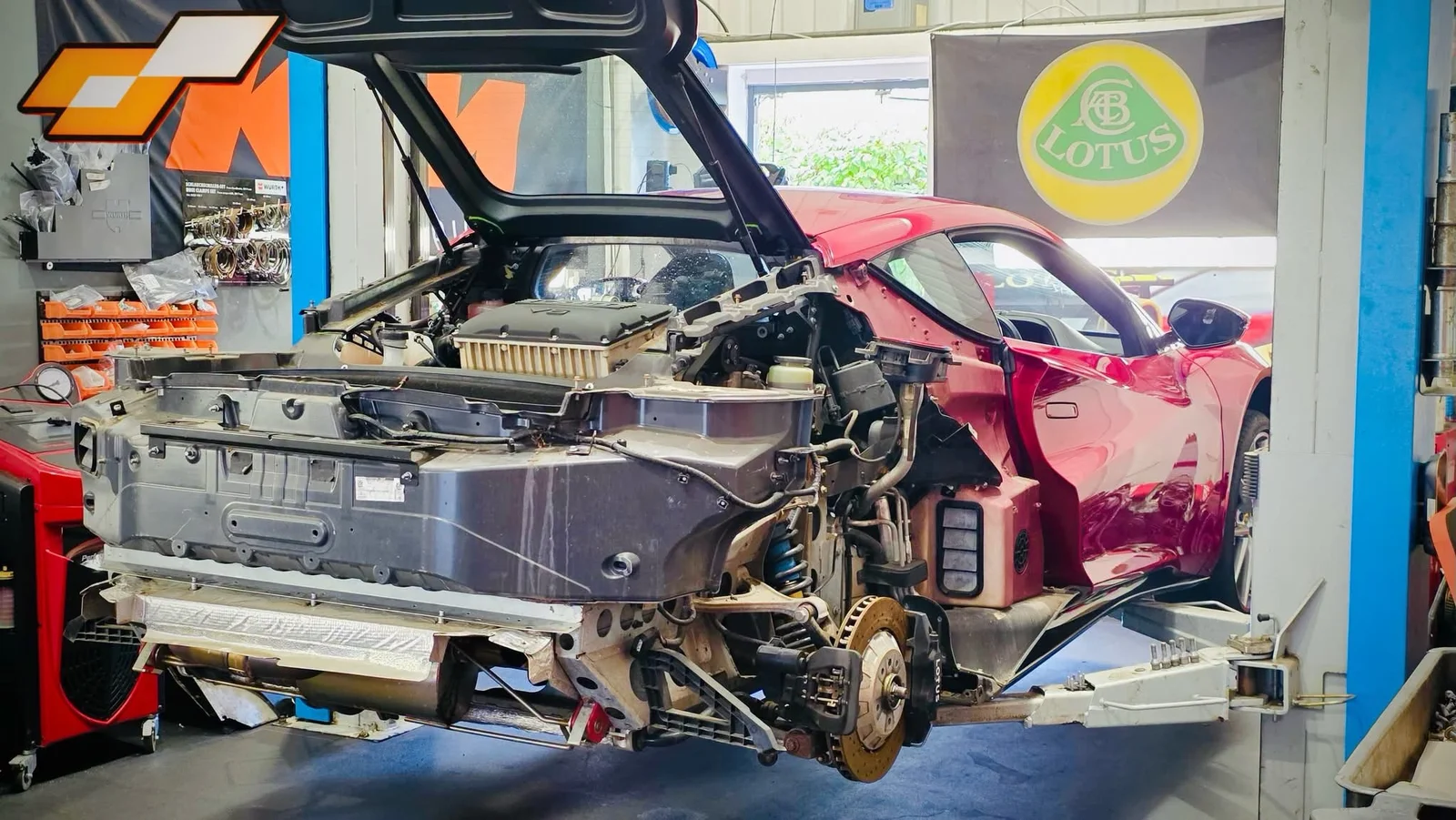

Well this absolutely sucks, jack slipped off rear pad
I am so very lucky I think, could have been so much worse considering the lines that run through there.

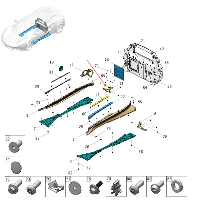

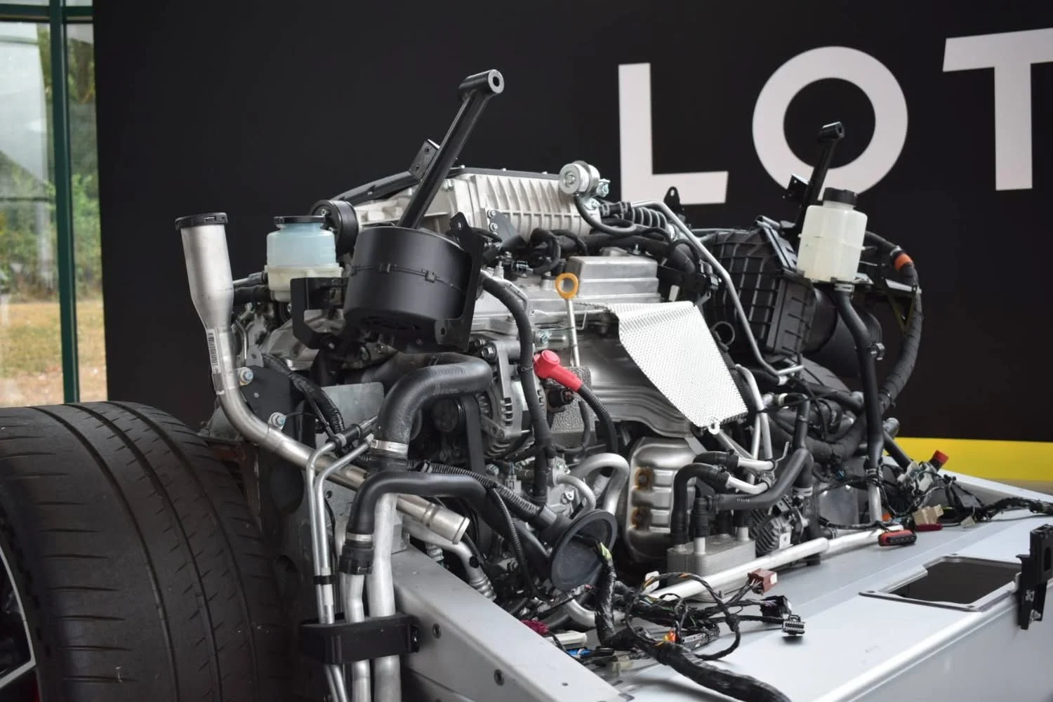

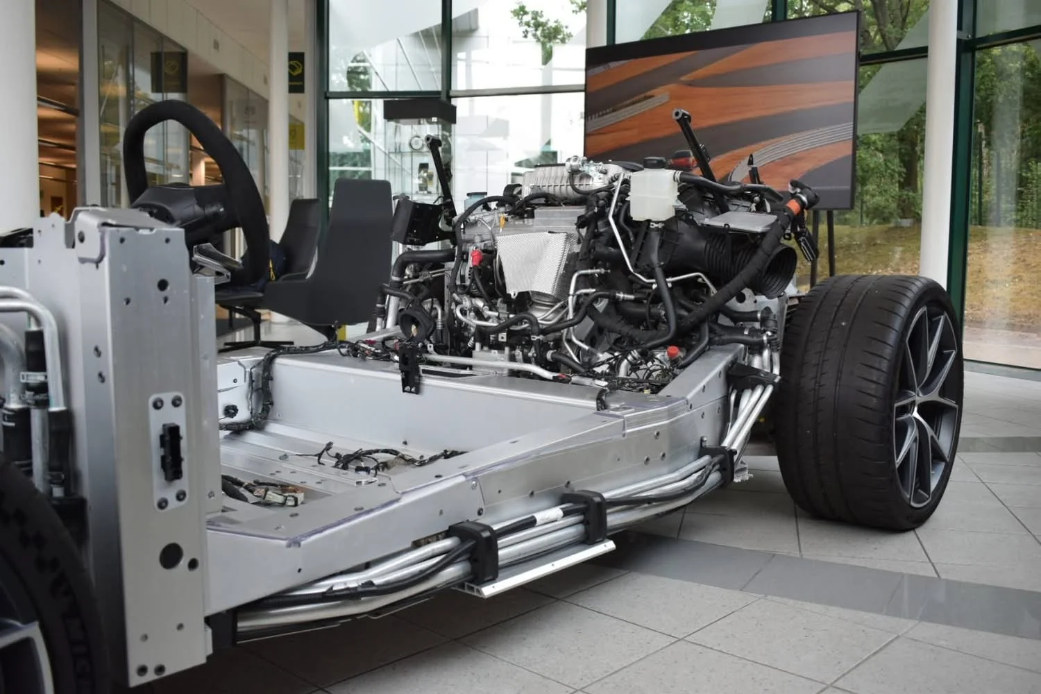

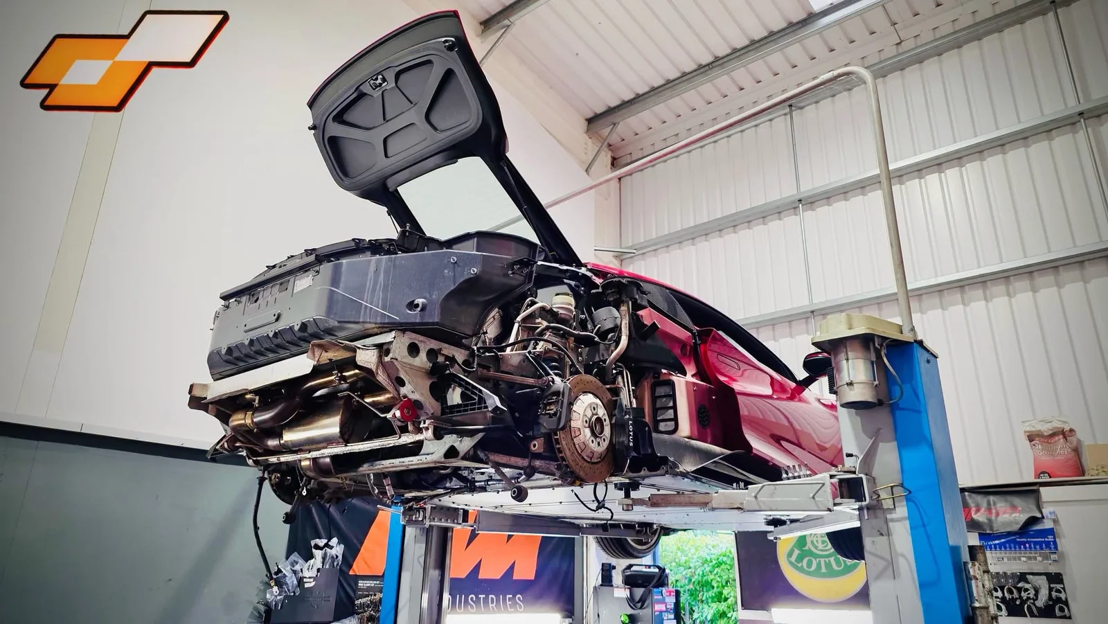

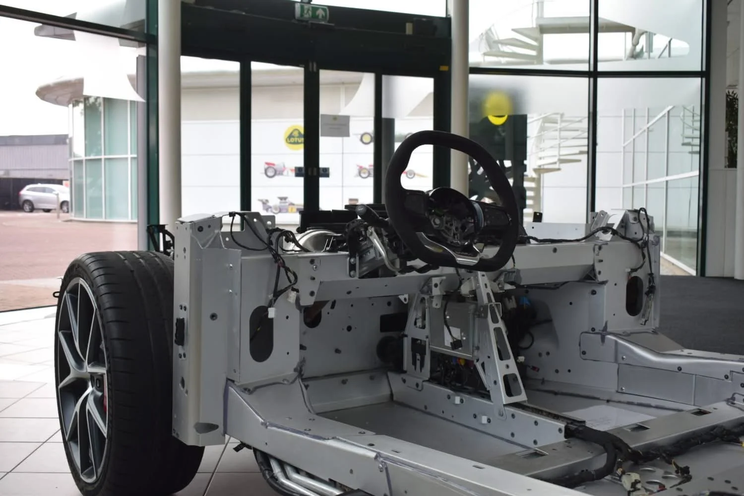

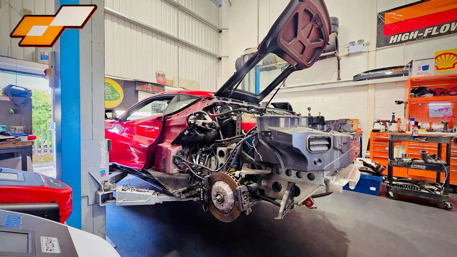

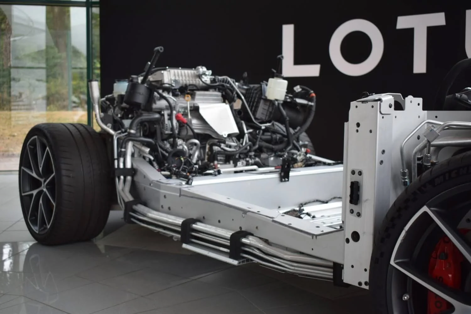

Just in case anyone else goes through this horrible experience, here are a few more pictures I scoured off the net that expose what's under the sill.
Since the weather wasn't horrid (still not great, humid, but with a breeze tolerable).

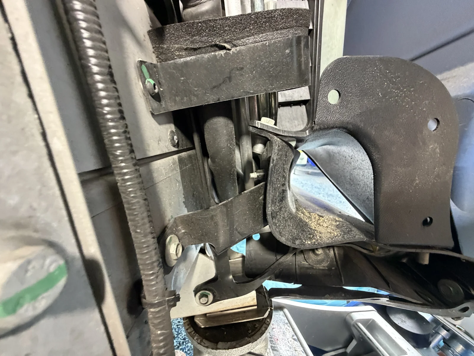

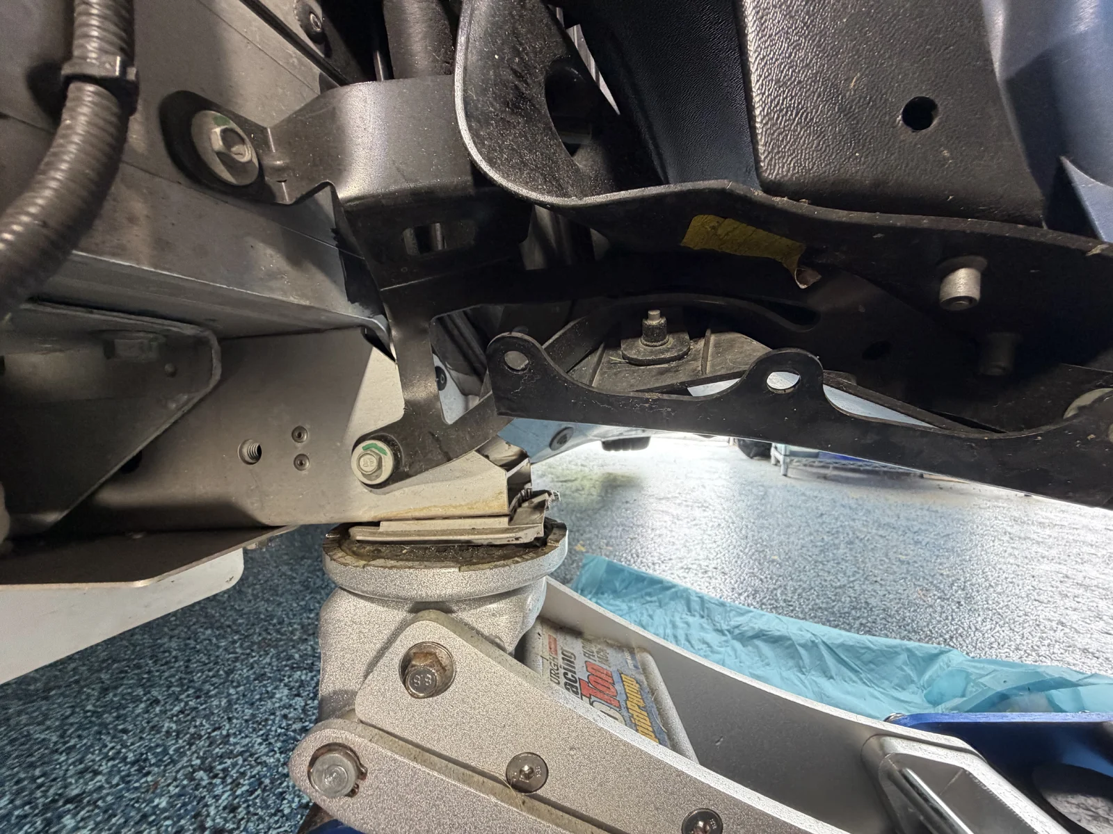

I took the wheel off, and took the liner out for way better pictures of the bracket.
And I can get away with just the bracket. The panel did crack but its minor and once the panel is back to where its supposed to be no body will ever know.
The pipes did move a bit but they aren't crushed or anything so thats great. Once I see the new bracket in person I'll make another assessment. The cad drawing I've been finding on the lotus parts signs looks like it was made to be viewed on a potato. Lowest res image I've seen in 20 years.

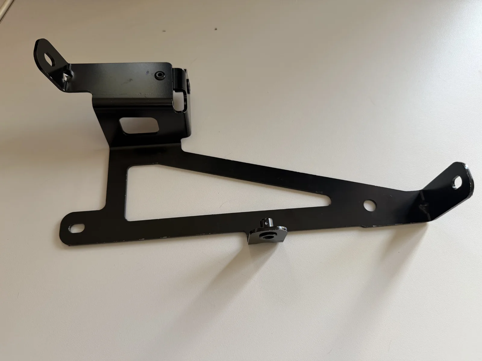

Basically 4 bolts, and easy replacement. Should be able to do this with just the liner and wheel removed.
Bottom sill plate looks bent. You plan to straighten back to normal shape and hope it lines up? I will just say you are not alone in this mis-hap, dealing with my own jack slip. :(
Bottom sill plate is plastic. So should flatten out.

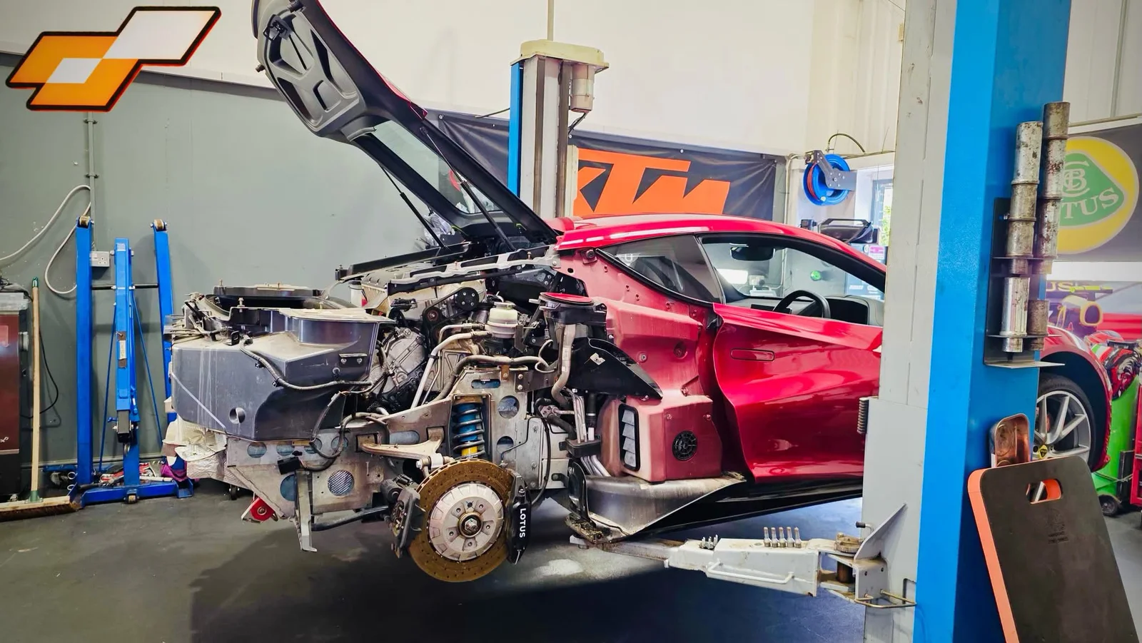

Tangentially to this thread, I recently had my car on a 4 post lift using the factory jack points. I got a little freaked out because when stopping the lift the nose of the car would sometimes actually do a little hop because of how rear biased the weight is. Seems like this shouldn’t happen with the factory jack points.

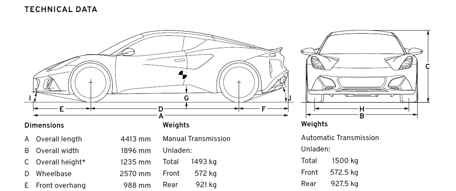

My 'unofficial CG' calculation i did based on the weight loads at the tires.

I can see your point about centering the car’s weight on the lift itself so the lift itself is loaded correctly but that wouldn’t change the car’s center if gravity in relation to the jack points.
I took his post to mean that when the Emira was on all 4 jacks pads that the front end was almost ready to rock back. Which for a design standpoint wouldn’t make sense at all.

Yes, this is what I meant. Not that it’s impossible I did something wrong, or perhaps the lift itself was a bit out of level. I use the lifts on the military base near me and they’re not the newest or best maintained.

Wonderful news finally got the door sill off. While some of the lines are slightly bend I was able to put them back easily enough. The foam may or may not expand back to its original shape. No damaged or crushed lines, everything is exactly where its supposed to be now.
Took plenty of pictures. Yes, you can do this without taking the fenders/quarter off. It's not exactly fun, but it's not actually that bad. LOTS of screws. Honestly, the clips for the door sill finisher plate, both the sill, and the rear cover SUCK.
The "Emira" aluminum finisher plate? Yeah, plan on buying one. It's glued on, and you are NEVER going to get that thing off without mangling it to hell and back. there is a 2D barcode on the back, I assume it's the PN#.
Use LOTS of tape to protect the finish in spots. You are going to be PRYING on things that just do NOT want to let go.
I credit a forum member here who pointed me to another thread which did had almost everything needed to point out how to do it.
But, honestly first time ever, going slow, double/triple checking things.....
3-4hrs to get the door sill off.
I need to hammer some small brackets back into shape, I have to replace another bracket, along with the bottom sill cover.
I have pictures, I'll post them up once I annotate and order them. I'll double check in the morning with daylight to see if there is anything else I need to order.

This is in addition to the bracket I already ordered:
$35.83 - 8892142790 - PLATE ASM-RH DOORSILL PROT
