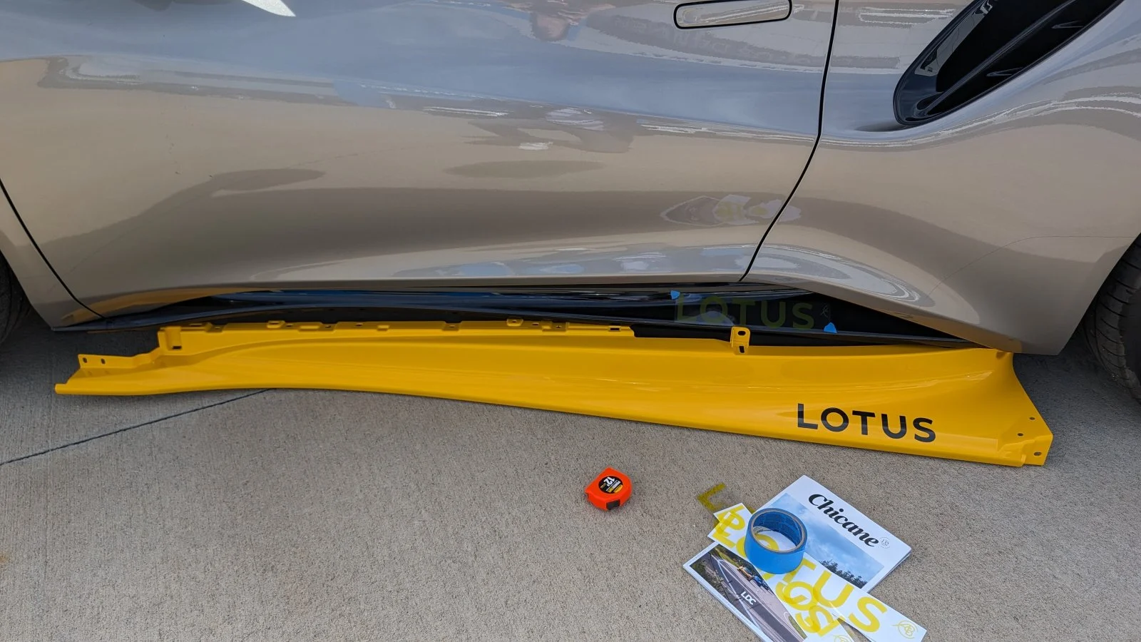

I contacted Gary Dunster at Bell and Covill. I honestly can't say enough good things there. He's helped out with more than just parts. I ordered up a set of sills in January of 2024 before my car was even locked in. For anyone wondering they're 321 GBP each. I also arranged for a local car restorer to paint them. This is where things went sideways. The original plan was to do the LOTUS lettering as a decal and PPF over it. Well, that would leave little voids around the letters. I could apply the decal over the PPF, but that would mean it would need to be replaced as this area would see grit. The restorer convinced me that they could paint the letters and sand it flat enough that you couldn't feel it. Clearly that's the best way to go, yeah?
As it turns out, yes. But only if you have a very good idea where it's going. I was able to make contact with someone at the factory and they gave me what I thought was good intel, complete with a picture against a ruler. 3" from the rear end of the sills is where the letters should start. Anyway this is where I made my biggest and most costly mistake: I hedged my bets on the info, and even pushed them out quite a bit, but went ahead with painting them in March, mere weeks before I toured the factory the first time.

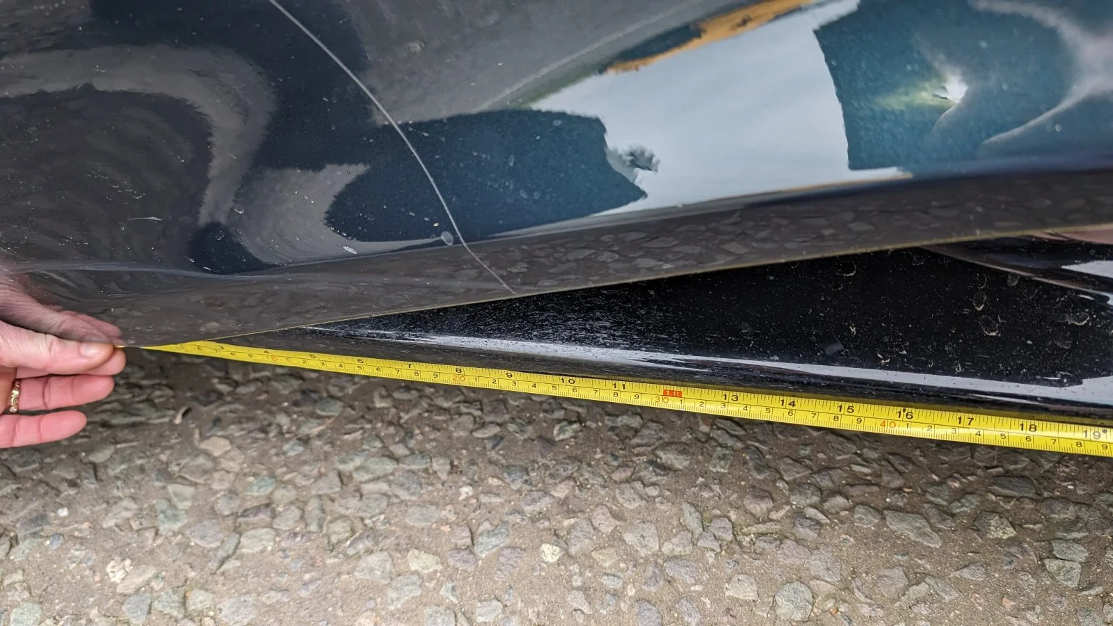

During the tour I was able to check out the car close up. It was painfully obvious that the letters were done way too far back. In fact the door sills go back almost ten inches from where you see them emerge from under the rear fender.
My newly painted letters were going to barely show. At best I'd see L and S.
The painter was sympathetic, but we agreed that I should wait until I could measure it on a car before they would paint it again. Thanks to CARB approval, that took until mid April when the first ones arrived at my dealer and I could measure this in person. I brought my template and the mis-painted sill and laid them near the car.
We settled on 16" from the rear edge.
As you'll see in the following pages, they look amazing. But this was thousands in repainting that I could have saved myself.

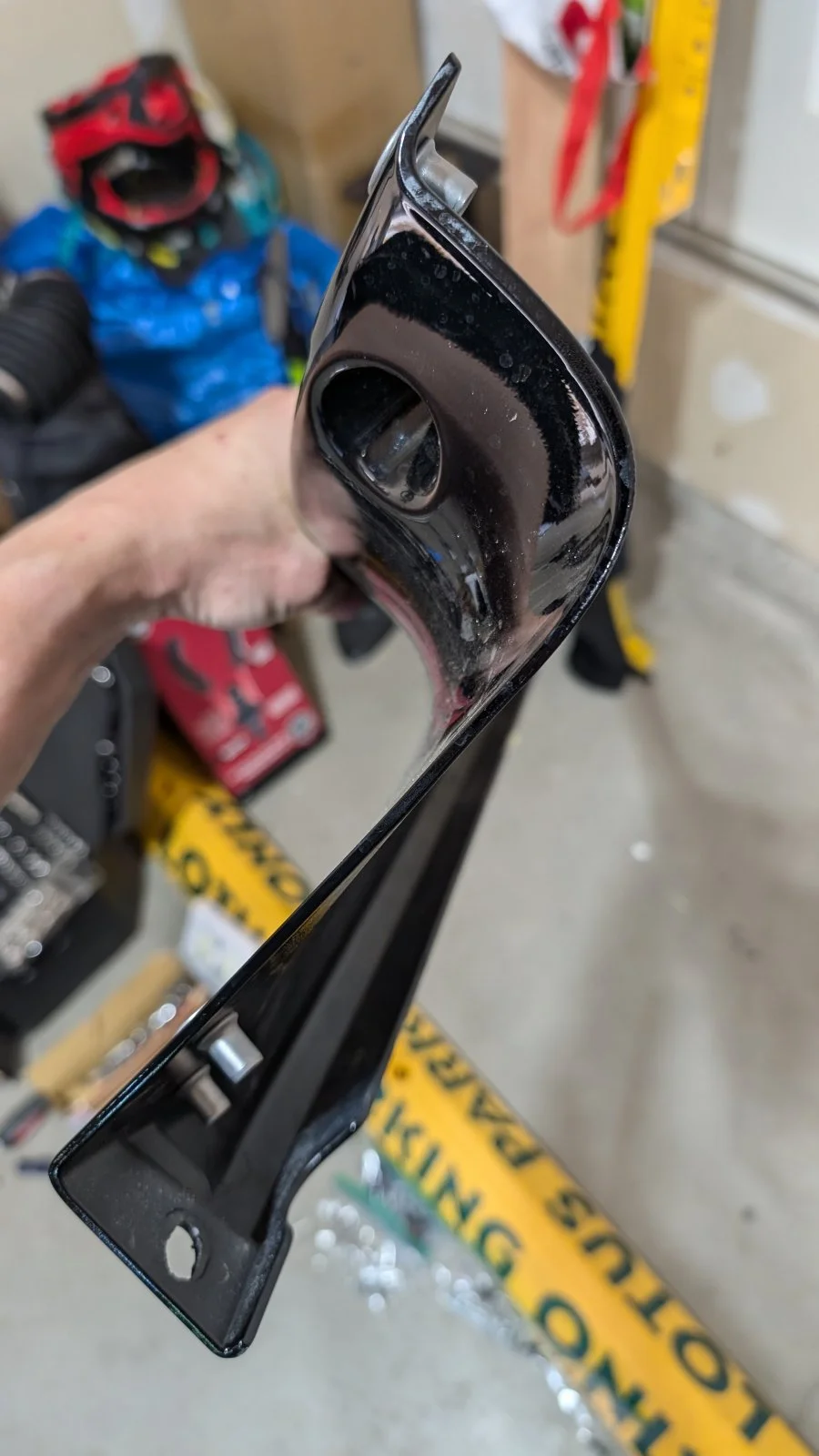

Sill finishers: A pain. Order replacements first. They sit in a cutout so you're likely to bend them. Slip a trim tool under them and pry while warming them with a hairdryer. They're also only $14 each, so... Don at Auto Europe got them for me.

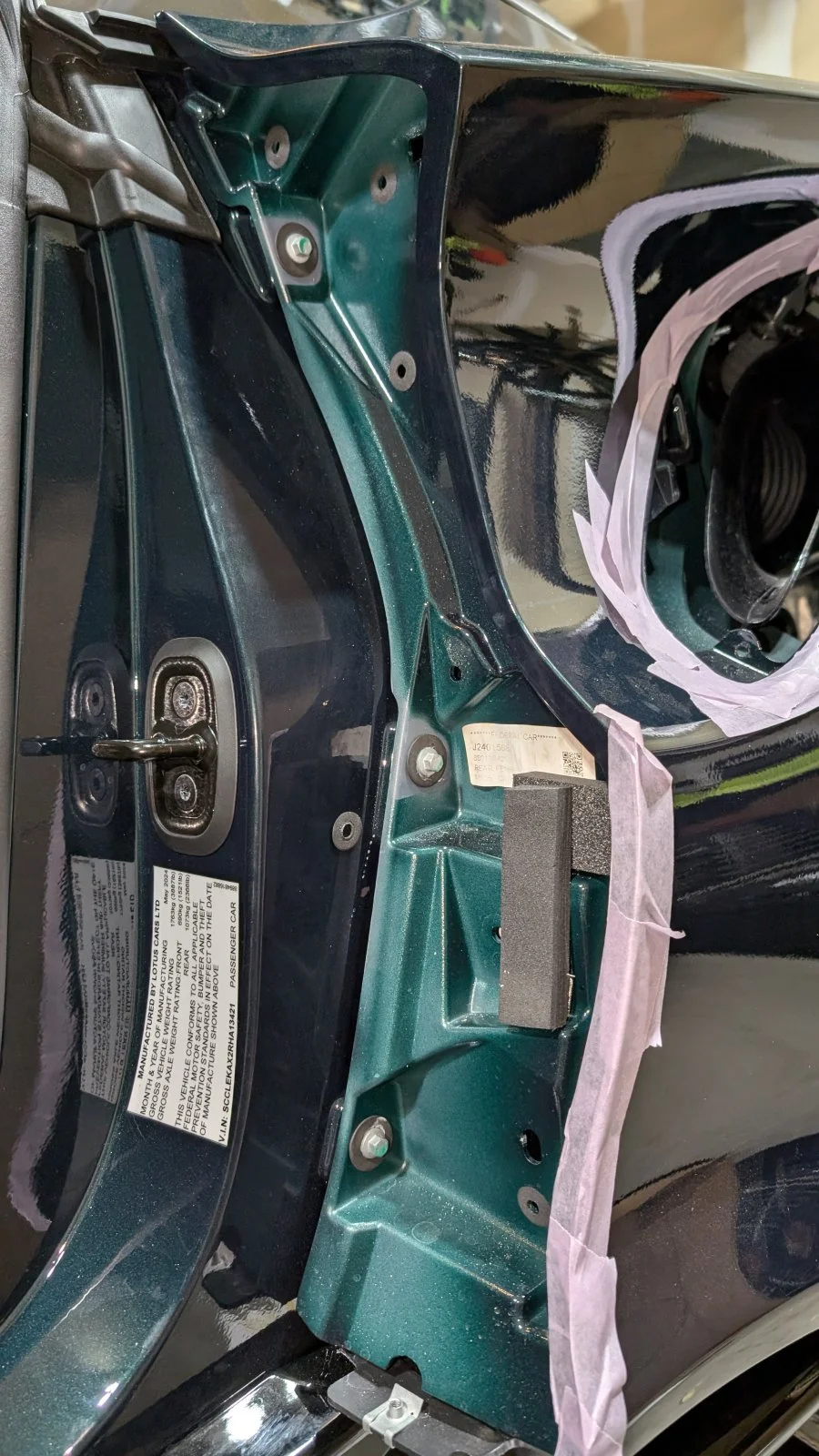

Rear fender finisher: Moderately easy. One screw under the front edge and then pop it out from the bottom first by prying. A piece of foam will fall out. Put it...somewhere when you put it back.
Remove the three bolts revealed.
Side vent: Kind of a pain. Use a magnetic screwdriver. Two screws and three clips hold it in.

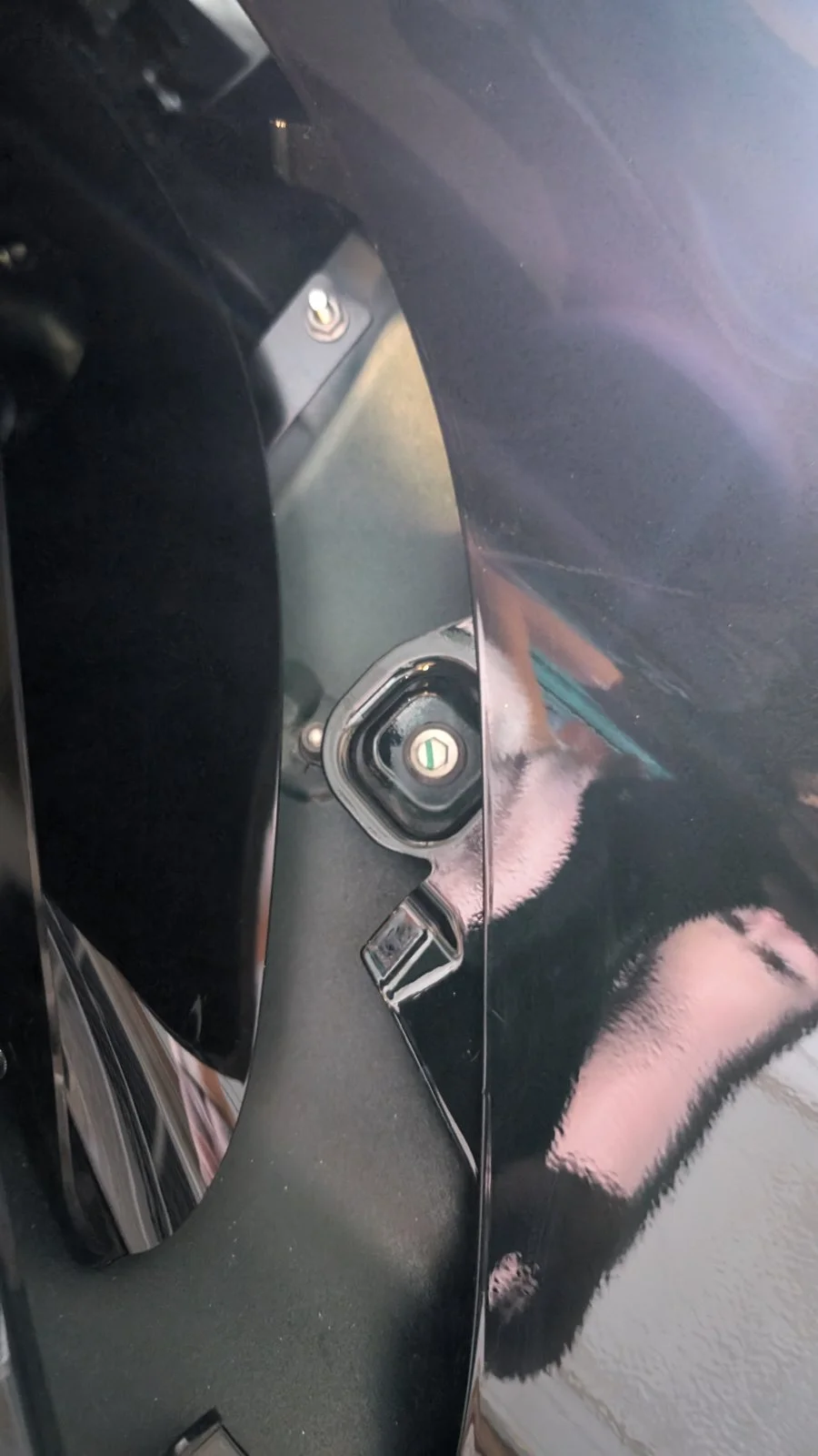

Remove this screw that's revealed behind it:
Remove the two circles bolts seen from the rear wheel arch. Leave the other three alone for now.

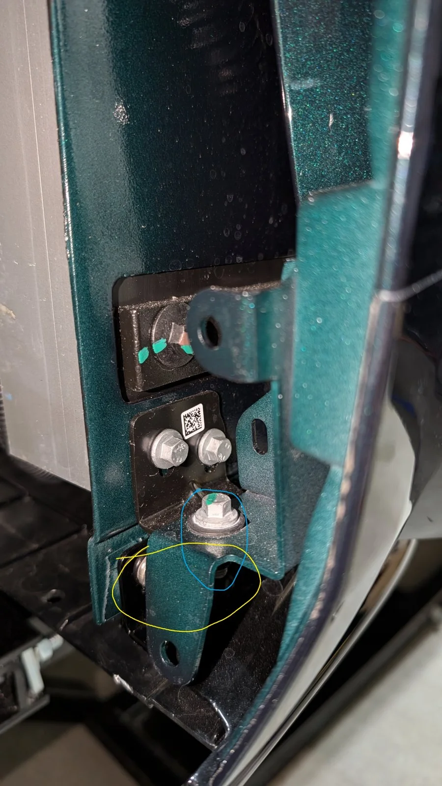

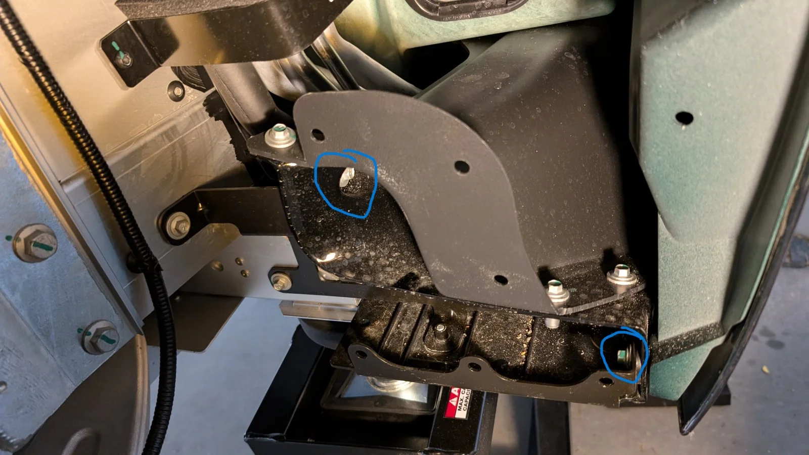

Trailing edge of the front fender. There are two screws you need to remove. One is pictured and circled in blue. Remove it and the one about a foot above it that serve the same function to hold that piece of the fender in position. Once you have, flex it out of the way and remove the two bolts circled in yellow.

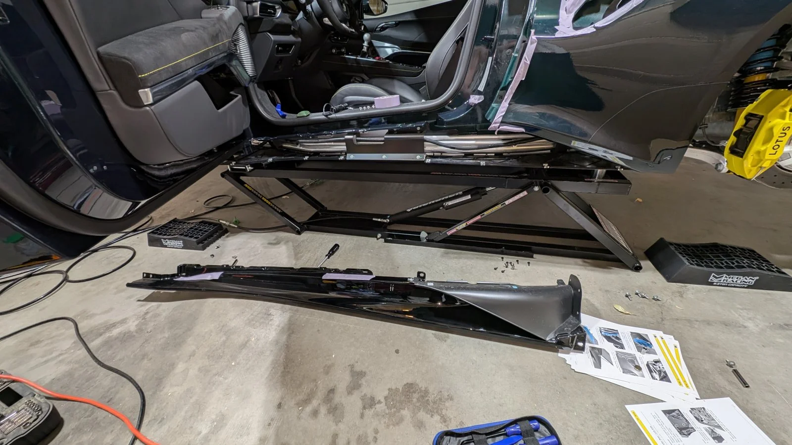

Upper Sill. Pretty straightforward and easy. Remove the seven screws from the underside where it joins the underbody, and then the several screws from above that you revealed after you removed the upper sill finisher. Then, you can flex the front fender away and swing the front pieve out, and by tugging at the bottom of the rear fender you can slide the upper sill forward and out looking like this. In the picture below I've removed the three screws that I said above not to remove yet. You can do that now.
To reinstall them, just go in reverse. When reattaching the front fender pay attention to the lie of the body panel. Close the door first and make sure the fender isn't twisted as you want the body to flow.

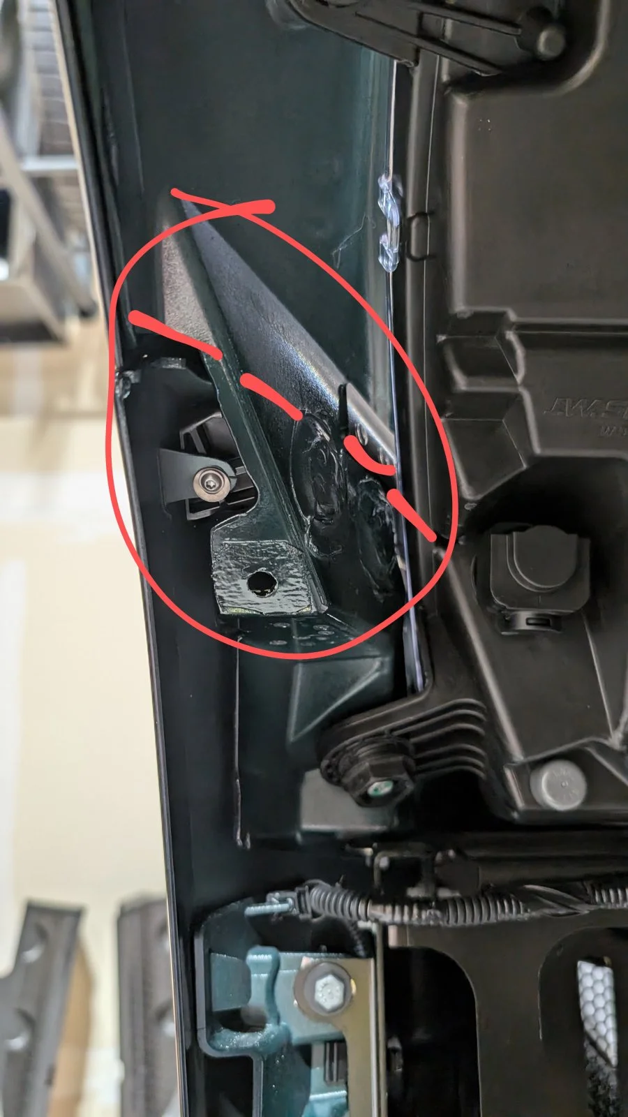

Remove the screw at the bottom corner of the bumper, and this tiny anchor screw circled here.
The dashed lines are where the clips are. We'll defeat those later. You will need an assistant.

Bumper: Biggest pain in the car. I'm trying to find a picture of the clip to explain what needs to happen.
Okay, no picture. Tape the edges of the panels. You need to wedge a thin trim tool in between the panel and the clips. Have your assistant pull at the bumper from the wheel arch area as you get your trim tool in there. If I recall the clips come at it from the top. So the trim tool is above the panel lip and you're trying to lift those clips out of the way. As you get each one the edge of the panel can be pulled a little. There's four or five. Once you're done, do the other side. After that it's easy. From the front, lift the bottom edge of the bumper away and it will swing up and off. Again, being careful of the wings of the bumper. The stock diffuser and front vents are pretty straightforward. (I'll add pictures later)

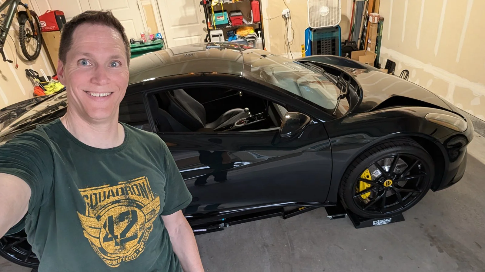

Car shown on dollies in the first pics
No dollies used. Those are low profile two part ramps suggested here in the diy oil change thread. It was a four point turn. There was a lot of questionable stuff happening on this build, the first of which was me taking it on. The only other thing I've done with a car is installing a hidden hitch on a Miata.
