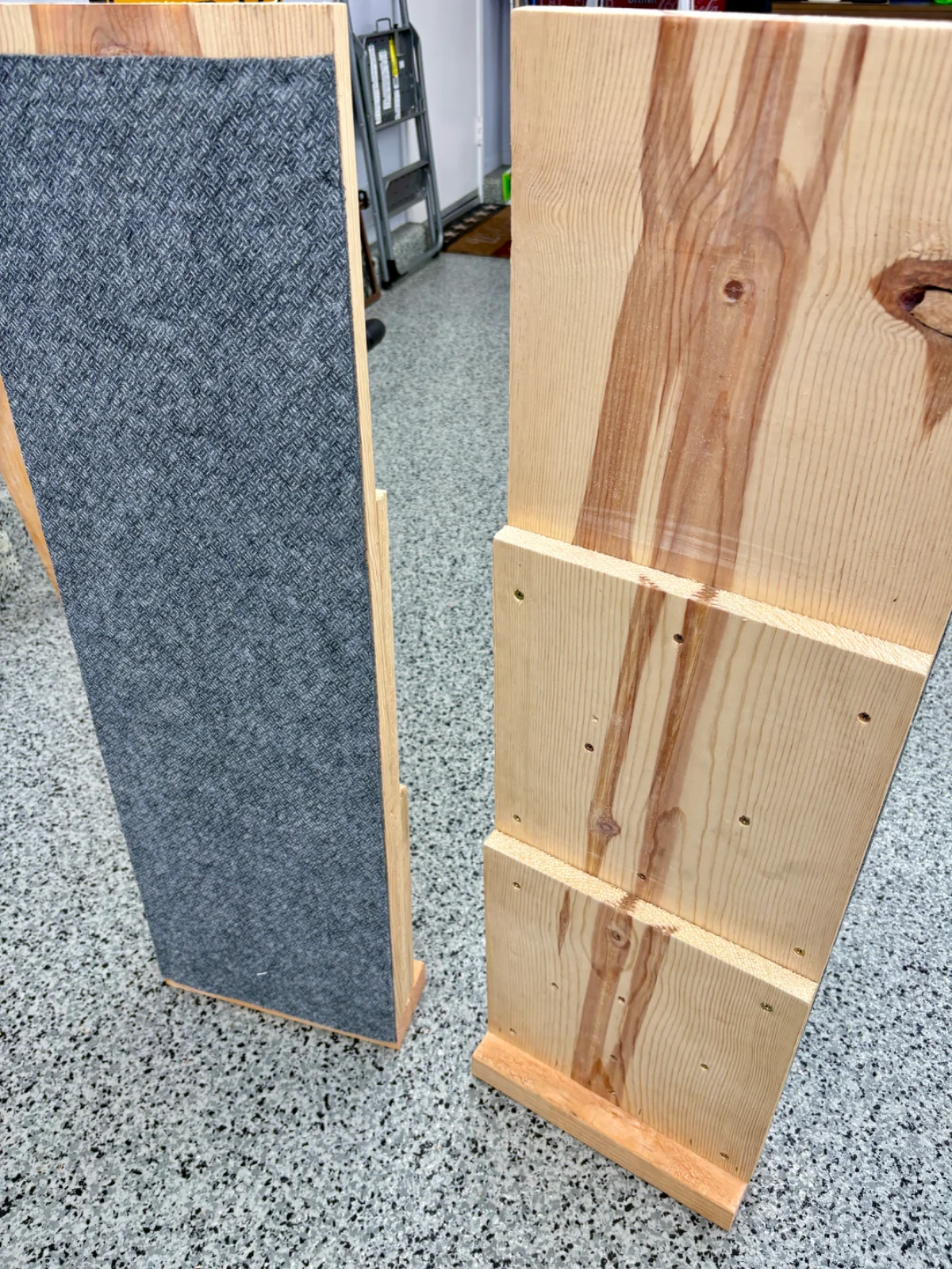

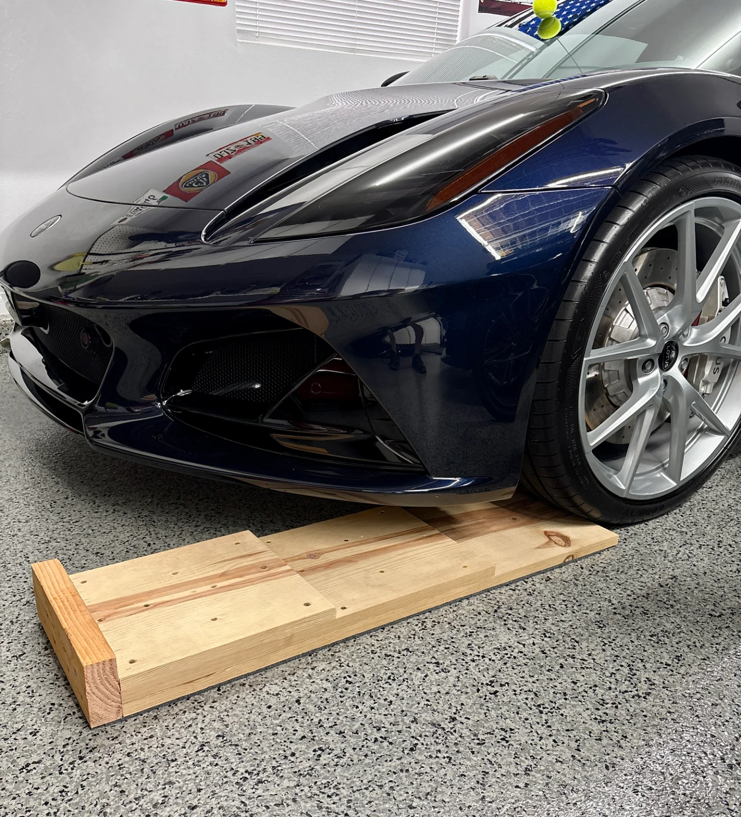

If you have tried using a floor jack on your Emira, you will know how odd and inconveniently the front lift pads are located on this car! I have an extended reach low profile jack and it still just barely reaches the pads without hitting the side skirts!

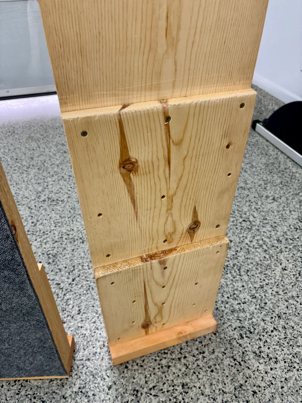

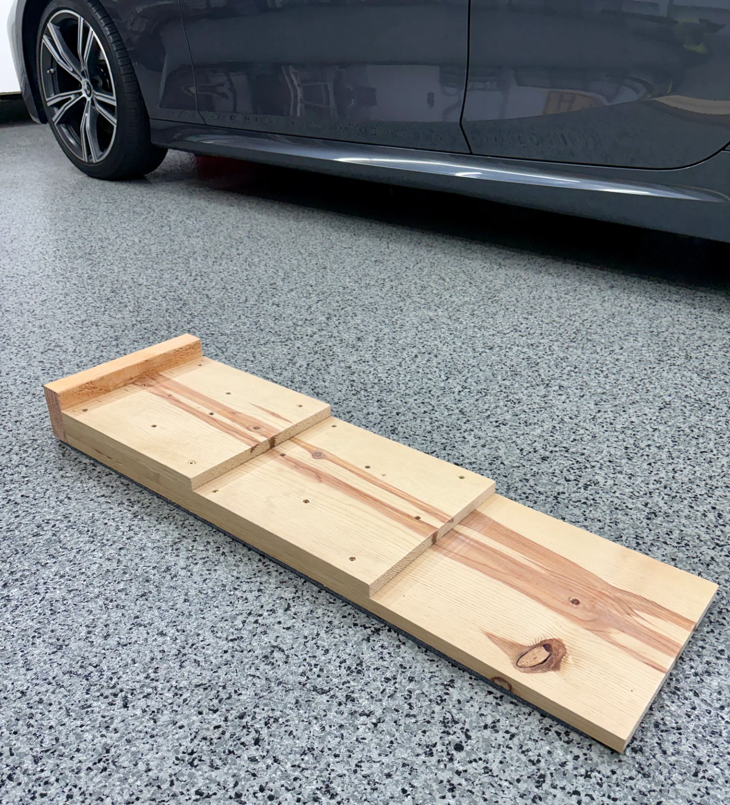

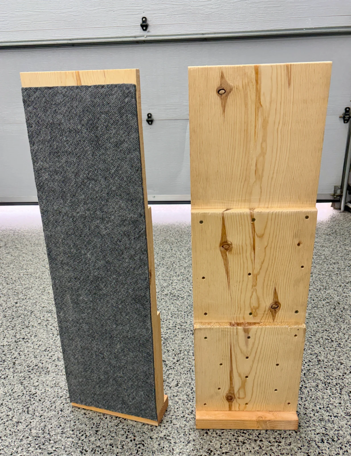

The fix, I made these today with some 1”x12” board from Home Depot and a 2x4” for a bump stop. Lastly I ordered the linked 1/4” grip pad for the bottom.
Non Slip Grip Pad - Veken Non Slip Cushioned Rug Pad... https://www.amazon.com/dp/B0FCR4QTPH?tag=emiraforum-20
Wood - 1x12” Pine Board
Bottom piece - 3 feet
Middle - 2 feet
Top - 1 foot
Stopper - 1 foot piece of 2x4”
Note - Actual size for 12” width is 11.25
This provides plenty of additional clearance to get a floor jack to the lift points! The total cost is about 65 dollars plus some screws which I already had!

I drive up on a couple of scrap 2x's and have room to get a Harbor Freight racing jack on the front lift pads. The rears are accessible with no 2x's.
