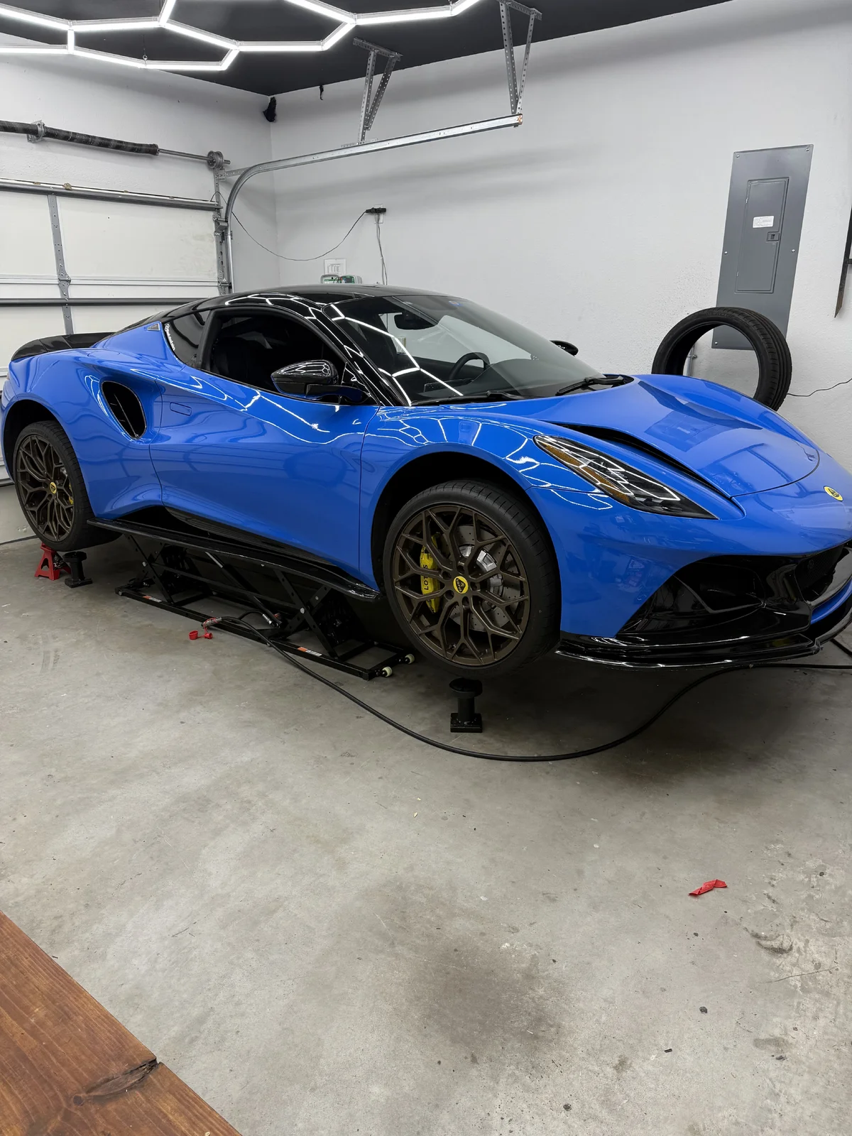

Hi Zoom, can you show us where your lifting points and blocks etc you are using with the 6000TL?
You just use the rear lifting point and then either before or after the “kink” in the frame. I have used both and works fine both ways
I always use the rear lift point with a rubber block and the side rail (not side skirt) with rubber block using my 7000tlx. It’s sat on the lift for a couple of days while I was changing my downpipe and catback exhaust.

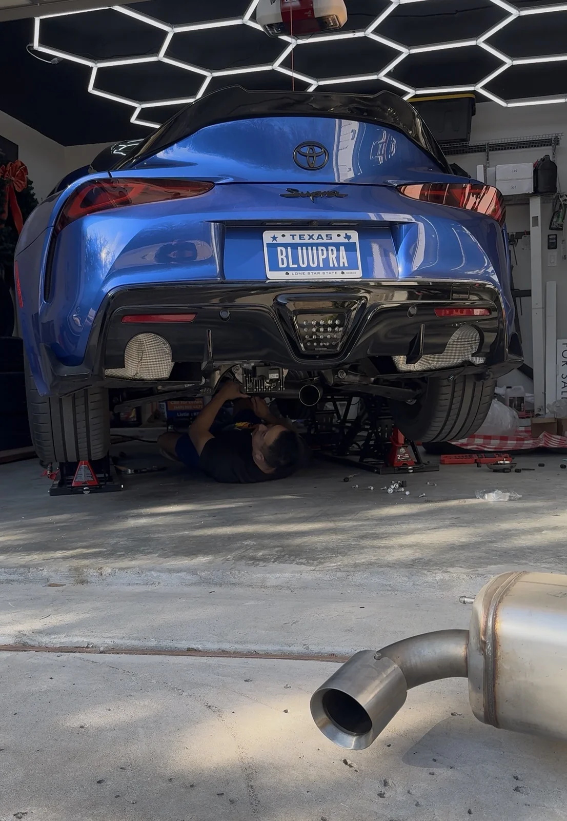

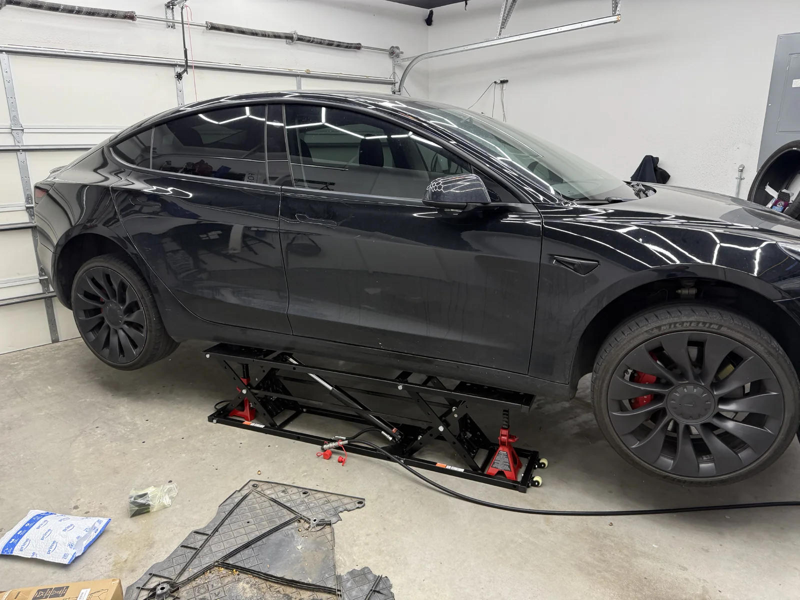

This is the one I have.
Vevor 5000
Does that work with the Emira? The minimum pad height seems pretty tall.
I bought smaller pads since the pads they provide were too tall. I bought 2 sets since I use it on the Tesla and the Supra as well. I use 2 pads per corner. 1 pad won’t clear the lift
