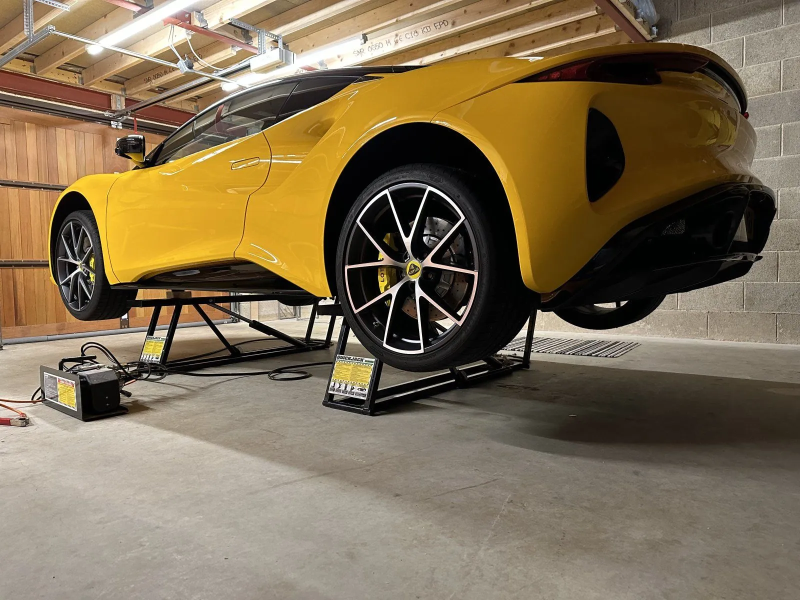

Used it on Esprit Exige and now Emira but only transversely.
The staggered arrangement of the jacking points make their use a tad challenging until you 'find a way'.
See the use of a small length of timber and a hockey puck on the NSF jacking point.....

Here's a video of how I used my Quickjacks this morning to replace brake pads...
These are the 6000 TLXs.

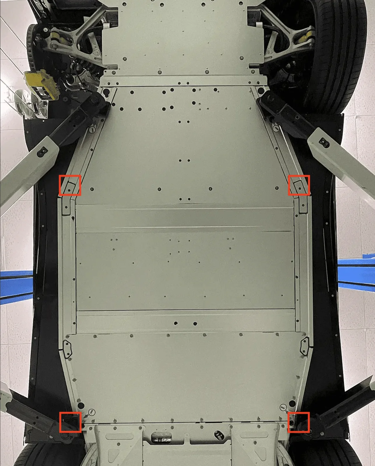

Summarizing this - looks like these are appropriate jacking points, can be used/reached with quickjacks, are aligned and stable, and people have seen success using them. Unless I'm missing something...
Yes, these are totally fine as I show in my video as well. ZERO issues doing this as that frame is structurally sound. No need to overthink where to put the front points anywhere along that frame rail. Just make sure they don't touch the pastic side sills and you're fine. I had my car up on them for like 4 hours. Zero issues or stress.
Just keep the quickjacks parallel to each other and just position the rubber blocks accordingly. The QJ trays have enough space to move the blocks around in them as needed.
