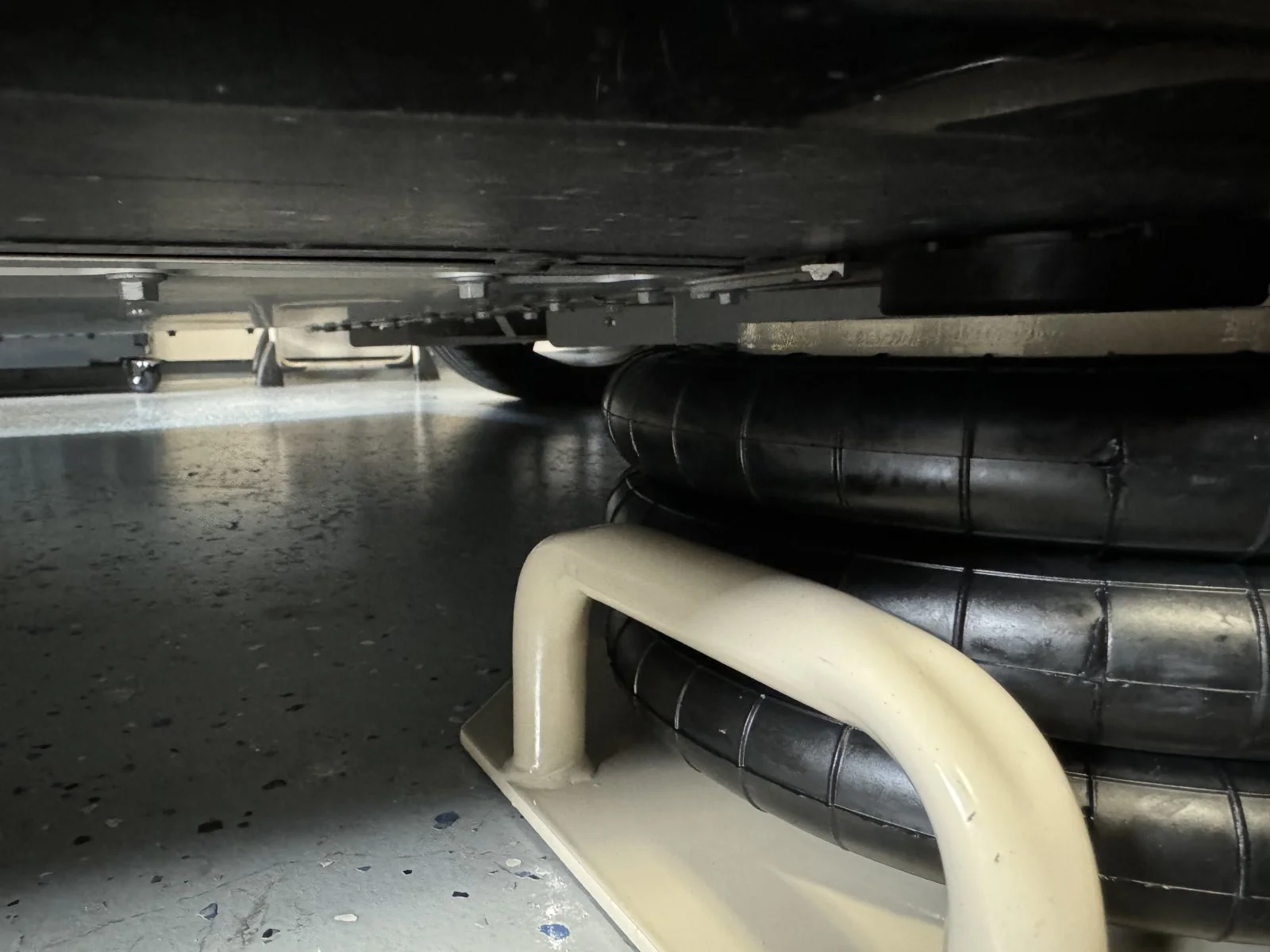

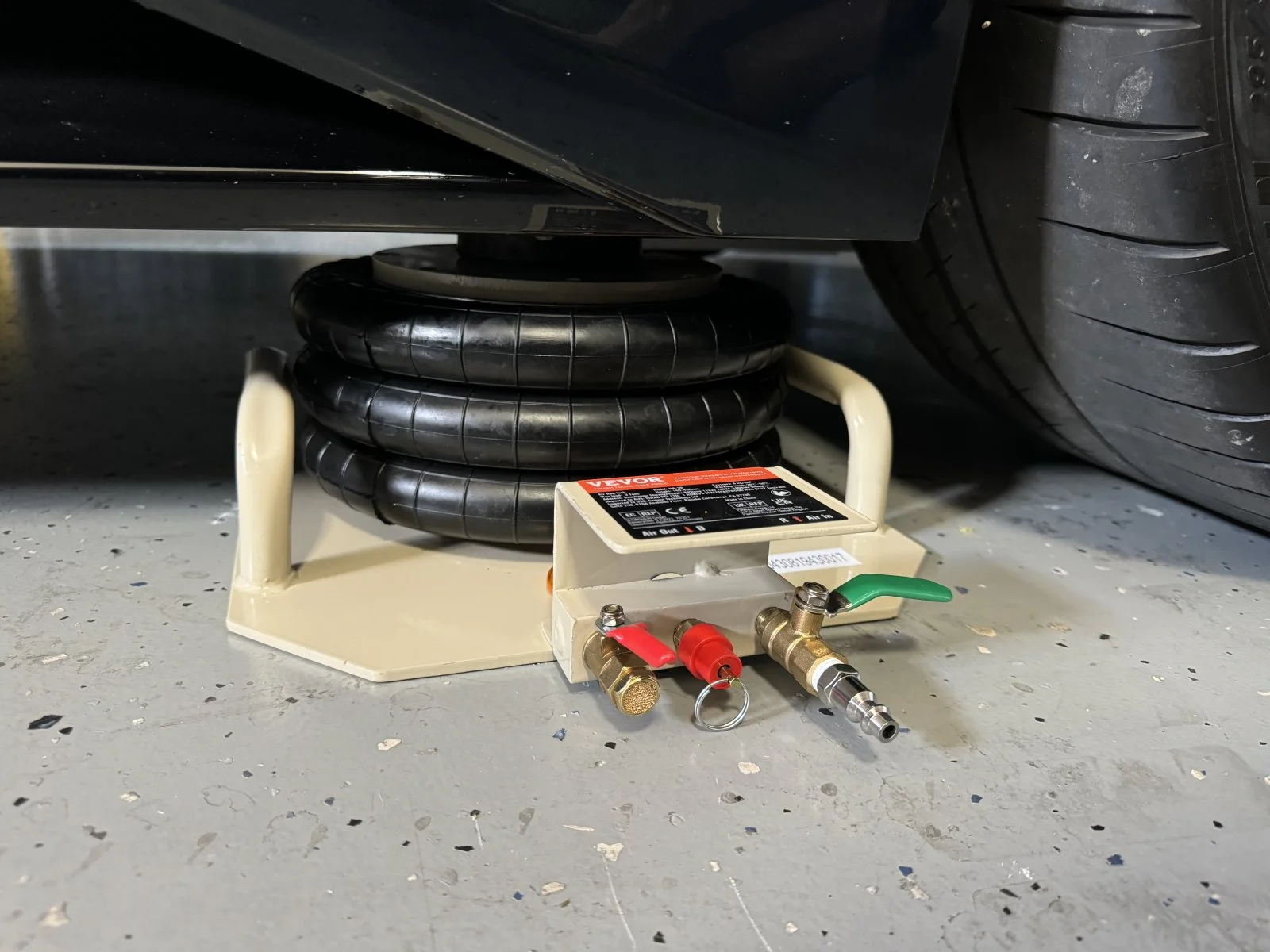

So this Vevor air bag jack in its deflated position is about an eighth of an inch to a quarter of an inch too tall to fit under the Emira jack pad. I think the three-quarter of an inch rubber pad that comes on the airbag jack could be replaced for a shorter rubber pad so it would work.
