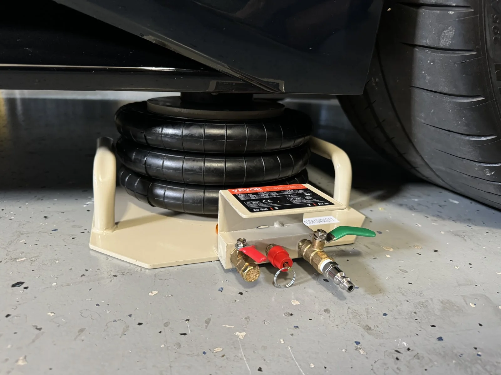

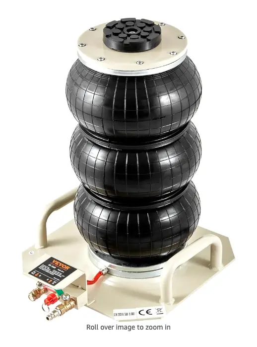

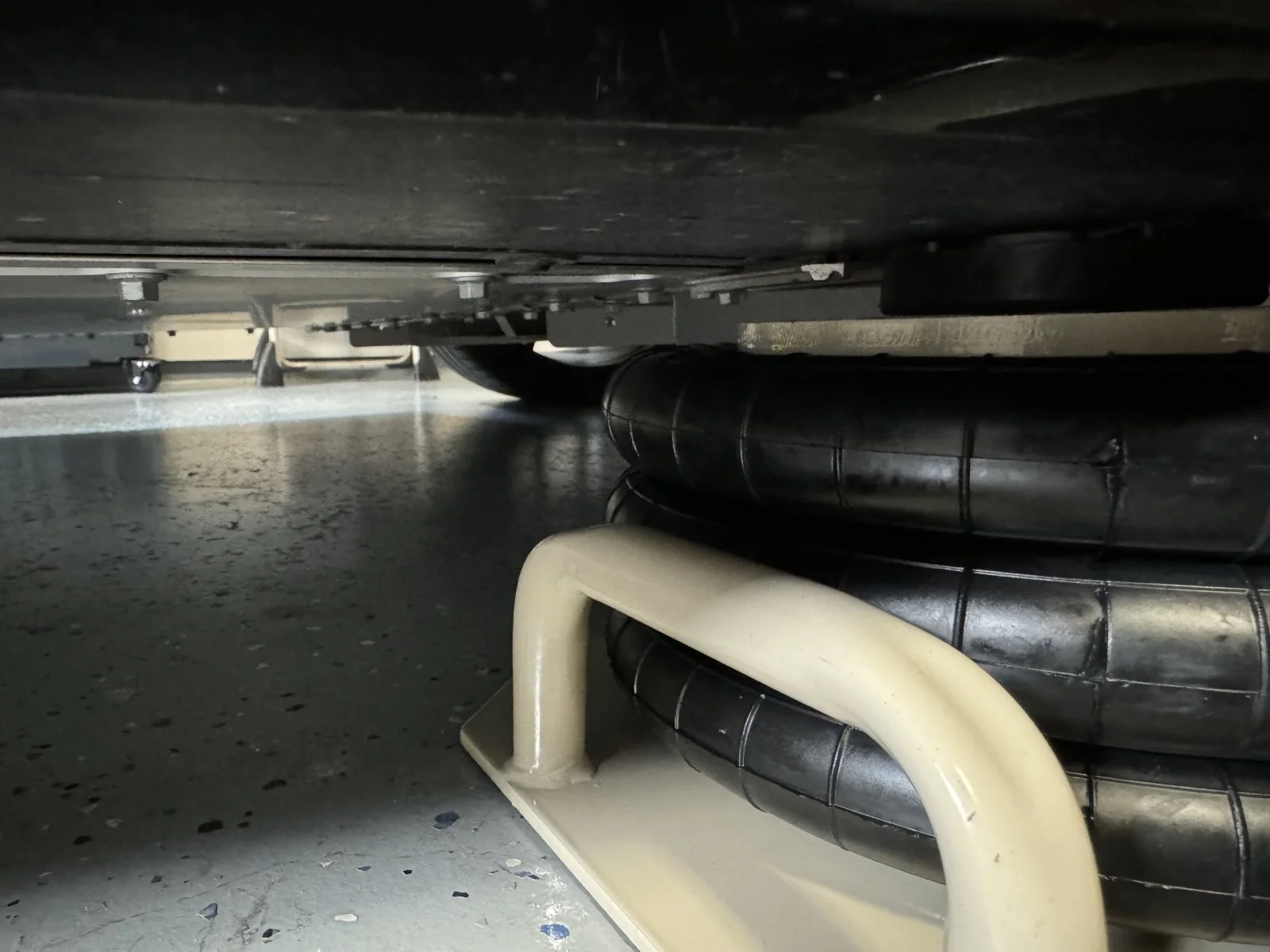

So this Vevor air bag jack in its deflated position is about an eighth of an inch to a quarter of an inch too tall to fit under the Emira jack pad. I think the three-quarter of an inch rubber pad that comes on the airbag jack could be replaced for a shorter rubber pad so it would work.

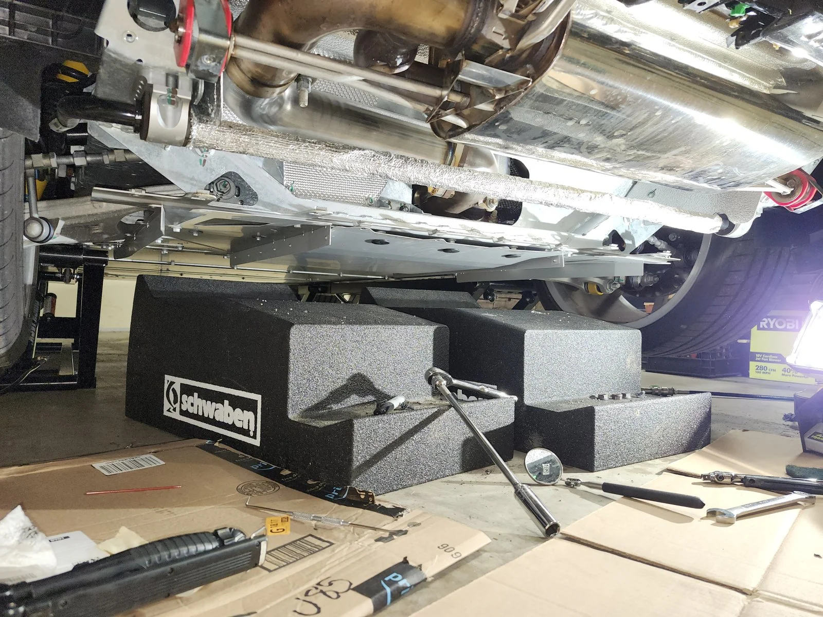

I went ahead and purchased some Race Ramps Scale Ramps. I figured they would be handy for jacking low ground clearance vehicles and make it easier to drive up on my scales.
Where did you get these schwaben? Can’t seem to find them.
Sold by ECS Tuning:
Mine are the 67" low-profile set. When spaced properly for the front wheels, the Emira has clearance between the ramps and front splitter.
Nothing special about Schwaben name. They are probably identical construction to RaceRamps or Megan Racing products as well.

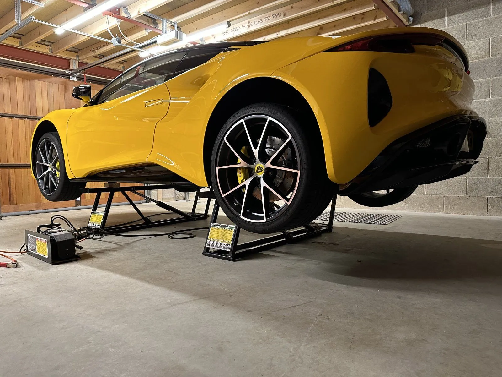

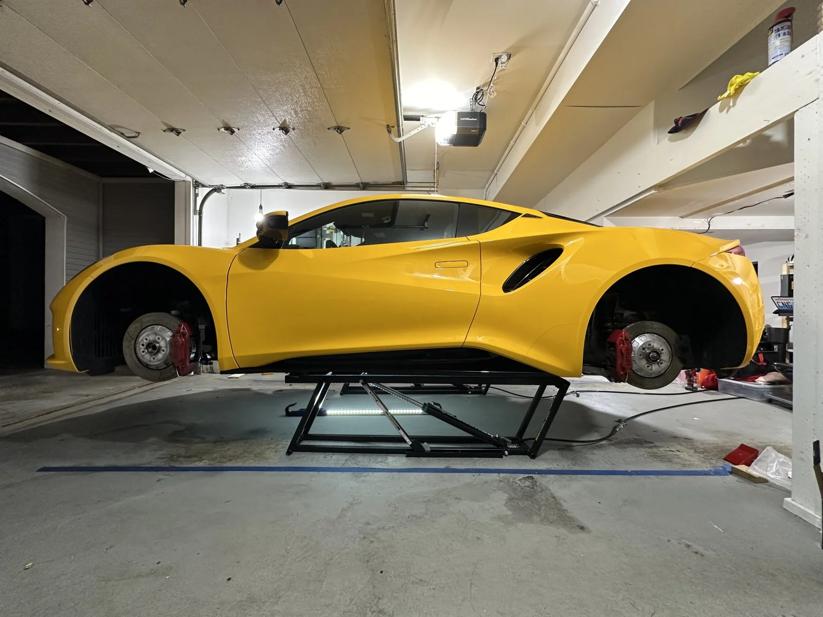

I have just read through this whole thread…. What is the consensus for the best fitting Quickjack in regards to the Emira. Buy the 5000TL or the 5000TLX? Or is there another brand that seems to fit even better for the Emira?
are you buying ONLY for Emira use, or for other cars as well?

Check out https://quickjack.com/support/measuring-guide/
You can measure the points where you want to lift the Maserati/AMG/Emira and see if there's one particular size that fits all three without being too long and interfering with tires.
Yeah, thanks for the response. I did go with the QuickJack 5000TLX. Did the Maserati and the Mercedes easily with it. Just waiting on the Emira to arrive….. 😊

I had plenty of room to install the jack stands when I lifted my Emira. I didn't need to extend the air bag jack to its maximum height to slide my jack stands under the identified lift points. My jack stands were at the lowest setting, so I didn't need a full extension. I used the air bag jack under the frame rail since I wanted my jack stands set under the lift pads.
