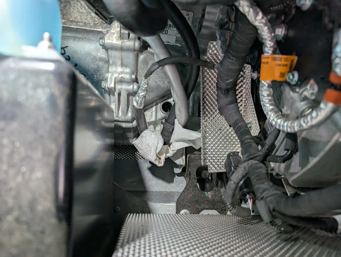

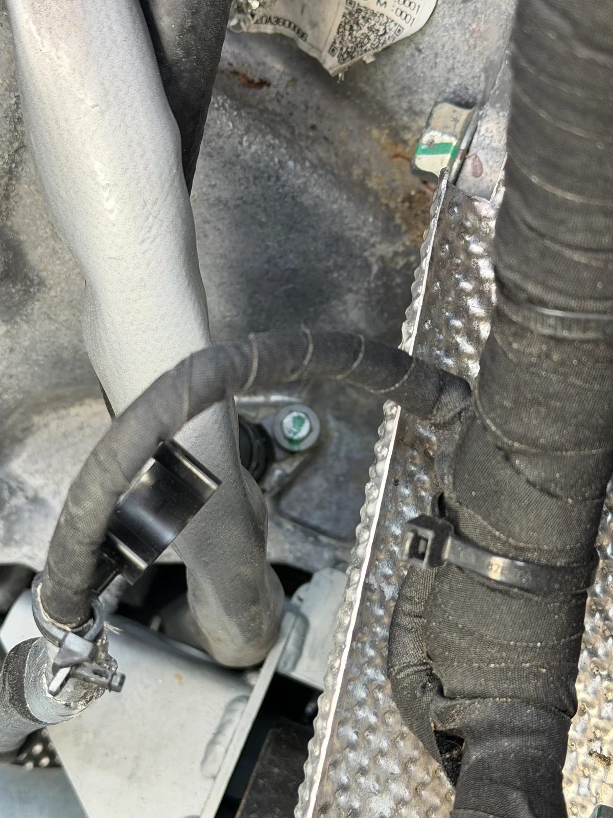

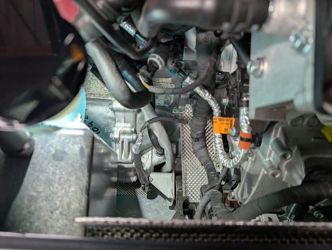

-Locate the transmission fluid fill hole/ transmission oil cooler return fitting
-Thoroughly clean the area around the fitting as to make sure no debris will fall in when you remove the fitting
-Can of brake cleaner seemed to do the trick in short order, blasting the debris away from the fitting
-Using a 9mm socket and long reach extention, unfasten the bolt holding the fitting to the transmission

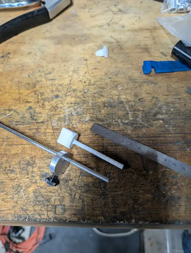

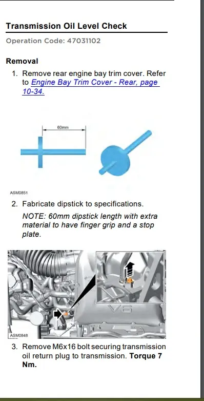

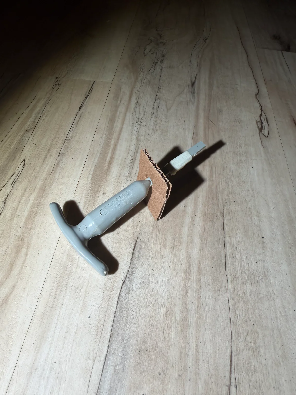

-Fabricate a dipstick as per the service manual
-With your fabricated dipstick, carefully insert the dipstick and assess your currently fluid level
-Make note of this fluid level as you will be refilling your new fluid to this level
-Once you're done recording your fluid level, take a shop rag or towel and cover/plug the hole to prevent debris or foreign objects from falling in while you work on draining the fluid from underneath.

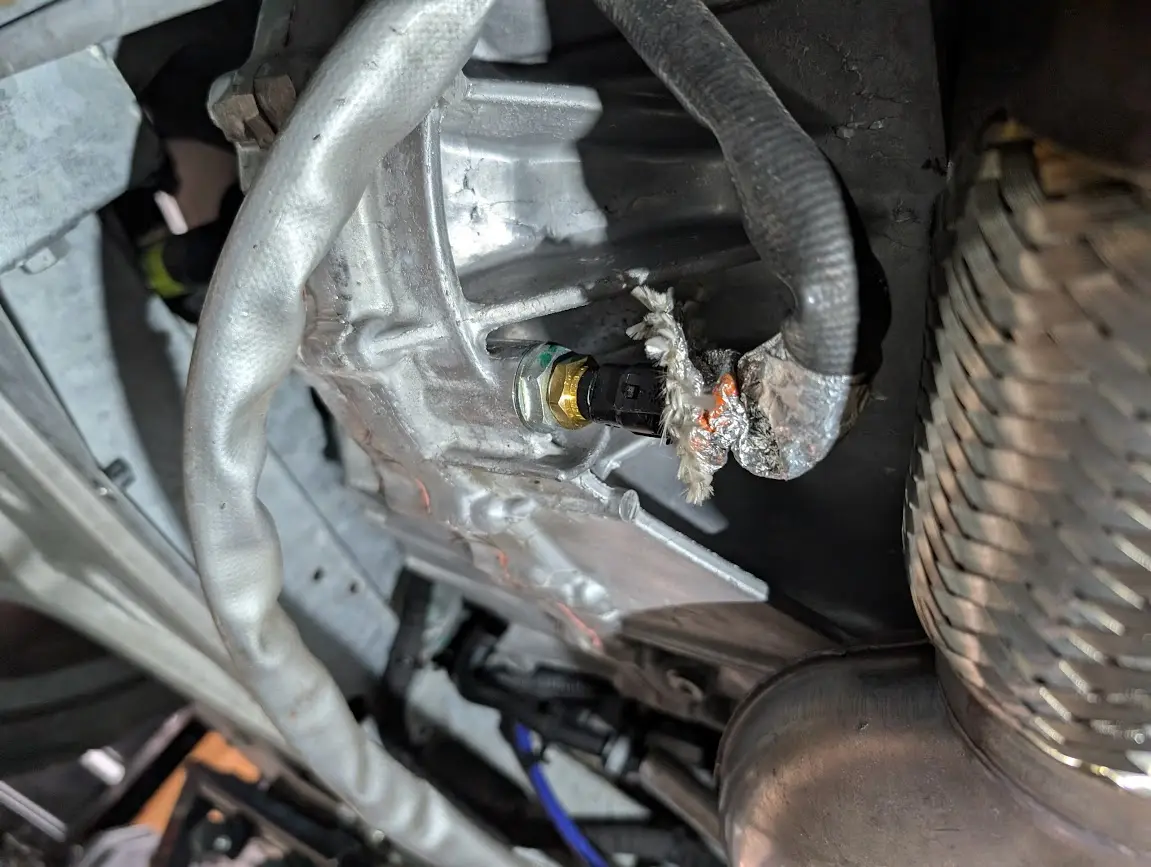

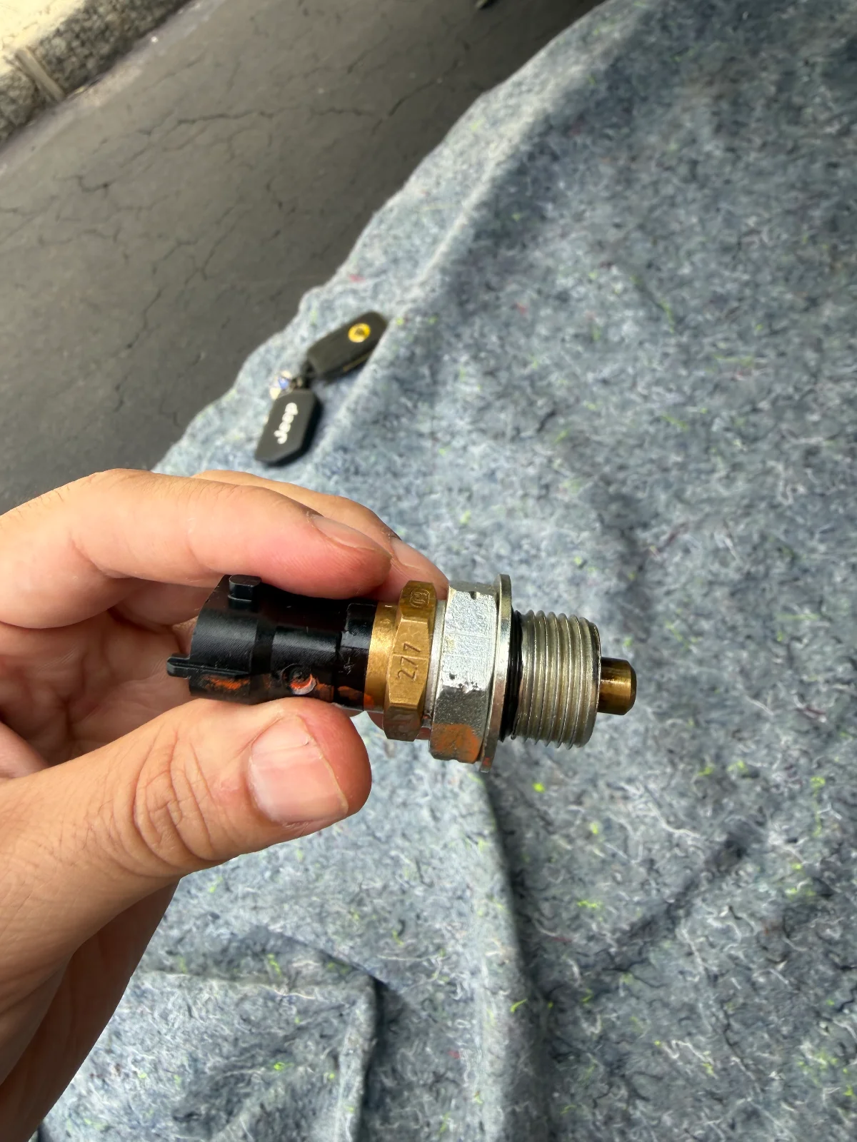

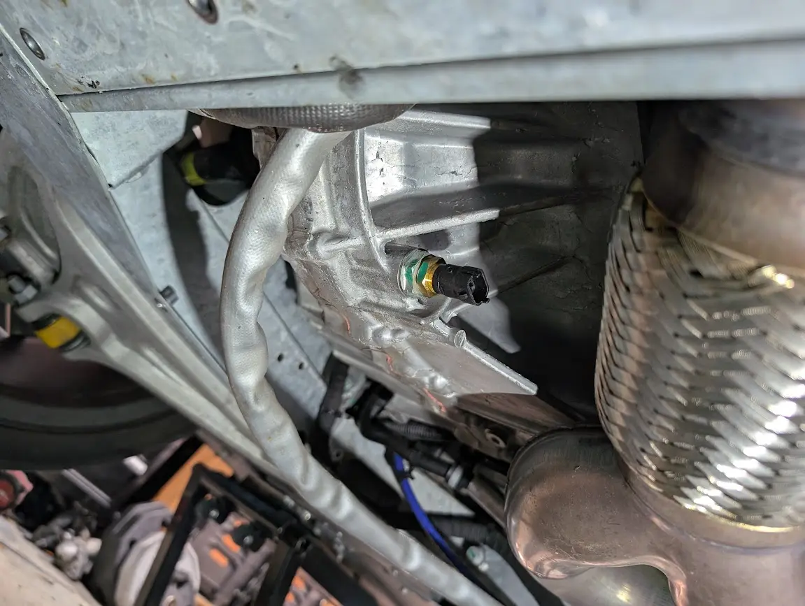

-Look for the transmission fluid temperature sensor (it'll be the lowest point on the transmission case with an insulated line running to it

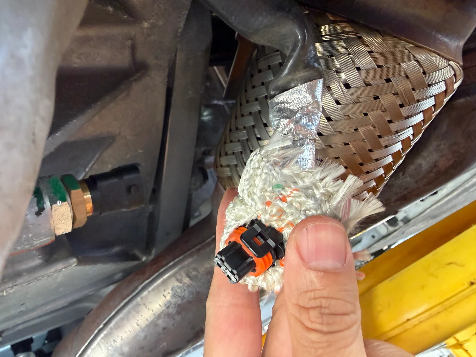

-Clip the zip tie that's holding the heat wrap around the sensor and slowly peel back the heat shielding to expose the connector
-Positively unlatch the connector and remove the connector from the temperature sensor

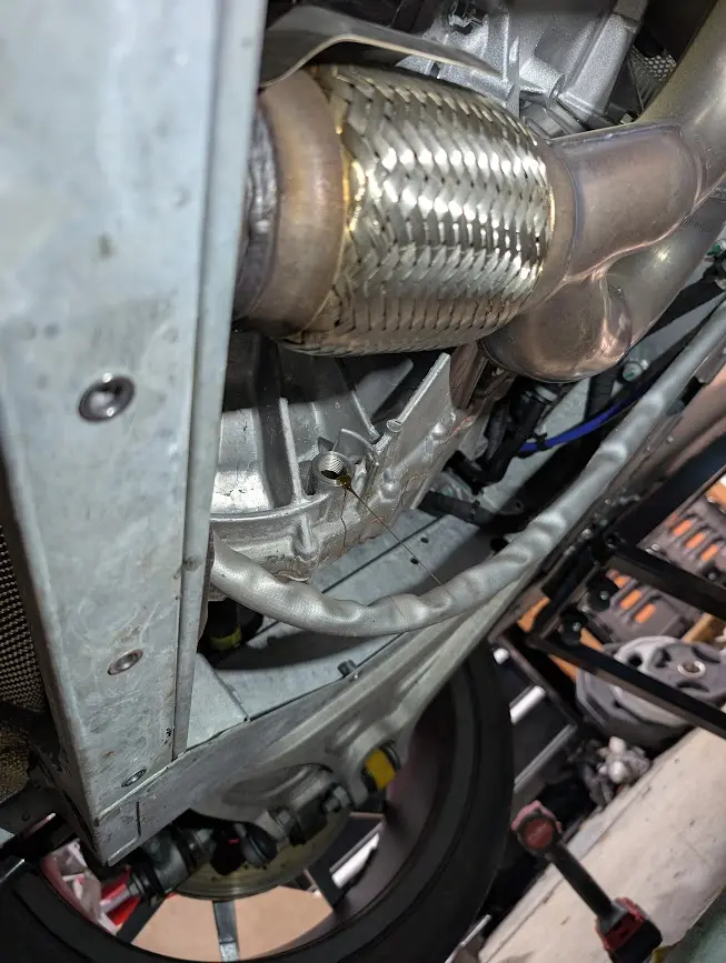

-Now using a box end 22mm wrench, unfasten the fitting from the transmission case. Make sure to have a fuid catch pan ready as fluid will start to drip as you unscrew the fitting
-Take care to retain the sealing rubber washer - mine showed no deterioration, so I elected to re-use. Best practice is always to replace, but I've reused them with no issue - YMMV.
-Tip: Use the fitting as flow control with your hand so that it doesn't splash onto the exhaust Y-pipe or drain too quickly, making a mess
-Drain all the old fluid out. I got about 3QTS out.
-Once all the fluid has been drained, put the fitting back in and snug tight - I couldn't find the torque value, but I usually just do this by feel anyway.
-Reconnect the connector to the temperature sensor. Ensure the latch is positively connected.
-Pull the heat shielding back in place and use a zip tie to secure as it were from the factory

-Lube the oil cooler return fitting's o-ring with some trans fluid and re-install the fitting to the transmission
-Snug the 9mm bolt

What did you use to make that dipstick?
Thanks so much. I've been hoping someone would do this also.
I used a motorcycle fork oil level tool (since I had one already), but a forum member here printed one out for me as well.
