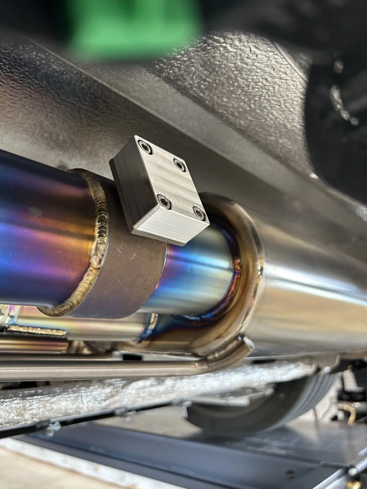

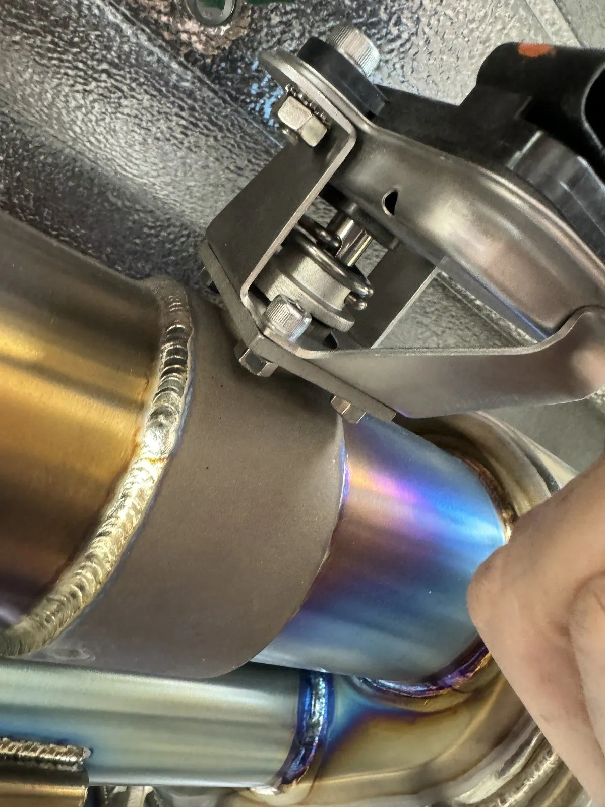

Here is a pic of the valve and spring BEFORE I rotated it.
So far, so good. No CEL and it opens and closes correctly.
Thanks. So just to be clear. Did you rotate it 180 degrees so the L shaped part at the end of the spring is still on the actuator side, or invert it so the L shaped part is on the valve side?

I rotated it. (Not flipped it). I'll get another photo when I install the gasket I just ordered.

Rotating the spring stops the error from occuring, but also restricts the range of movement on the valve such that it does not close properly, which in my case causes the valve to rattle between 1200-2000RPM (although nobody else I've spoken to has had the rattling issue).

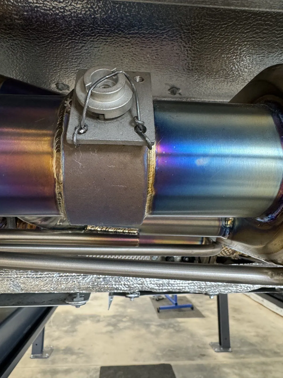

Found a possible valve delete module after the third try. No CELs yet !!
Wired the valve fully open (clockwise) used some Montana bailing wire for the test.
Sound is amazing. Hopefully, this is the solution.
@Aerie Now I need a non-valved, non-silenced Ti setup.:)
The valve "chatter" is eliminated also
I think that the sound is so much better with the valve wide open. If I understand it correctly, the stock setup only fully opens the valve at 4000rpm.
