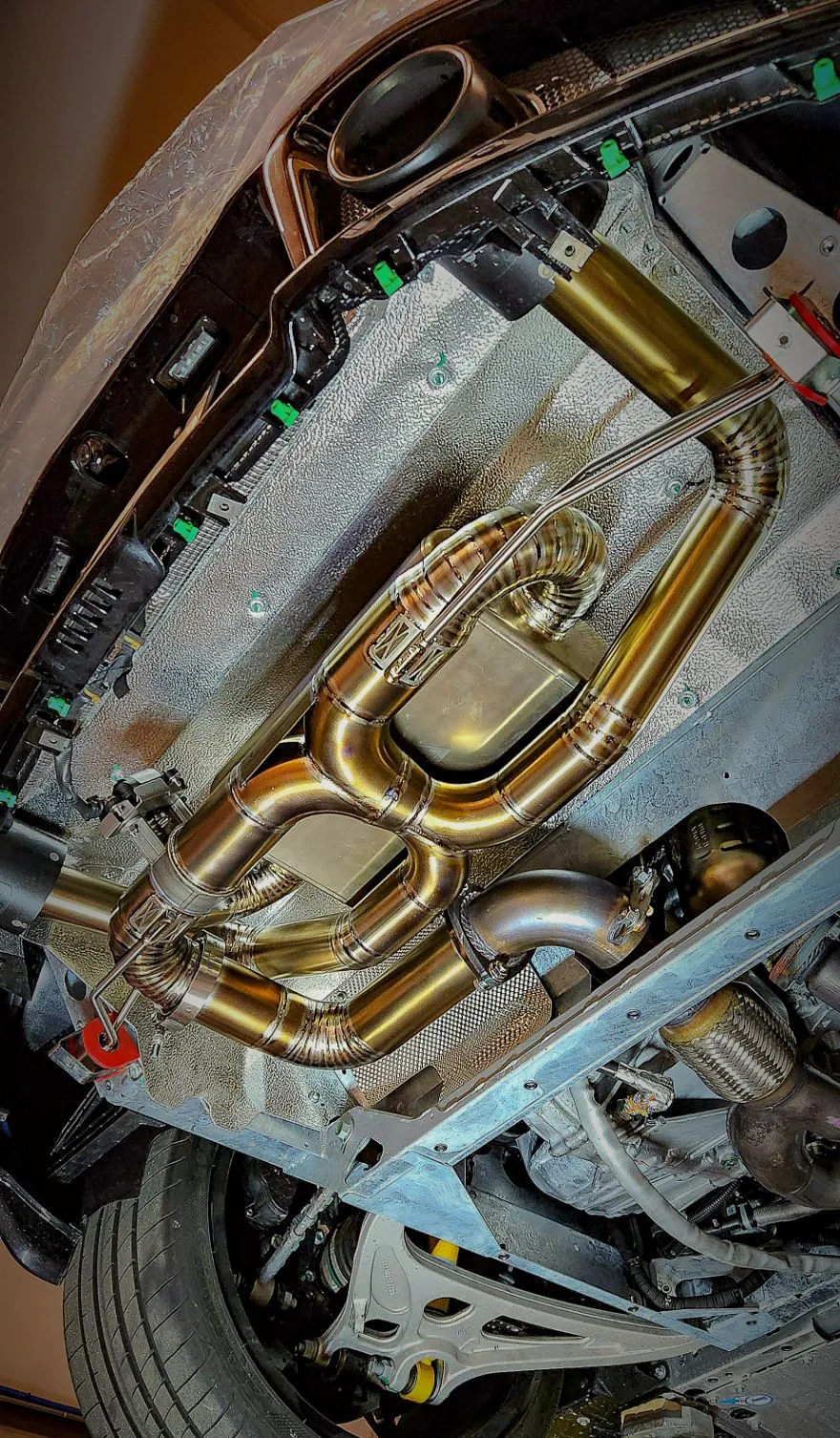

Aerie Ti Emira exhaust installation
I installed my Larini exhaust, refitted the valve controller, and no issues, no codes. I understood the recalibration May be needed on certain systems if the valve positioning does not match OEM, which would make sense. Many users fitted Mikltek valve controller w/o need to recalibrate.

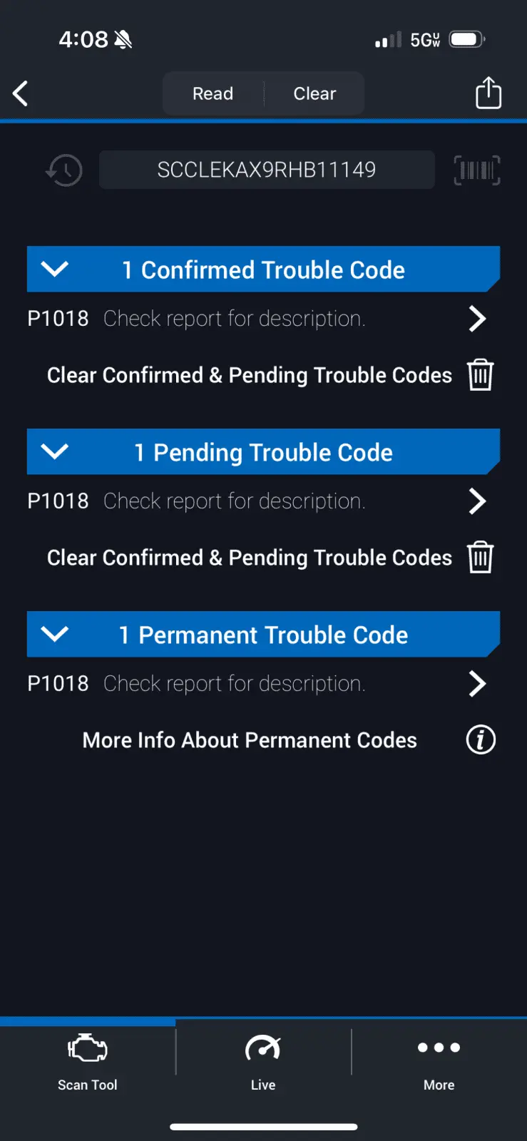

I'm sure that can clean the code when you change the O2 sensor with the P1081 DTC code showing up, but now the case is jump to is to P1018 so is getting confused.
If now showing the P1018 DTC code means the installation of the exhaust valve did not correct position, you have to try to reinstall as 1:1 same position as removed from the OEM, or run the Lotus diagnostic tool to program the valve to re-calibrate the position to perfect open and close.

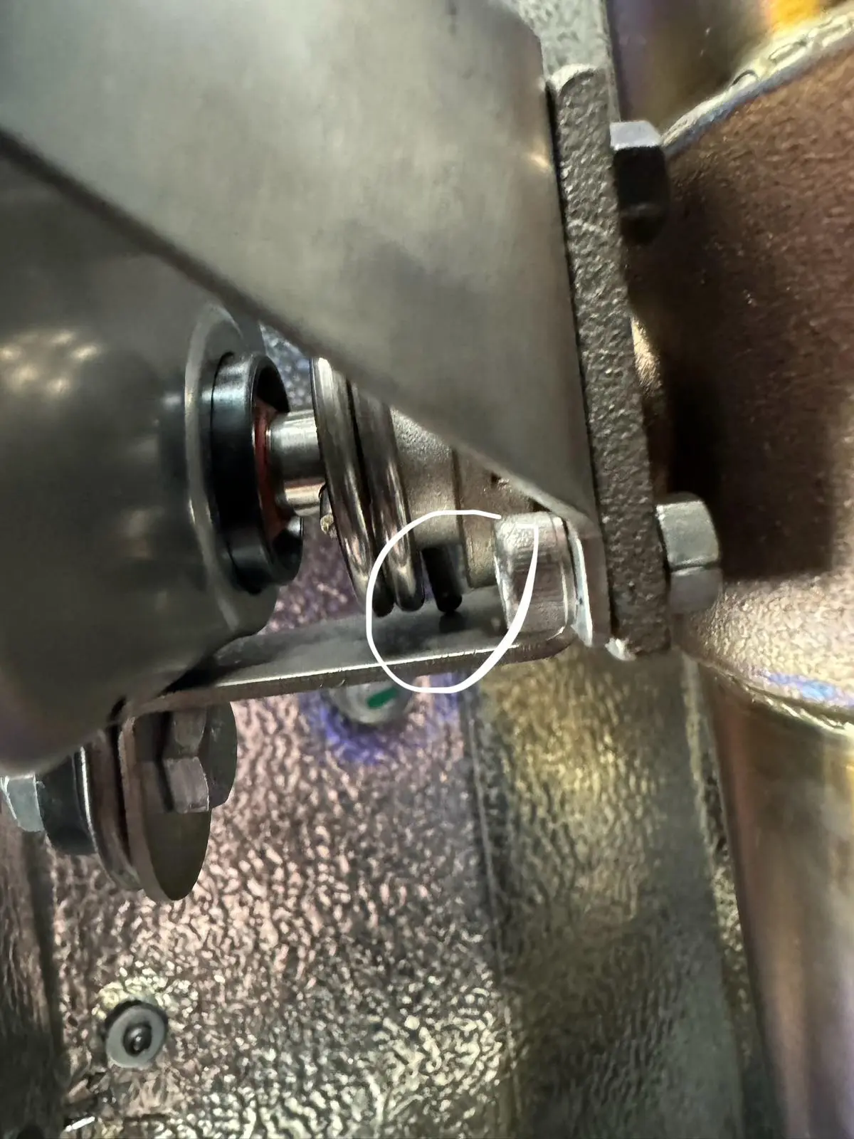

Update.
Diffuser removed.
Valve spring rotated. Did a couple of short runs - no CEL yet. Needs longer runs to be sure.

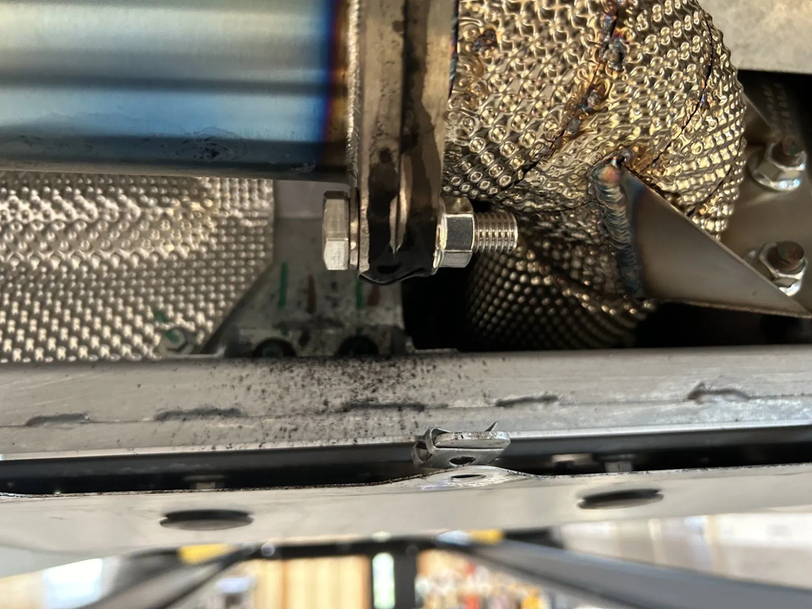

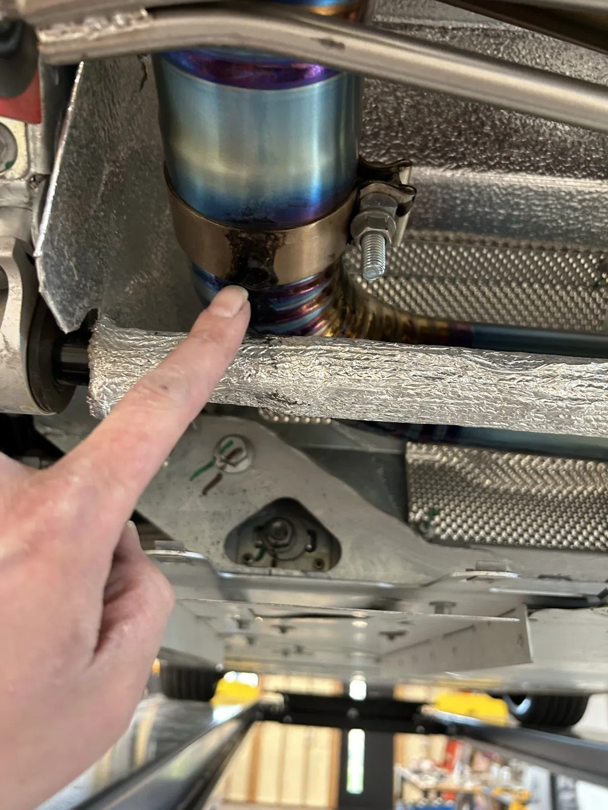

Noticed two problems on the Aerie exhaust. See pics below.
Top pic is the joint between the y-pipe and 3rd cat bypass tube. @Aerie - do I need a gasket between these flanges? If so, do you have a part number please?
Bottom pic is the joint between the bypass tube and muffler. Not sure how to fix this - @Aerie any ideas?
Mine has the exact same leaks too.
Can you post a photo of the exact orientation you have the spring in now?
I don't get a CEL with my spring rotated either, but it stops the valve from fully closing as the spring hits the housing as shown here. You'll notice there is no difference between sport and tour modes with the spring rotated if its the same as this orientation....

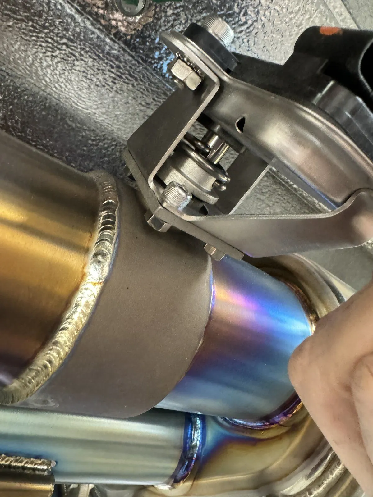

Here is a pic of the valve and spring BEFORE I rotated it.
So far, so good. No CEL and it opens and closes correctly.

Does anyone know what exhaust gasket I need to stop the leak at the flange?
