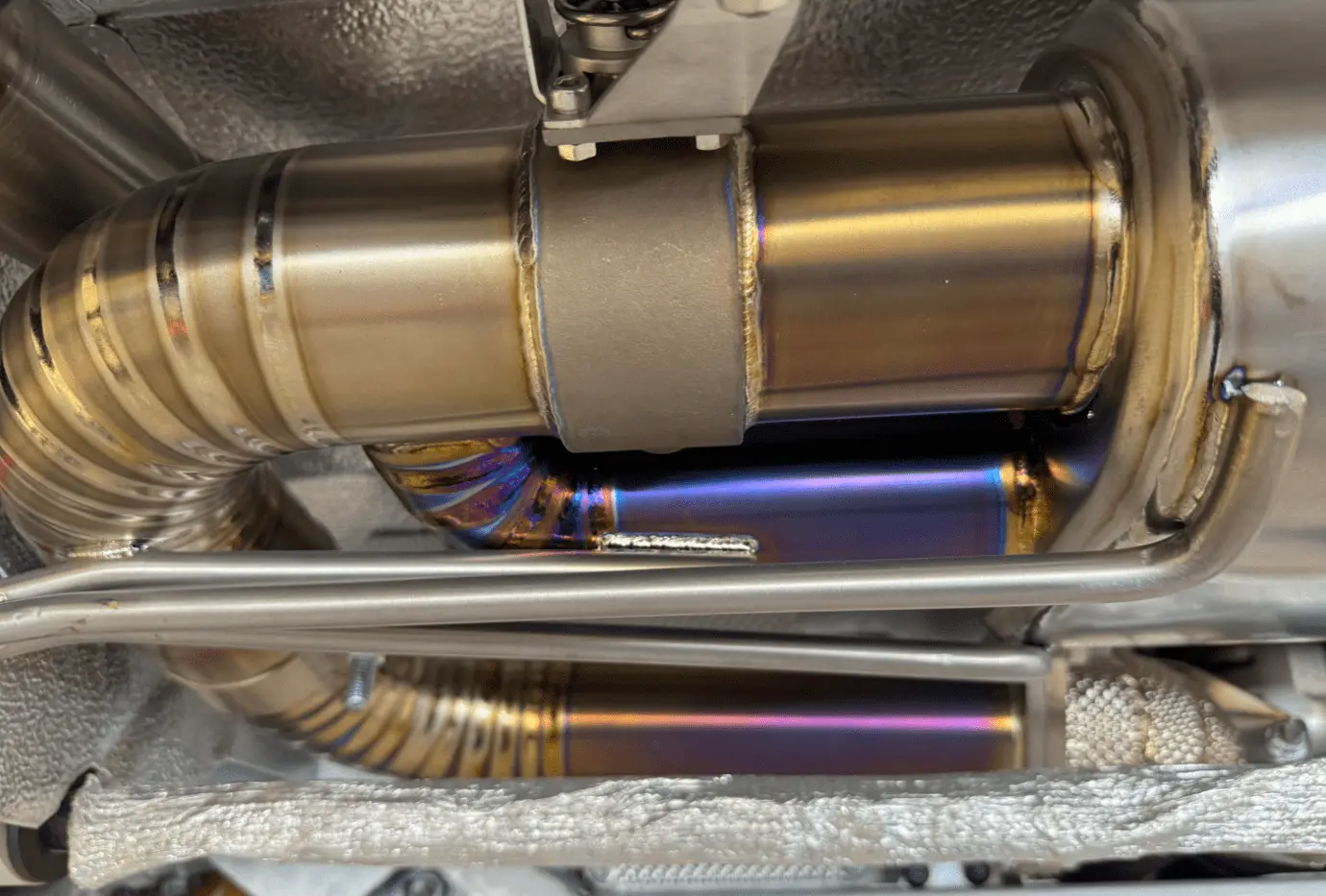

Aerie Ti Emira exhaust installation

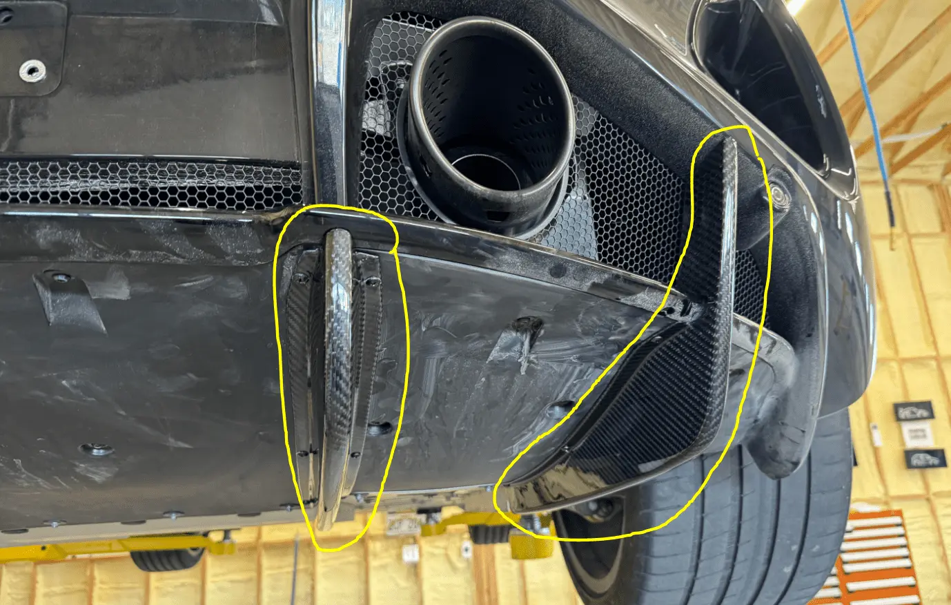

Here is a pic of the Carbon diffusers:
Not really my thing, I thought I was buying a carbon diffuser and not screw on covers.
Not Aeries fault.

Yes , the new batch of titanium exhaust system de-cat down pipes will be fit OEM y-pipe .
Will those of us with your previous batch exhaust be able to mate up correctly to the titanium Y pipe when it comes out?

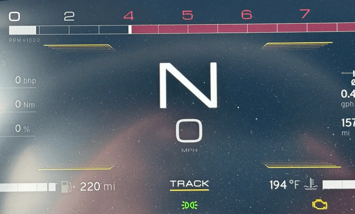

Reader came today and so did the "Reduced Acceleration Mode".
Note the CEL below and the redline at 4krpm
Reader reports:
1 Confirmed Trouble Code P1081 No description available
1 Pending Trouble Code P1081 No description available
1 Permanent Trouble Code P1081 No description available
Clearing resets the Confirmed and Pending codes CEL and restores the redline.

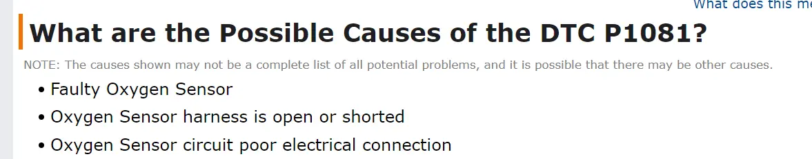

Anyone know what "P1081" is? It could be a CO2 sensor or stuck valve servo (sometimes they need recalibrating).
Anyway, this is quickly becoming a PITA. When the car randomly throws this CEL you're stuck in low accel mode until you clear it.
I feel for you. This does not make me happy.
If we can find out what P1081 code is we can probably solve this.
Google thinks is the Oxygen sensor (see below).
So, probably needs recalibrating for the Aerie exhaust.
