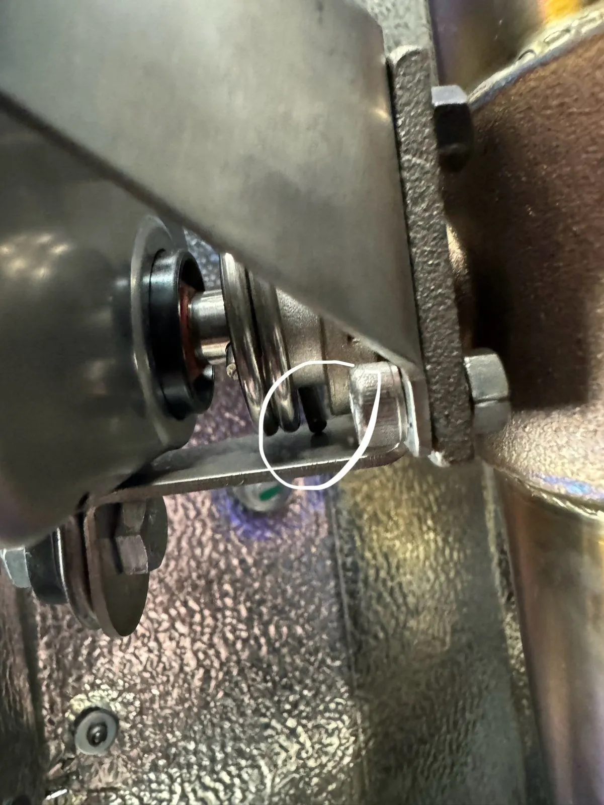

I did have a P102007 error code related to the valve and consequently went into reduced engine mode. This was corrected by rotating 180 degrees the spring that connects the OEM valve controller to the valve itself.

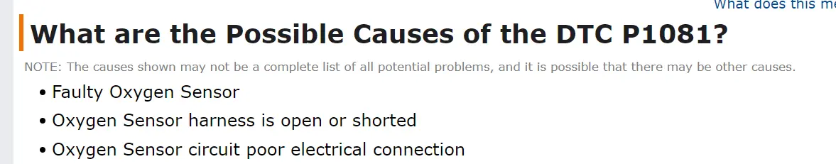

Google thinks is the Oxygen sensor (see below).
So, probably needs recalibrating for the Aerie exhaust.
The Ox sensors (2) are mounted on the Y-pipes. the Aerie exhaust has a 3rd cat bypass, so much less back pressure.

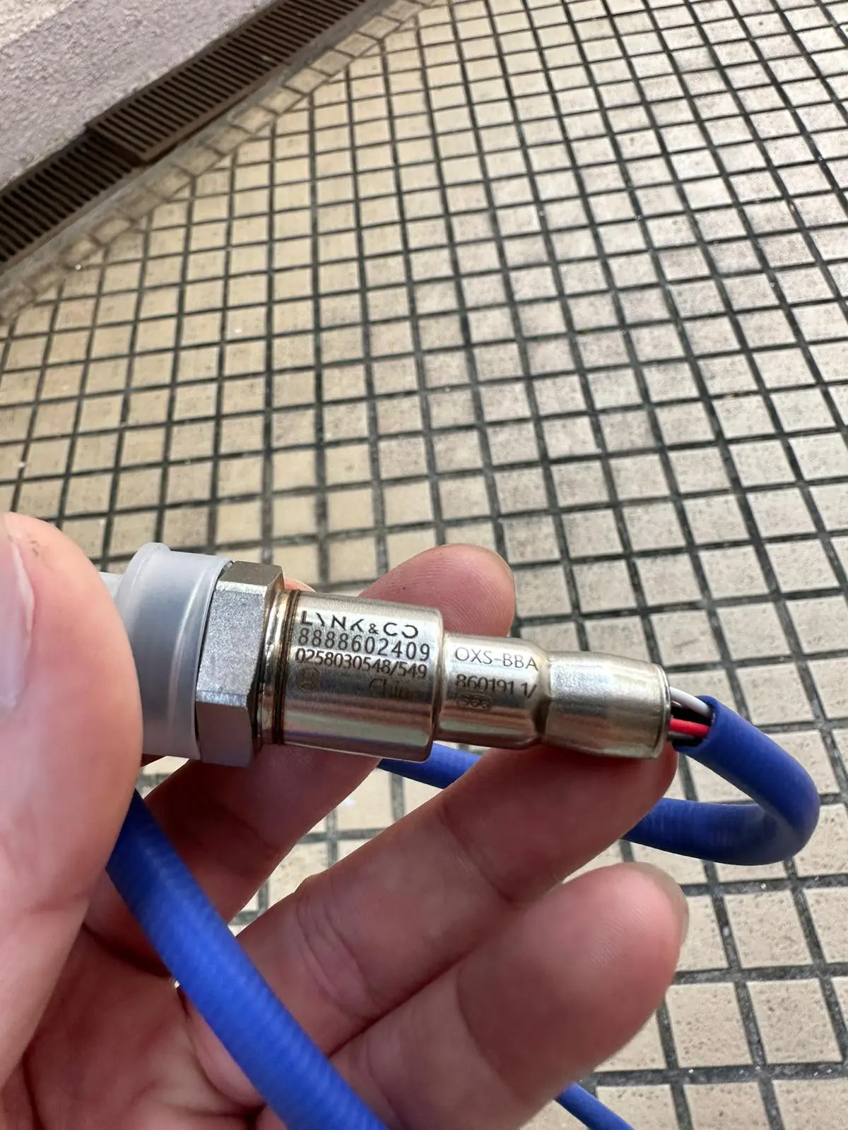

probably the O2 sensor harness was damaged by installation, we had the same DTC code P1081 with our Emira V6 customers. Since the new Emira OEM O2 sensor comes with 6 harnesses (Lynk & co) China-made products, maybe the quality is not strong, when the sensor is reinstalled will easily break, lucky we changed to a new one the problem was solved.
Link&Co 8888602409.
0258030548/549 China
The OEM O2 sensor in here the dealer are selling USD630 is extremely expensive just for one sensor, but currently we still have one set of Emira O2 sensor can send you as free for replacement , let me know if you want it . @beardp

Yep. Especially as if I rotate the spring 180 degrees so it actually restricts the valve from closing properly, I don’t get the fault anymore.
Aerie appear to be saying in this thread that changing the O2 sensor has fixed the issue for other V6 customers, but it’s not clear if everyone is getting the same fault code.

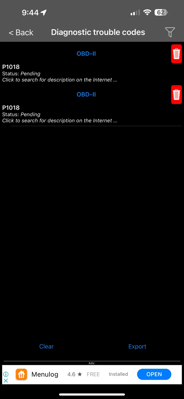

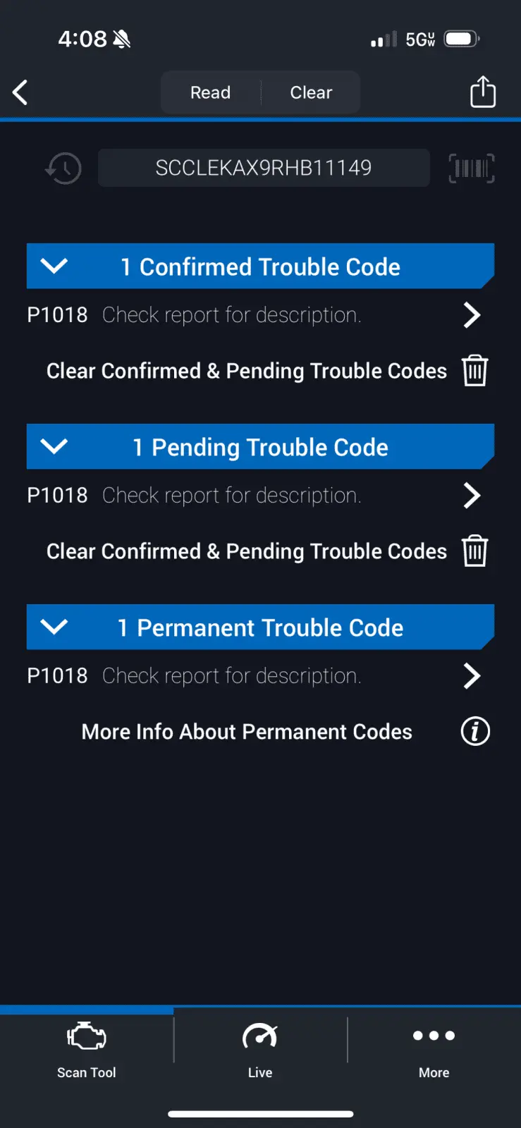

Mine is definetly P1018 and only seems to happen in sport mode, and only if the spring is oriented so the valve can fully open and close. When flipped 180 degrees so the spring hits the housing and restricts the valve from closing, I don’t get the error which is way less me to believe it’s the actuator moving through a different range that’s throwing the code.
I’ll be back at my local dealership/workshop tomorrow to drop the stock exhaust off so I’ll try and find out exactly what the P1018 code is while I’m there.

Yes P1018
Thanks for clarifying.
I spoke to a few other people with different exhausts last night who have had the same issue. Recalibrating the valve controller apparently fixes it. It’s caused by the range of movement being slightly different.

Just be aware rotating the spring stops the valve from closing properly so it will be louder on cold start, etc.

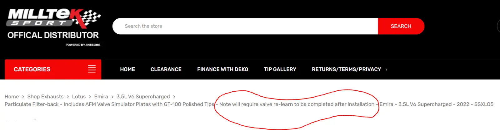

Was looking for exhaust valve eliminators and came across this (below) on the Milltek site:
"Note will require valve re-learn to be completed after installation"

You may still have to get the actuator recalibrated even after putting the stock exhaust back on now as its alignment will have changed from running past its original calibration.
Might get lucky, but don’t be surprised if you still get a CEL after returning to stock.
Sorry for the bad news but wanted to let you know before spending the time returning to stock in case it changes things for you. Might be better off getting the Milltek valve controller and just leaving the valve open until you go for your next service.
