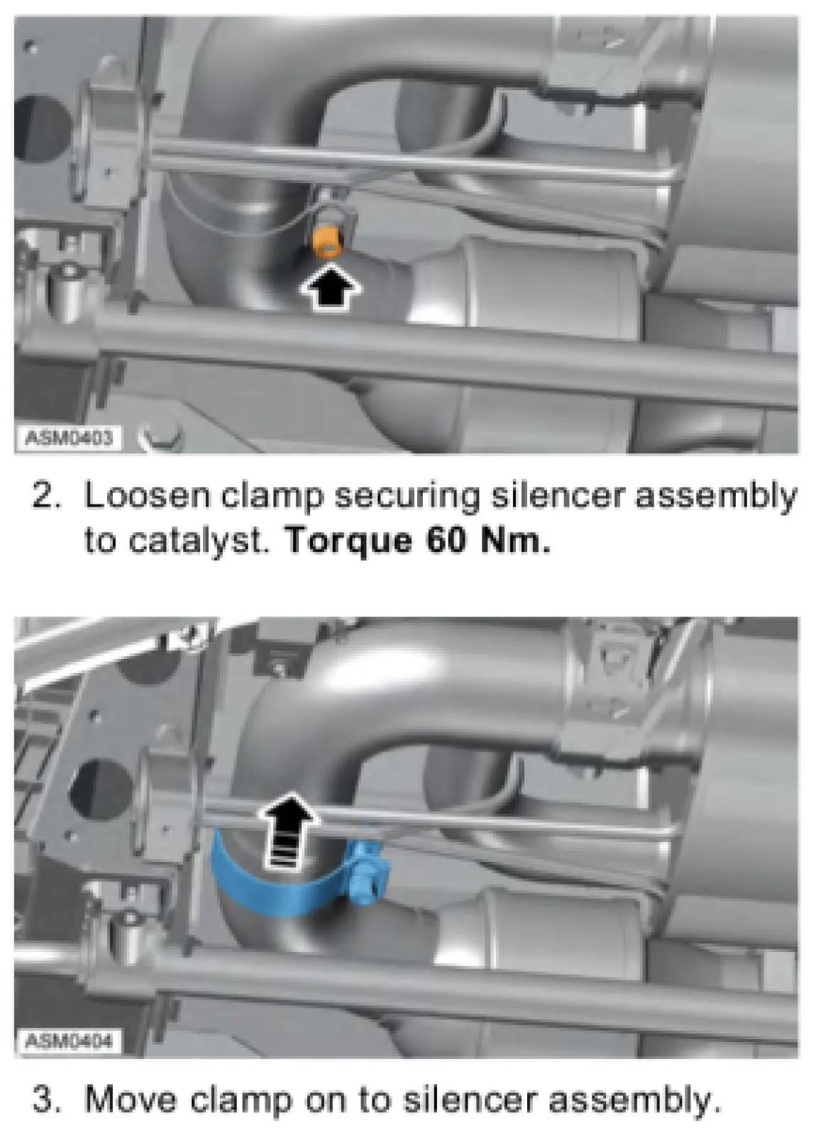

To those who've replaced the factory exhaust with the Aerie, how do you get the factory exhaust loose? Lotus tack-welded the clamp onto the muffler so I can't remove it to spread the joints on the pipe to slide it off the cat. I've loosened the nut tightening the clamp, but of course I can't move the clamp. I've removed the bolts holding the muffler on the ends, but I can't move the muffler off the cat. I thought I'd be able to slide the muffler towards the back to clear the cat pipe, then back and down, but it looks like everything is just slightly in the way, which is typical of a British sports car. Nothing wants to cooperate.
Is there a trick to this that I'm not seeing? Any tips on how to remove and reinstall the @Aerie?
Instruction send to you email, please check and let me know if you need anything assist.
Okay here's the problem right here, where it says "move clamp onto silencer assembly". The clamp on mine is situated so the bolt is on the bottom, and the top of the clamp is tack-welded to the pipe. I'm going to have to see if I can figure out a way to break that tack weld.
Loosen the clamp. Detach cat from silencer. Wiggle cat into y pipe a little. Rotate it down into the area between the rear sway bar and whatever that bulkhead is. Then pull it free.

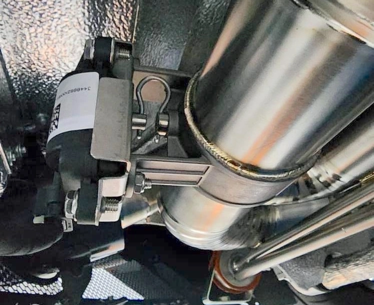

In Video 2 you can see the valve controller is moving the loop spring that connects the controller to the valve, so the controller is working. Maybe the valve inside the exhaust tube broke?

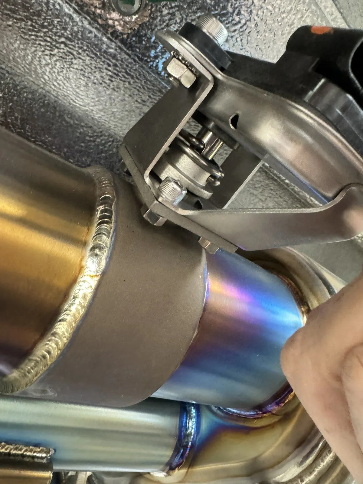

The I4 Ti Exhaust I have, has a different spring arrangement to this. I got a CEL first time I gave it some power/revs. It does seem I’m getting a faint rattle at tickover, noticed on left pipe.
The spring/coupling I have, would cause the valve and motor to be offset 90degs, but this new coupling aligns them. 90degs difference between the couplings is a big difference. New spring, no other change? Seems a bit strange to me.
