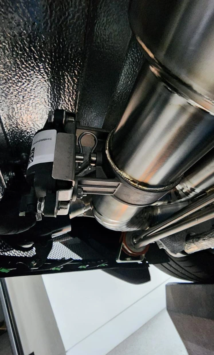

I noticed that the valve servo was the same brand as the one on my 992 GT3 (that I recently straight cat-backed). I borrowed one and installed it in place of the servo on the Emira. So far it is working perfectly - no CELs yet.

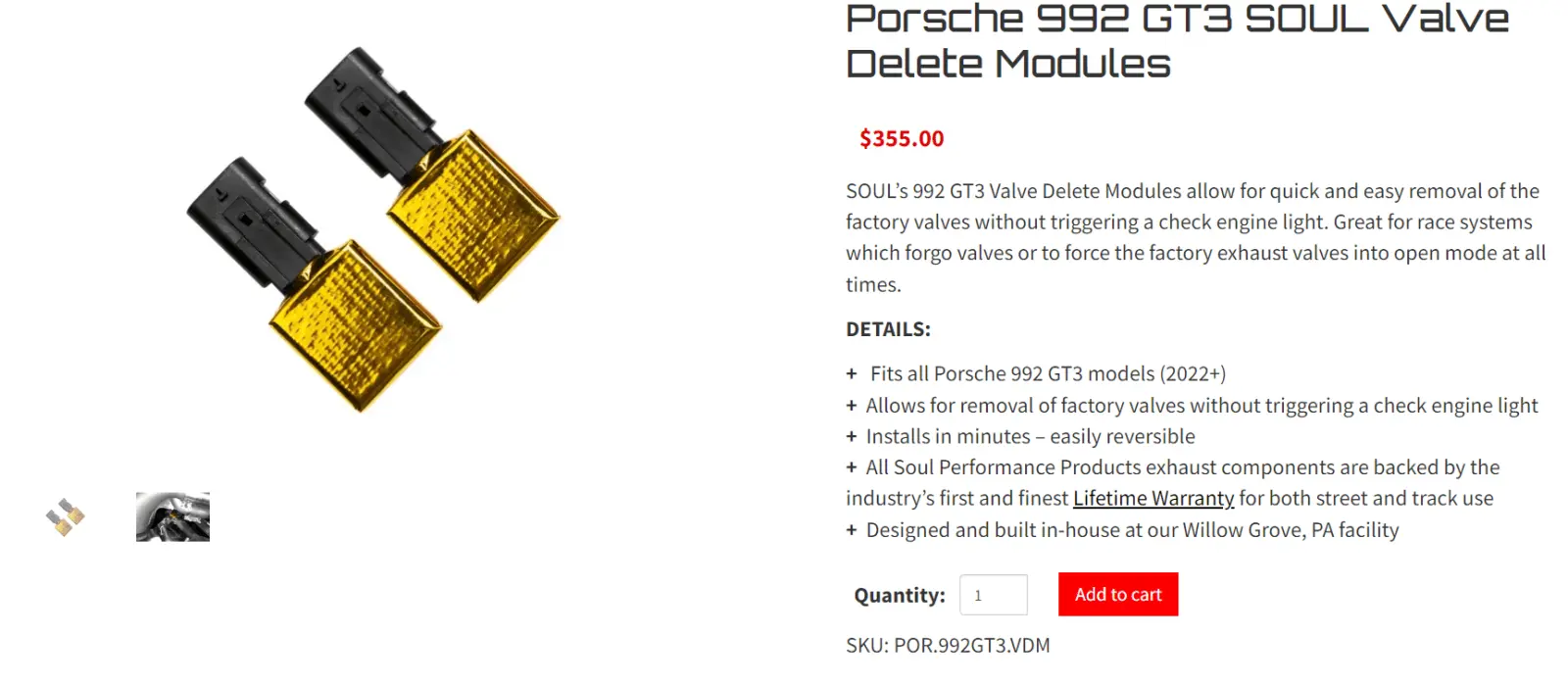

Here is a link to the modules: A GT3 uses two, so they are sold in pairs.
Valve Delete Modules
Could you give an update once you've run this for a while? If this works, I'm going to order them as well and probably get a local exhaust shop to remove the valve altogether and weld in a titanium section to the Aerie exhaust.

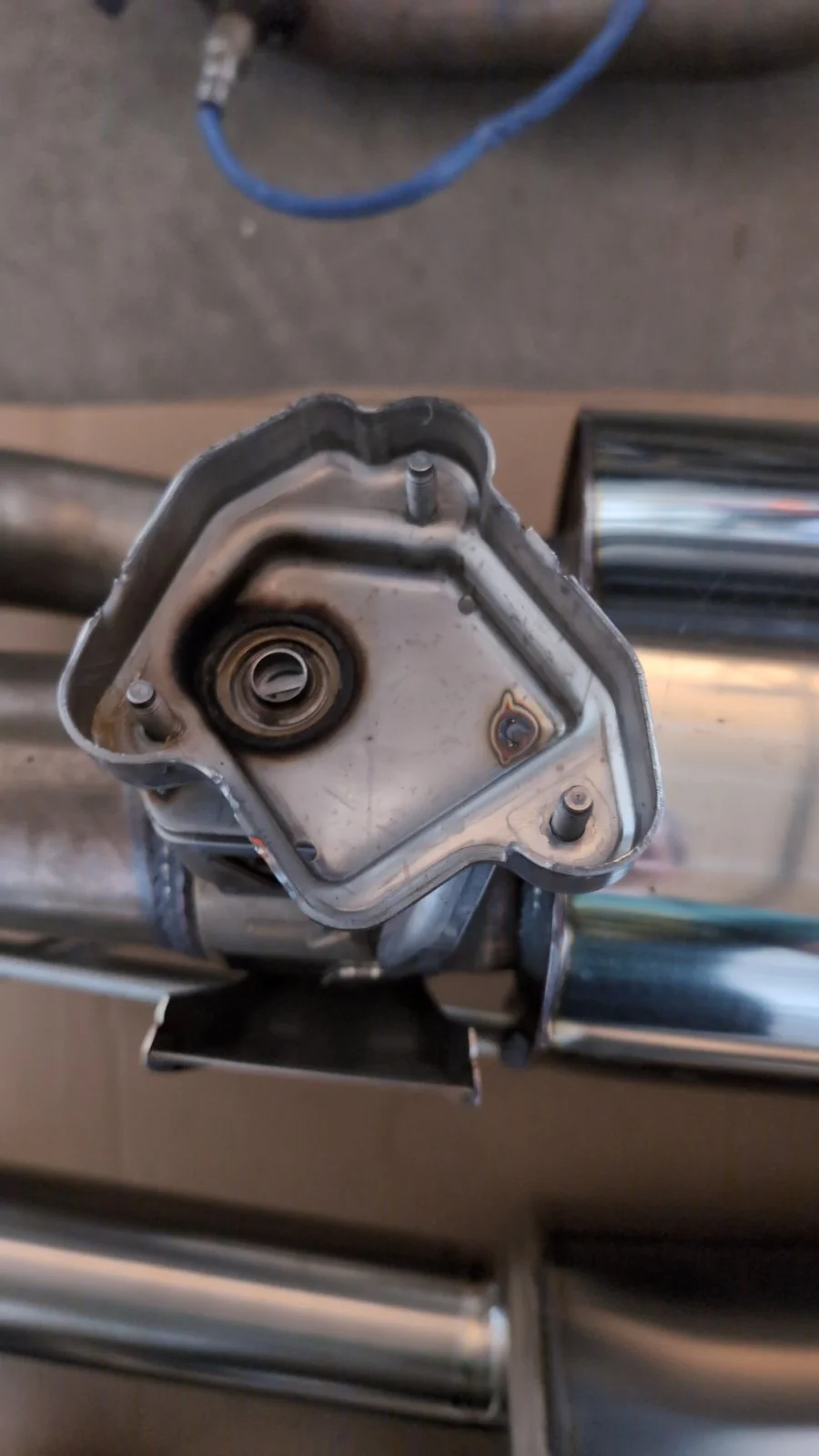

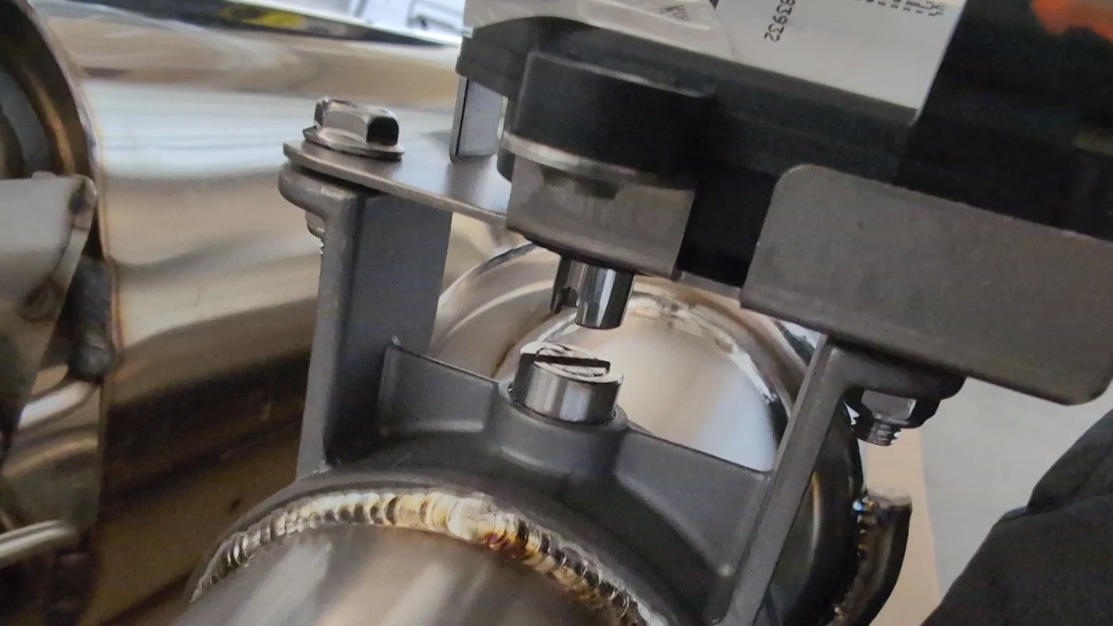

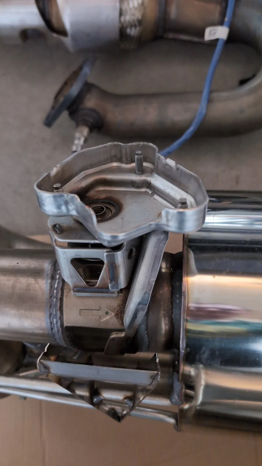

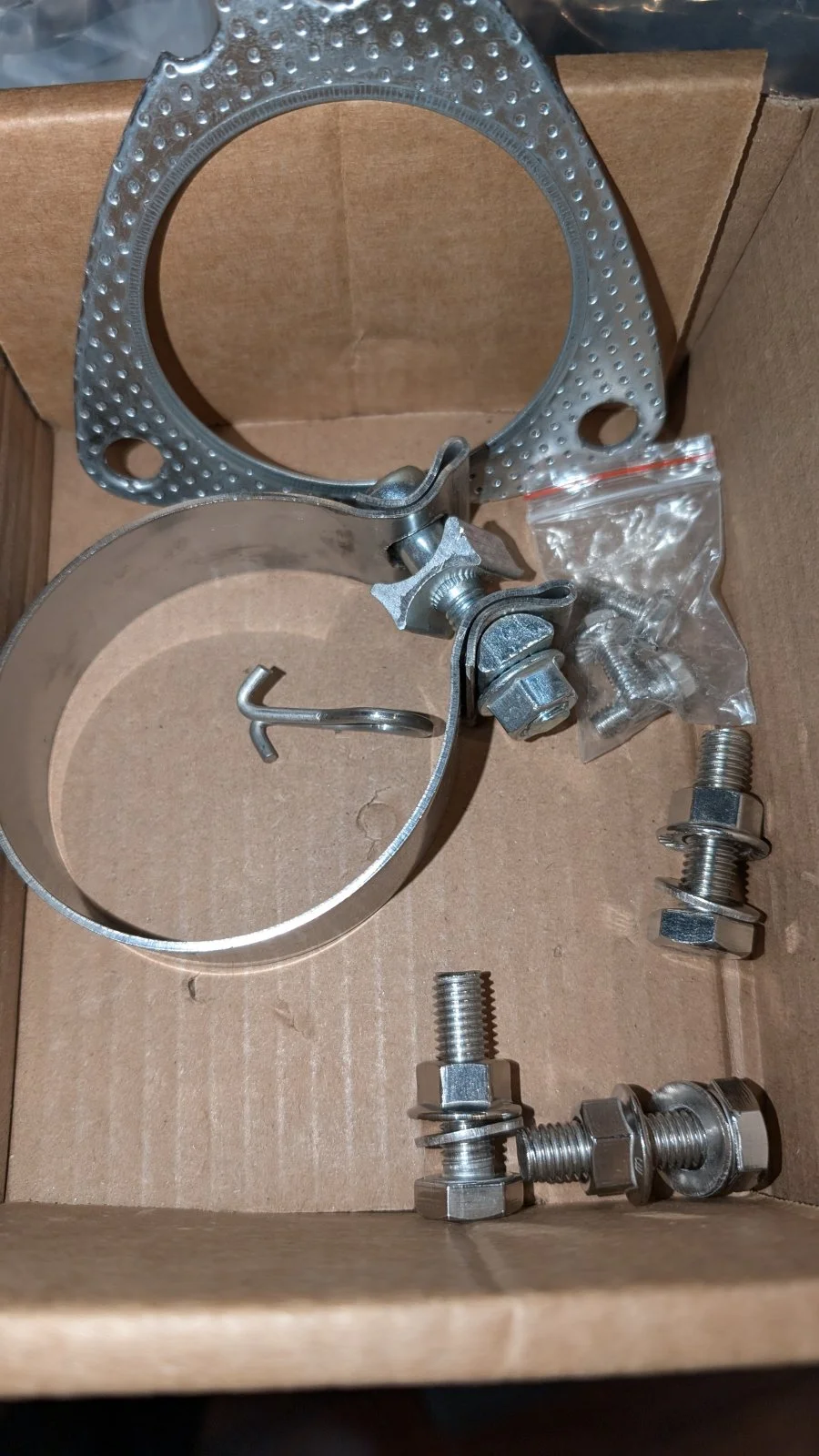

Trying to install the exhaust. The actuator doesn't meet up with the valve.
Stock
@Aerie

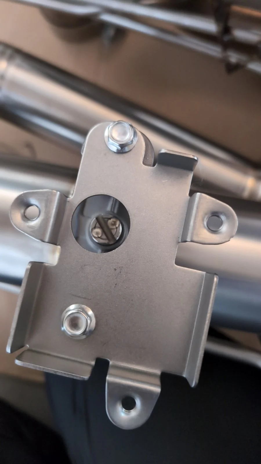

And the parts that came with it
The spring clip in the middle doesn't match the valve or the actuator.
Stock
@Aerie
And the parts that came with itView attachment 49477
Please check the instructions picture for the spring install , this is a new version valve control to avoid the engine light and code issues and that was tested in few costumes Emira V6 fit and working perfectly .
