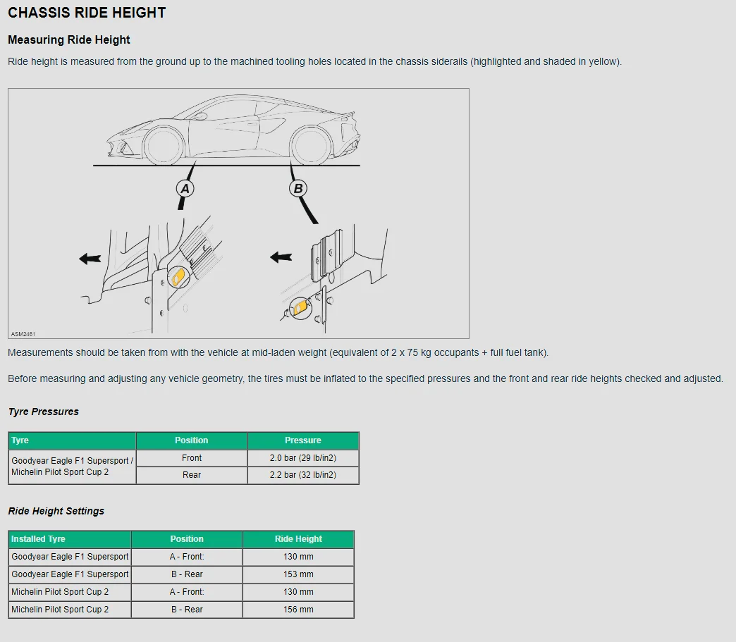

You can easily go 20mm lower for B-roads with no problems. Maybe not the best way to measure it but my touring V6 standard ride height from ground to wheel arch with no people was:
Factory height in mm
Front left 720
Front right 716
Rear left 707
Rear right 711
Left and right as you're sitting in car.
Would be interested to hear what other peoples meaurements are. Mine are consistently uneven measured that way at all ride heights

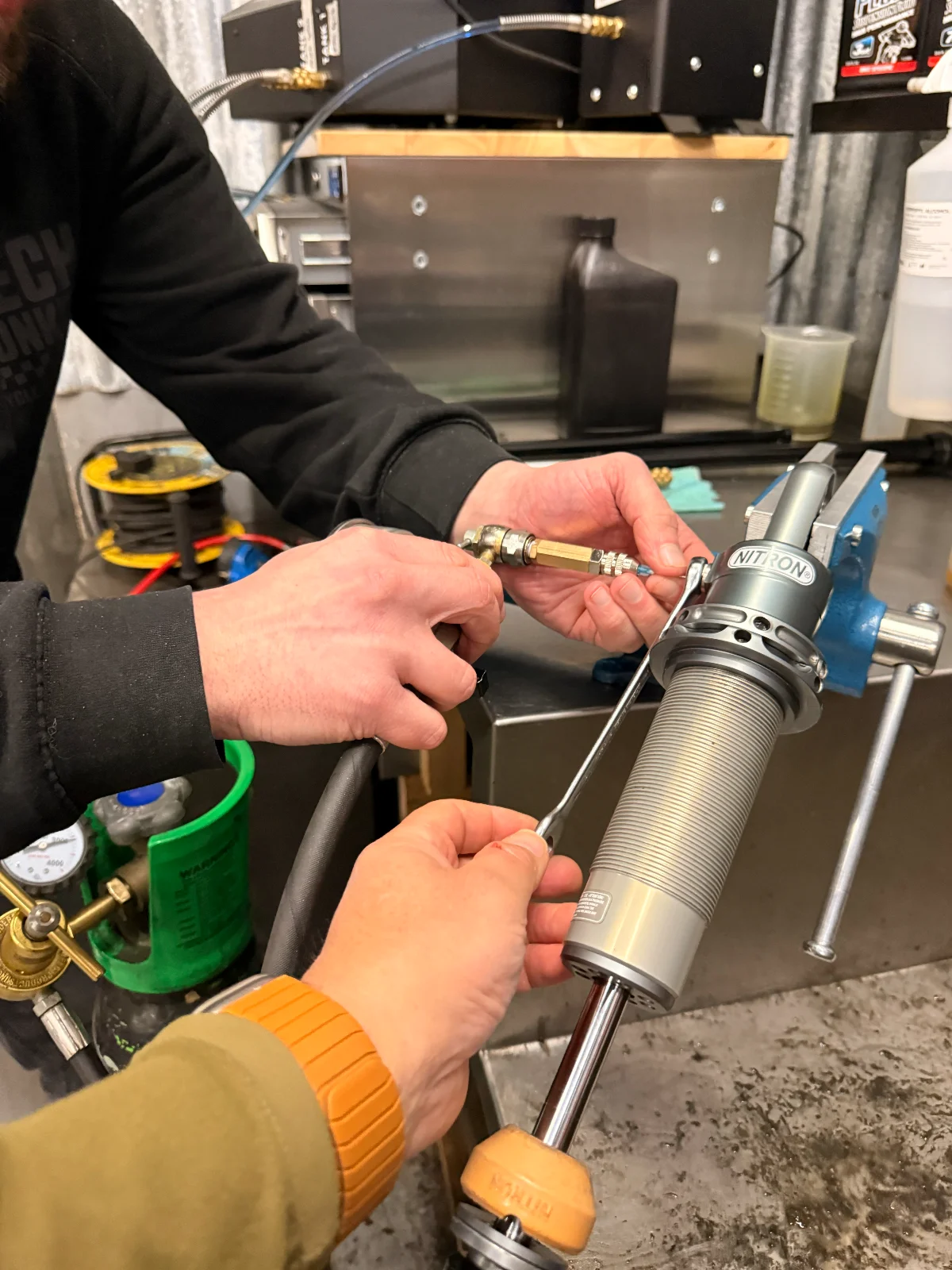

We have been selling Nitron for Lotus and other applications for nearly 20yrs. We brought the brand here. Nitron's owner is a friend of mine and set up their North American operation 5 miles up the road from us based on my recommendation. Their facility (previous KTM's) is really fitted to support our market and has already helped us on several applications, including a Ferrari F348 that needed some specialized help. We fit their first FAL onto an Emira.
Nitron asked us to help get an Emira i4 for them to fit. See below. This was the first in the world that they had completed. This was done here in CA. The dampers are still assembled in England but the local R&D helps sort out quality/firment issues. They remain a small company and these Emiras are low volume car that many manufacturers won't support as the financial return is not always certain.
My advice to all forum members is to work with a Nitron Dealer when you can. Especially those of us who regularily work directly with Nitron and have fitted the dampers. The English auto industry is notoriously poor at communications - but your US Dealer should be able to help!
