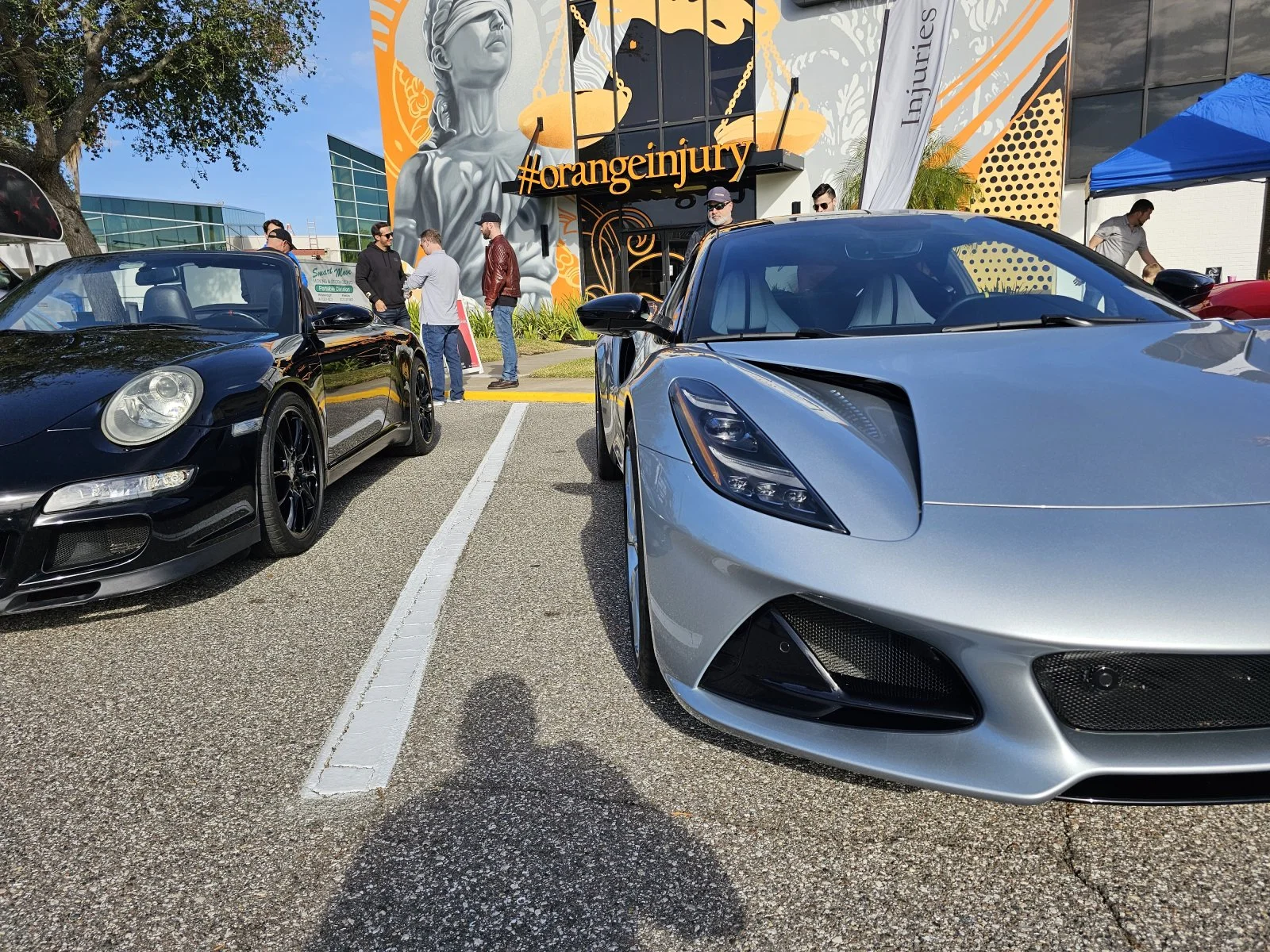

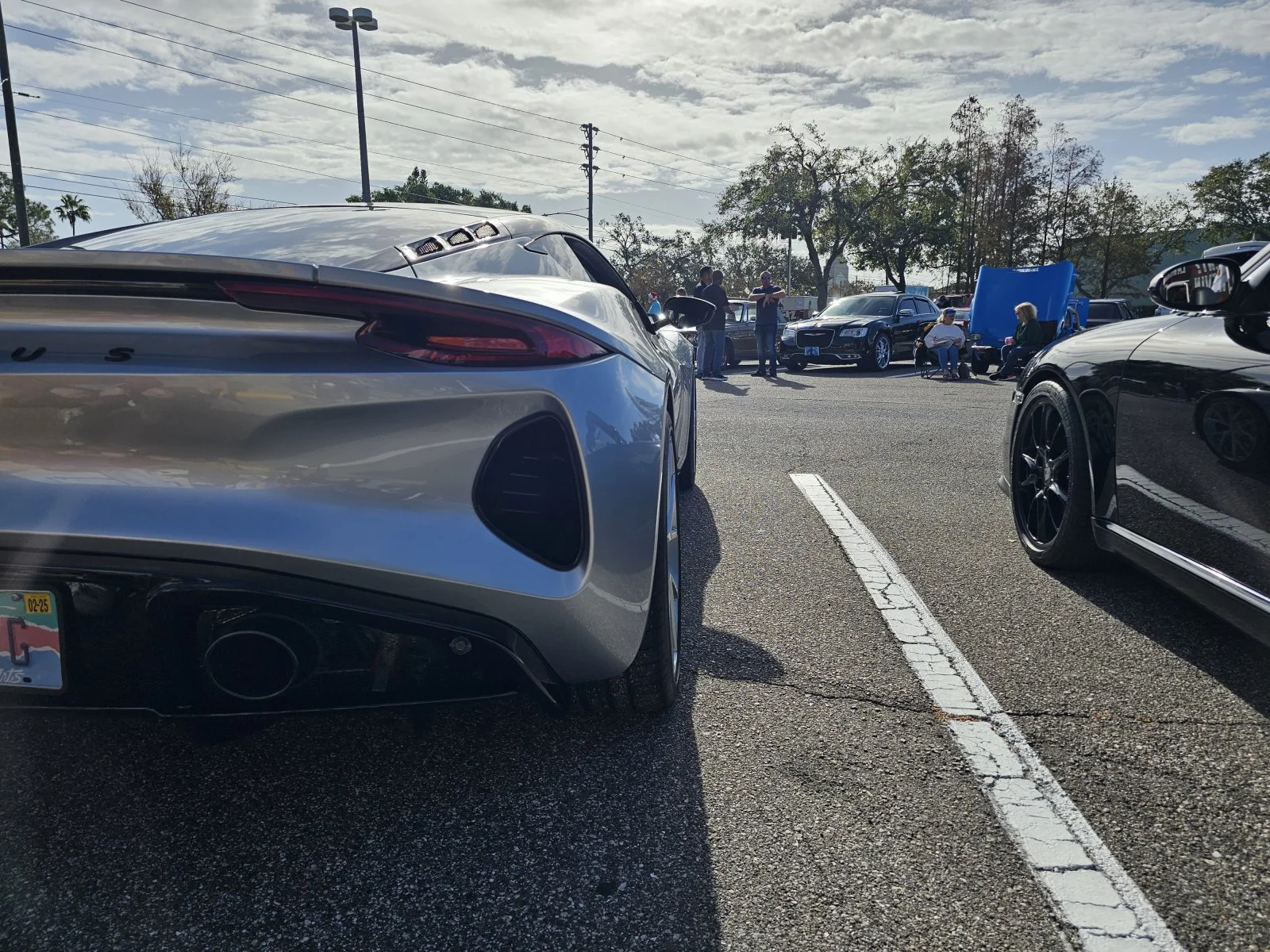

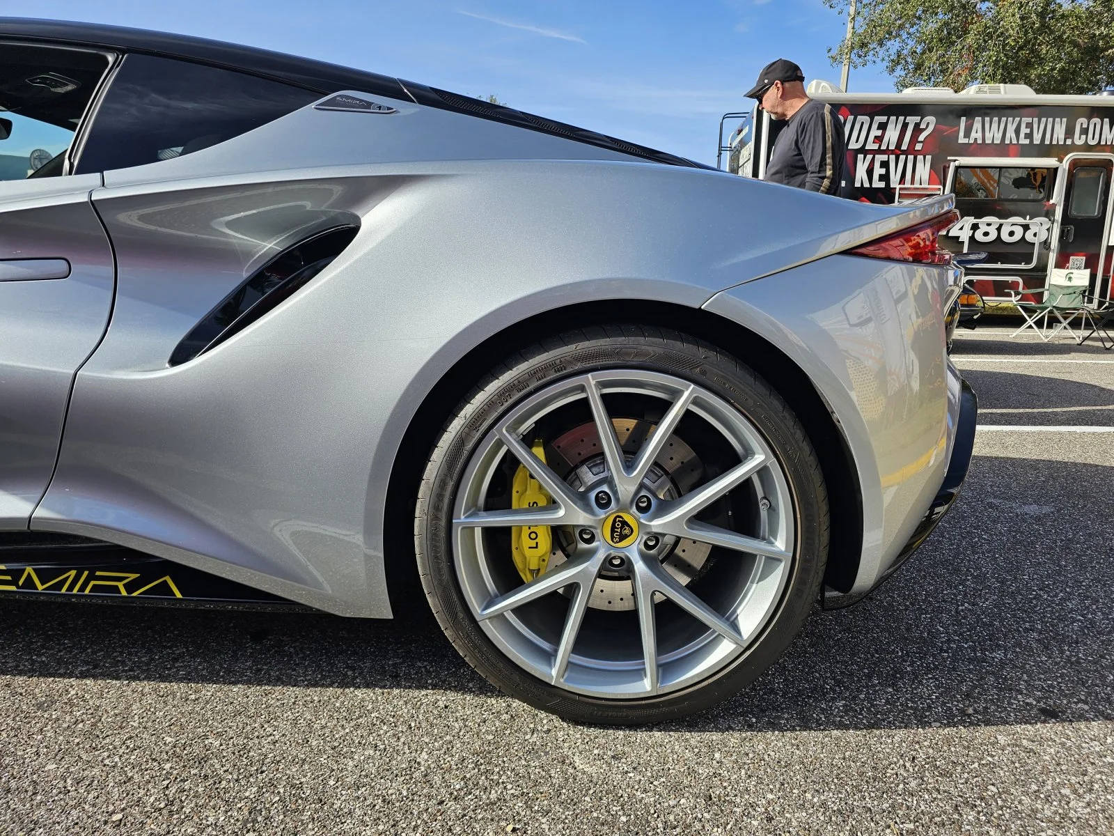

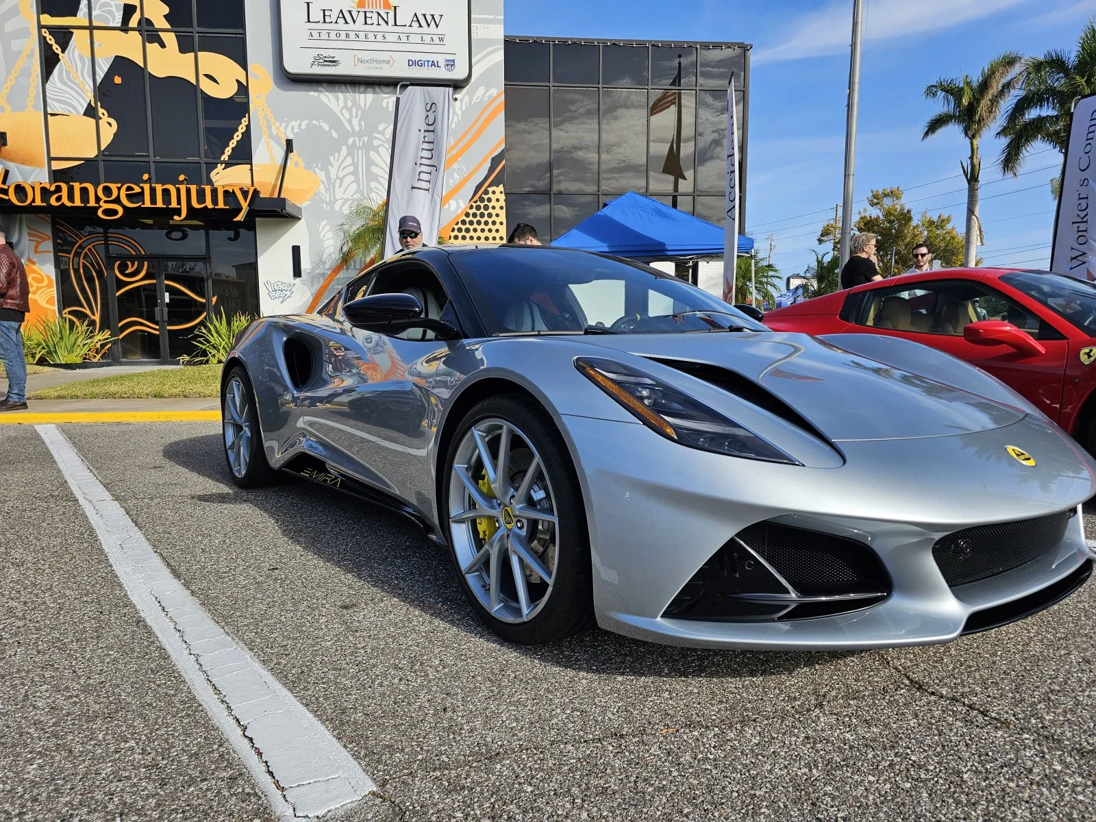

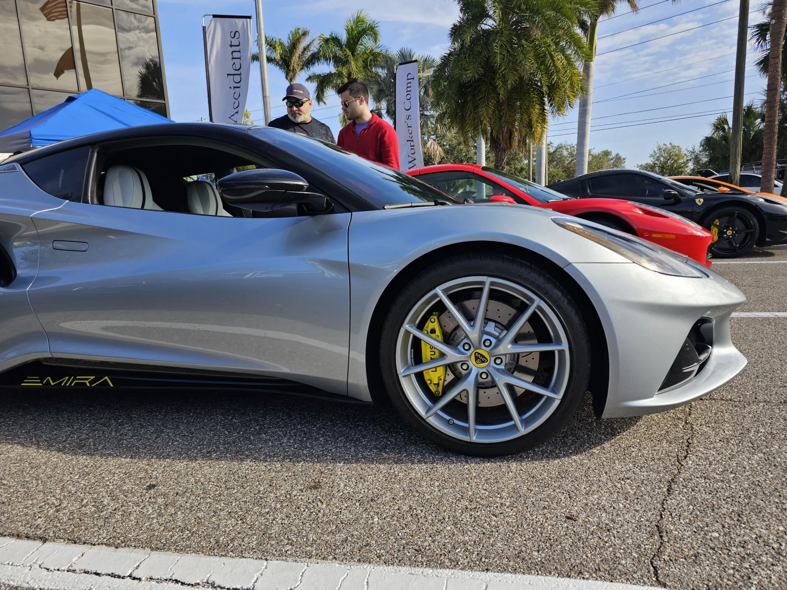

Here are 10mm pics.
Here are 10mm pics.

No issues on mine so far.. I have been driving quite a bit on them (about 500 miles so far) and although I adhear to the speed limits everywhere I can tell you I have been on the highway and no issues at all.

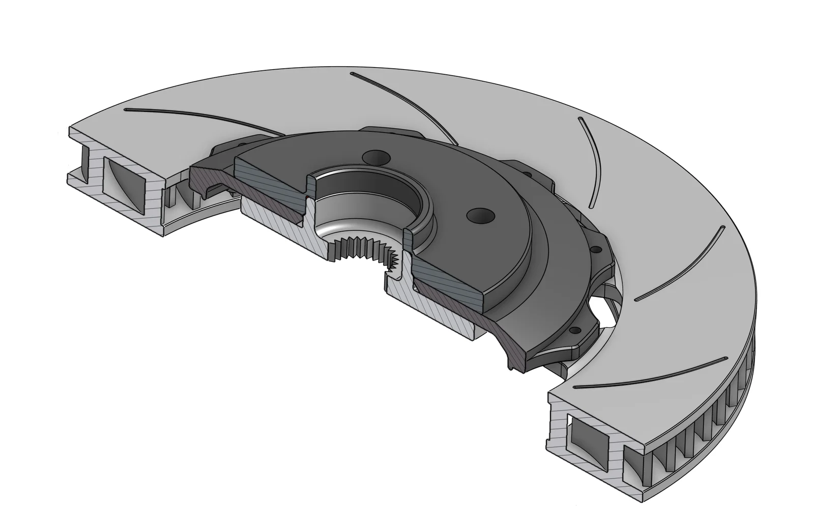

As for 10mm hub-centric spacers, I'm not exactly sure how the heck that works. There doesn't seem to be enough space for a 10mm hubcentric to work and actually press against the rotor face with a 12mm long hub interface to make friction force to hold the wheel in place. This is a rough model I have made of the OEM hub interface, a Girodisc front rotor, and a 12mm hubcentric spacer. Anyone got any photos or measurements of how the inside of the 10mm hubcentric spacer is machined?
Section view applied to show you how the 12mm hubcentric spacer interfaces with the rotor hat face and the oem hub lip.
