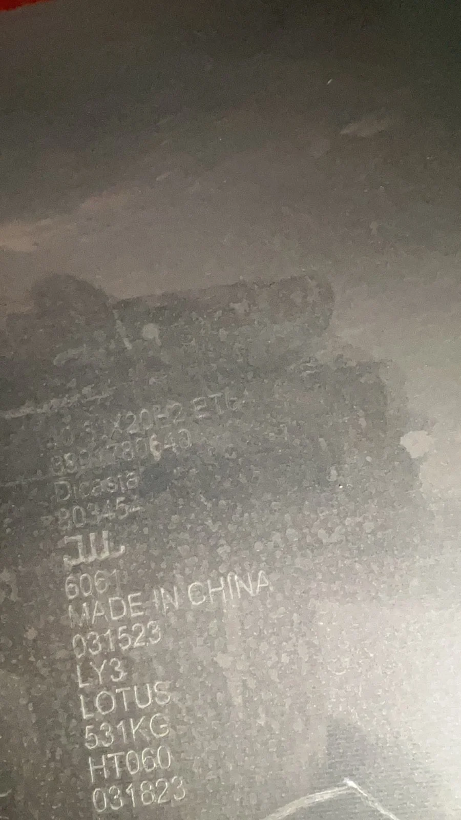

It is actually marked, but it’s not exactly obvious. I looked yesterday and didn’t notice. Most information is stamped quite clearly, but wheel specs are stamped very lightly, can just about make out ET64.

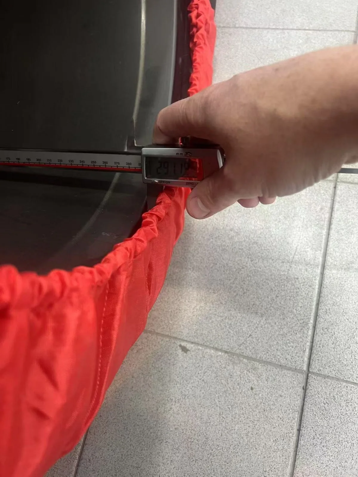

Measured OEM rim width and hub to rim.
209-(291/2)=63.5mm by my measurement, but hub was tricky to measure exactly.

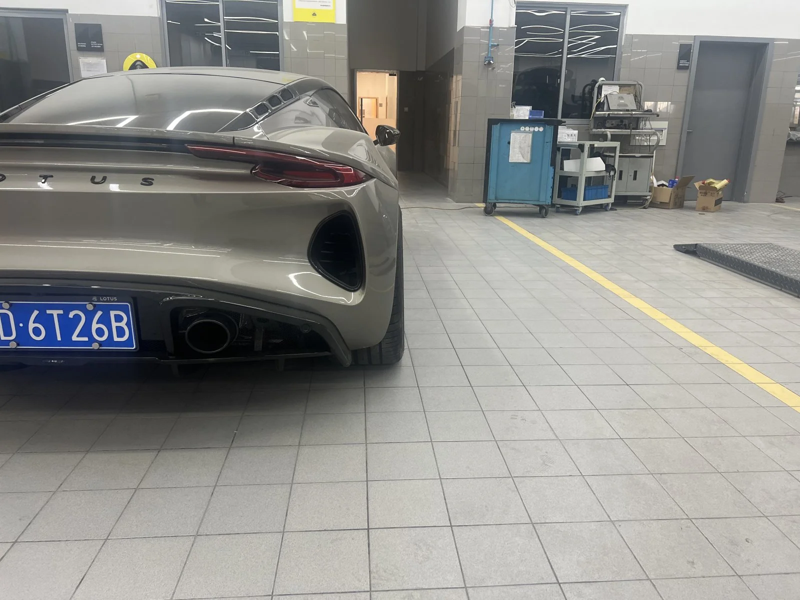

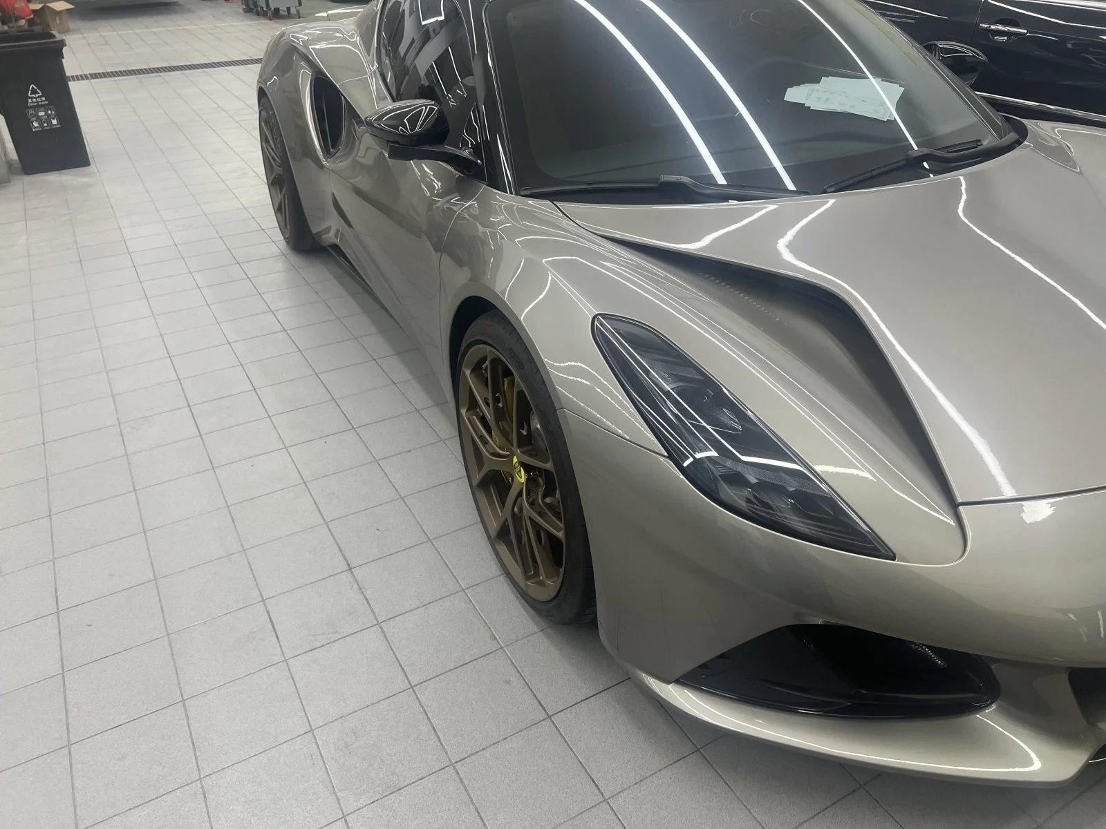

Yes, exactly the same. It pushes the fronts out 12mm and the rears 15mm (on a V6) on the outside face of the rim. However with ET64 instead of ET54, the rears are pushed out 25mm reference to standard wheels, which is too much. It looks silly and will rub.

Checked the OEM wheels and got circa 295mm width and 210mm inside rim to hub. This comes out to the below:
210-(295/2)=62.5mm offset (not 54mm)
I didn’t have a suitable sized caliper to check the OEM and new wheels accurately today, but I’m pretty sure any errors in the above will be minimal.
