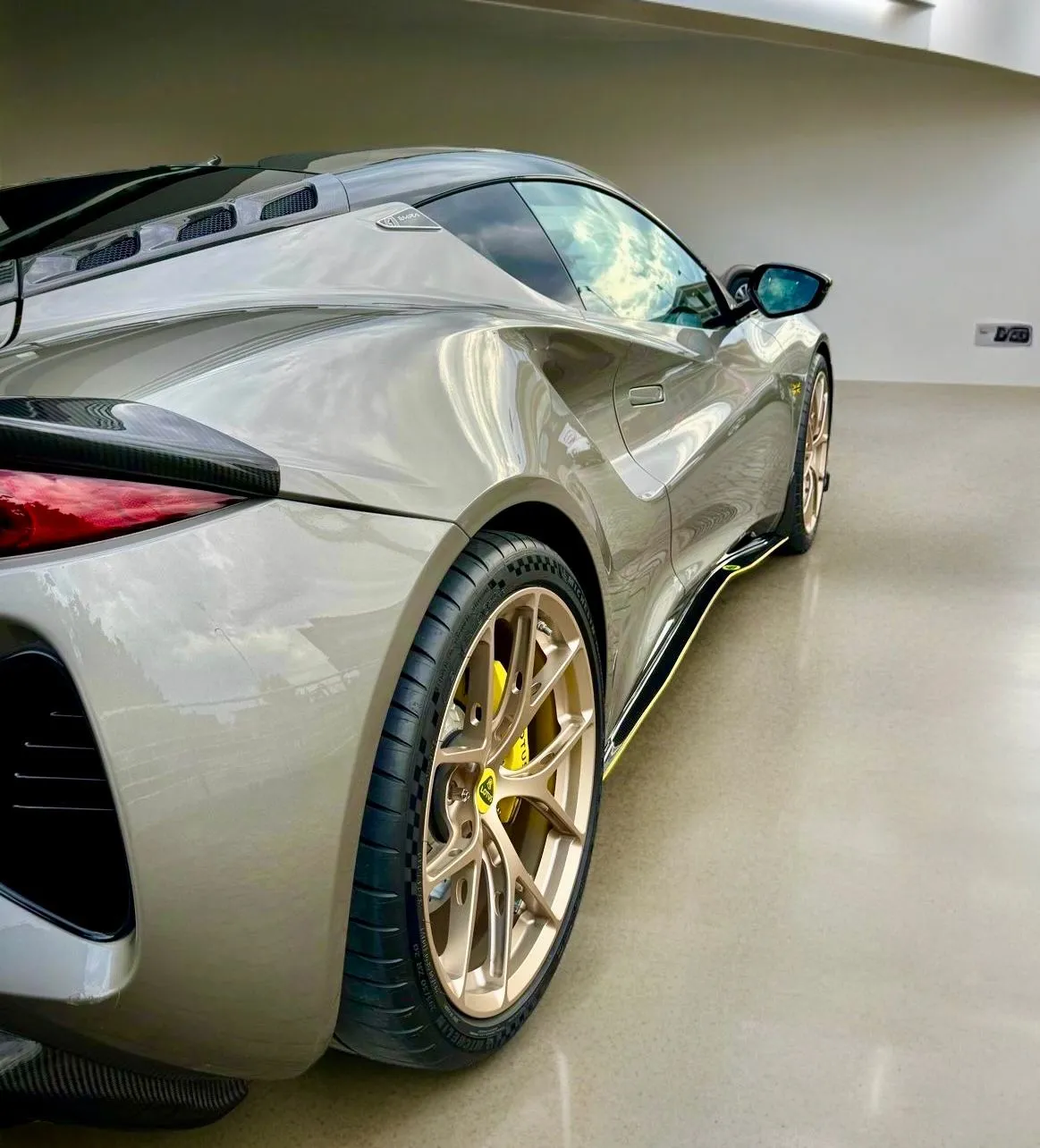

As per the subject, I’m trying to decide what offset to go with on a set of Aerie V2 rims. That’s my favourite style they offer I think.
Currently running 12mm spacers all round. Standard spec is:
Front: 8.5x20 ET 57 (ET45 with Spacers)
Rear: 10.5x20 ET 54 (ET42 with spacers)
The current setup (12mm spacers all round) pushes the fronts just a fraction outside of flush and rears slightly inside flush. My car is lowered circa 10mm below standard, but I could very likely fit coilovers sometime in the future and go a little lower. Lowering does bring the wheels inwards.
I’m tending to 1 of 3 options:
1. Stick to the effective offset I have now with 12mm spacers on STD wheels.
2. Run 10mm (2mm less than now) on the front, 12mm on the rear.
3. Run 12mm on the front, 15mm on the rear (3mm more than now).
The pics show the current setup with 12mm spacers.

Are you on GRP lowering sleeves ?
No, the I4 sport can be lowered around 10mm by moving the circlip on the shocks. Not a big drop, but it’s noticeable.

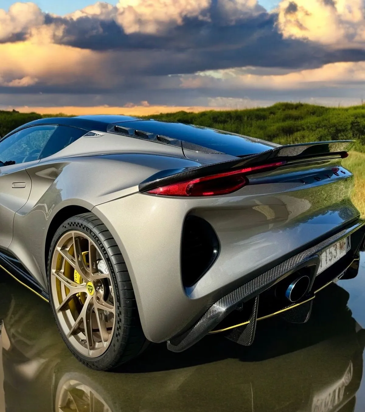

I ordered a set of Aerie V2 rims (beginning of November) in the size:
Front: 9x20 ET 51, Rear: 11x20 ET 45 and will mount original 245 & 295 tires.
My Emira is lowered with the Öhlins chassis from JUBU about 30mm !!
I'm curious when the rims will come and whether that fits !!

I was also considering to go wider rims, but wasn’t sure as not heard about others doing this. I need to look at your numbers and see where that places the outside edge of the time. With 12.7mm wider rims, you would need to reduce offset by approximately 6mm to maintain the same position of the outside face of the rim.

I think your wheel specs are ok. You’ve pushed the rears out equivalent to 15mm rear spacers. With a more stretched tyre, it should help with clearance (not that there would be a problem anyway).

What wheel colour did you choose and on what car colour?
Ich habe dieses Off-Set gewählt, weil ich die Optik (die Felgen werden nach meinen Wünschen mit mehr Konkavität gefertigt) verbessern möchte.
Meine Emira ist Osmium Silber mit Black Pack. Die Aerie V2 Felgen habe Ich in Schwarz Glanz bestellt !!
