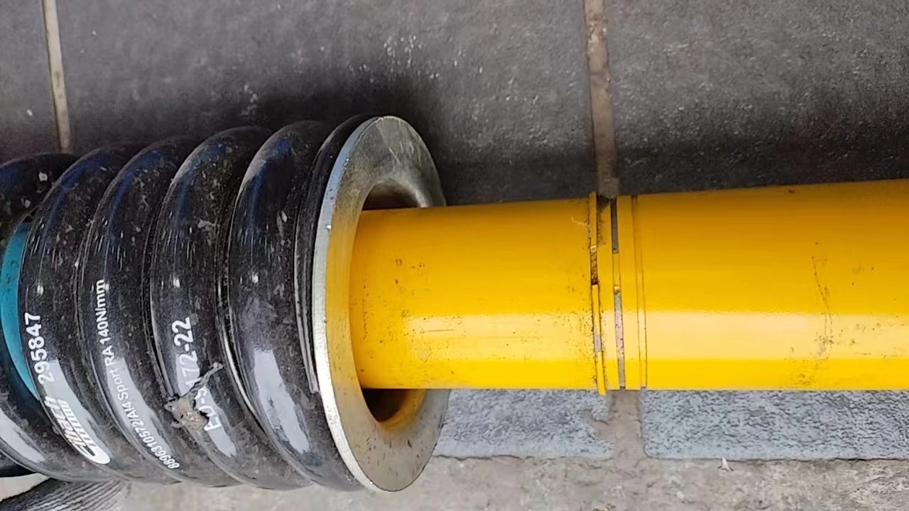

I’ve now lowered it a little by just moving the shock circlip and am happy with the results (10mm difference on the shock). Not a big drop, but enough IMO. The roads around here can be pretty terrible, not sure I’d want it much lower, or firmer than it is now.
Using this approach will actually get your a softer ride
I believe spacers (or higher offset wheels) effectively reduce the spring rate a little.
Many thanks for the tip/info about the suspension circlip modification (y):cool:

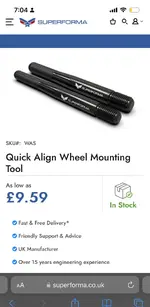

I have hub centric spacers as well but it’s still easier than you think to not line them up 100% which can have an effect. The lining up tools are pretty cheap and as long as all faces are clean gets it perfect every time. My mate let me use his and I realised how easy it was to change a wheel.
Ok, wasn’t aware such a tool existed. Something like this?
