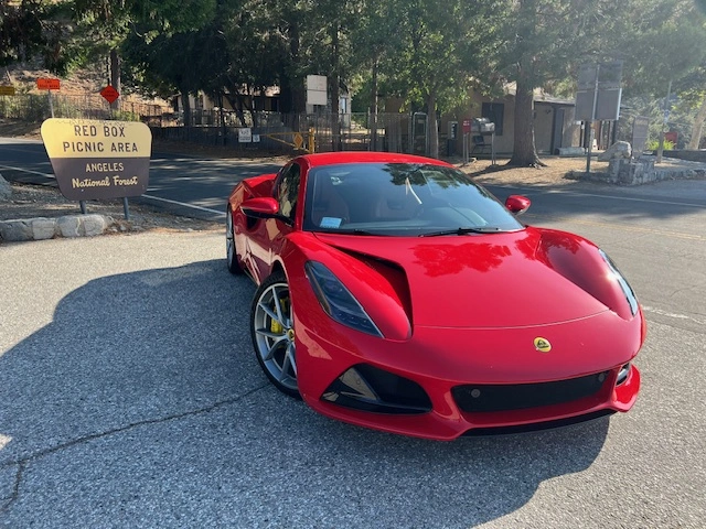

12mm spacers, seems a bit much on front
Anyone have any issues with vibration or safety concerns on the road and heavy track use with the 12 mm spacers?

When I was running the GRP 12mm spacers I had no issues or vibration they were perfect - also I felt the fronts could come out a little more, probably easily 2mm for 14mm total.
0 issues with my GRP 12mms all around, though I feel like 12F/15R would have been a better fit. I'm also dropped 1" all around with GRP lowering kit.
0 added vibrations or wobbles at any speeds I've driven.
If you get any sort of wobble or added vibration, remount them and make sure there is no debris in between the hub and the spacer. Torque the lugs to ~80ft-lb (around 108nm) and check again, if issue persists, remove the spacers and sanity check if the spacers are indeed causing issues.
But yeah if you are going to get wheels soon, dont bother with spacers. Save a small chunk on spacers + extended bolts.
