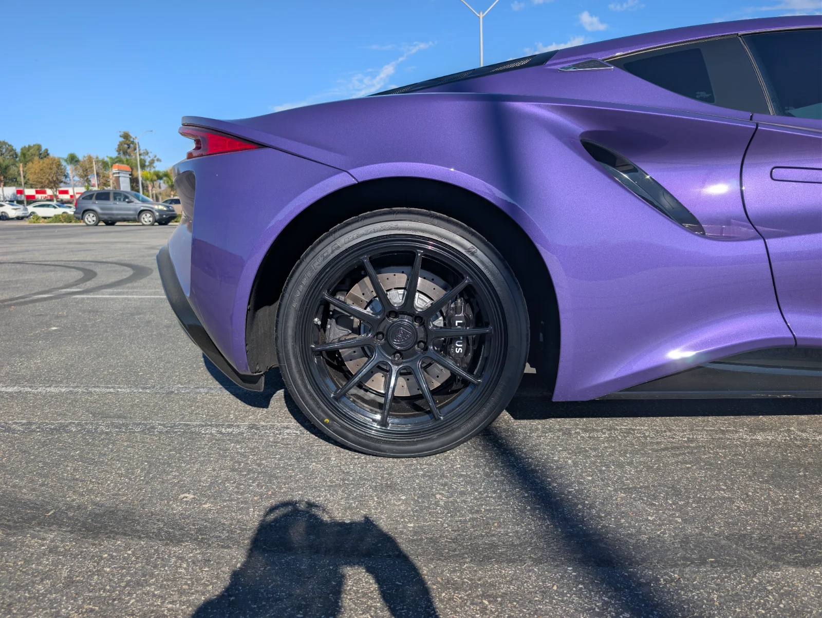

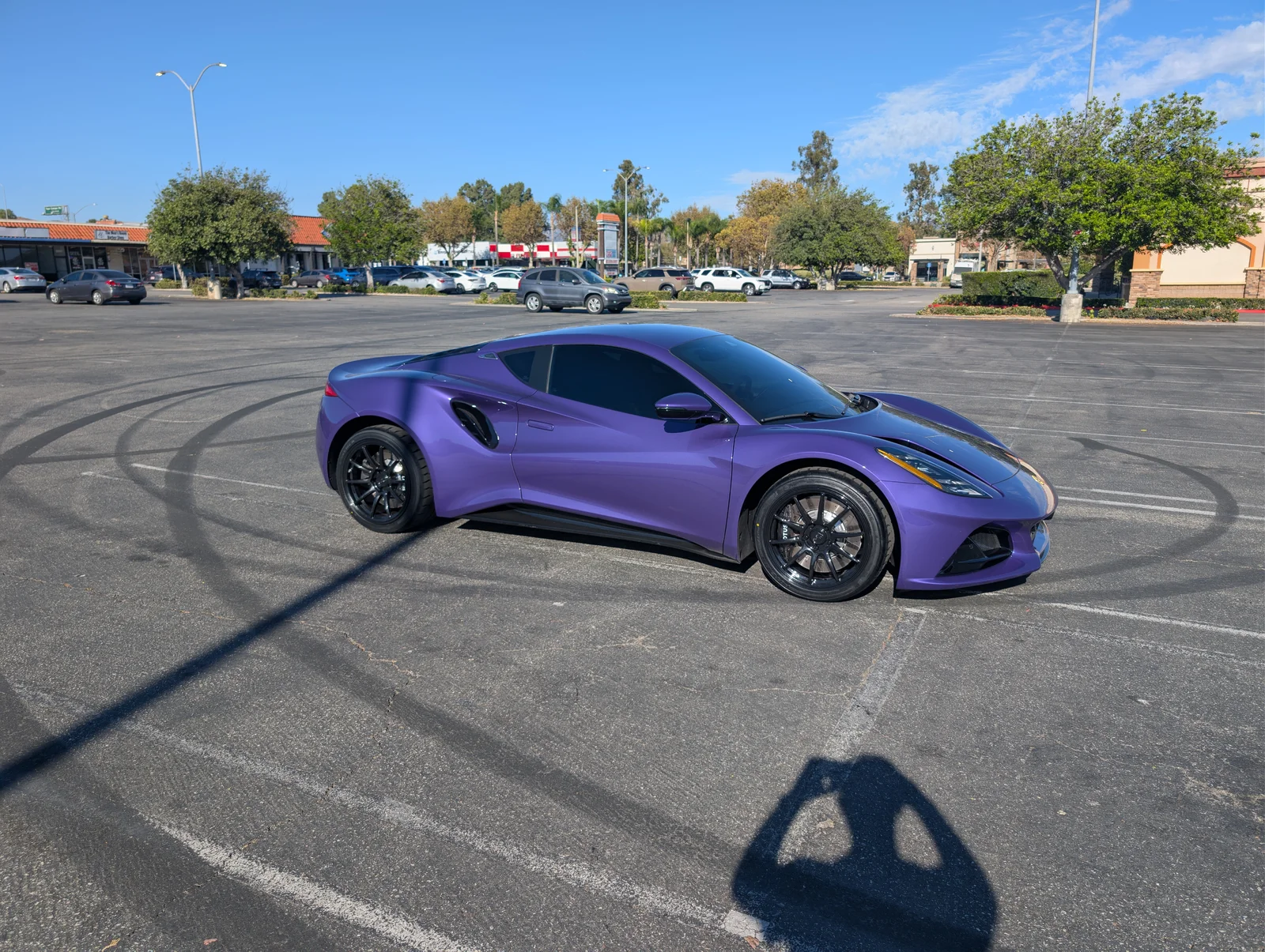

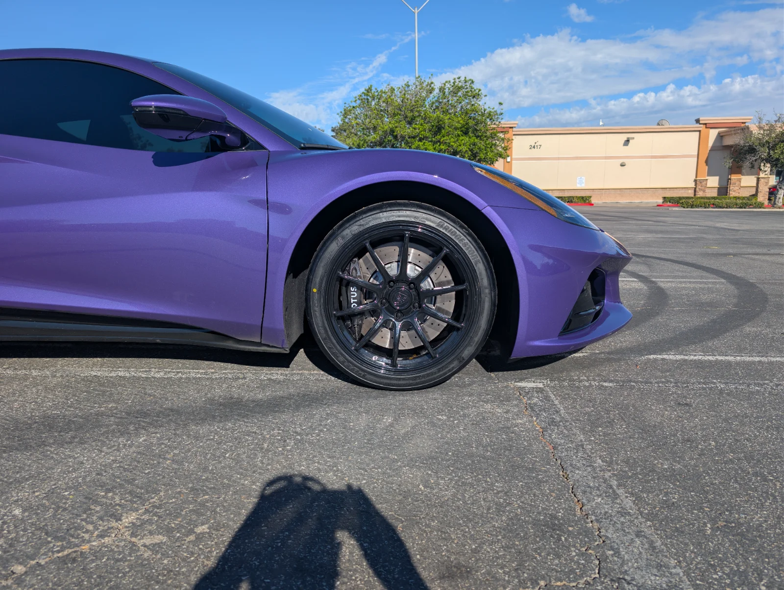

Correct. OEM width. I think when I did a quick search there were more tires for OEM widthWhat width did you end up going with on these wheels? I see they offer three variations. Sorry if I missed it!

my decision I think was when I looked at suitable 200TW tires. I found there was a much better selection in the stock width. Otherwise, I would have leaned towards GT4 widthThat’s what I had in mind to purchase. Any reason to go with the GT4+ width? I also didn’t see anything about offsets, but I struggle to see things directly in front of me.
