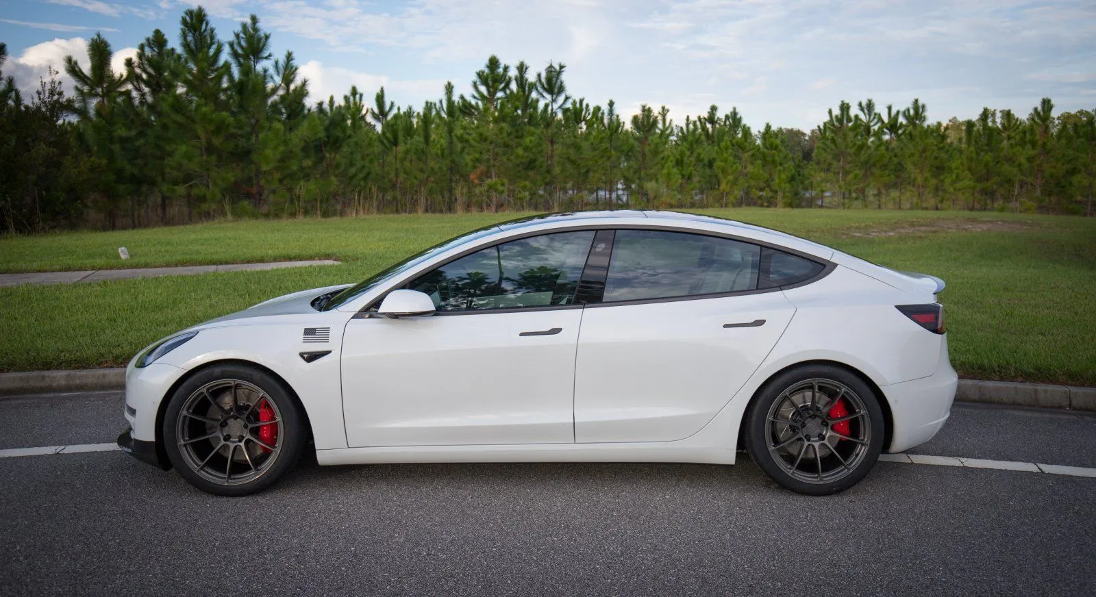

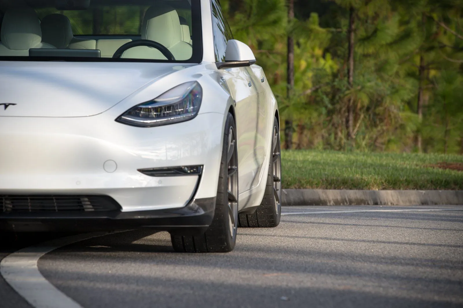

Awesome, really curious on what the weights come in at as well. I'd guess ~20lbs front/22lbs rear or so based on past experience. I've got 2 sets for my Tesla for street and track setups and have been really happy with them. Do you mind sharing how much they charged for the set? You can DM if you prefer. Some photos below. I think yours should be a similar fitment on the Emira as the rear tire in the last photo:
SV104 19x8.5 ET20 in brushed titanium=18.8lbs
245/40/19 Michelin Pilot Sport 4S
SV501 19x9.5 ET35 in matte gunmetal=19.4lbs
265/35/19 Pirelli Trofeo R

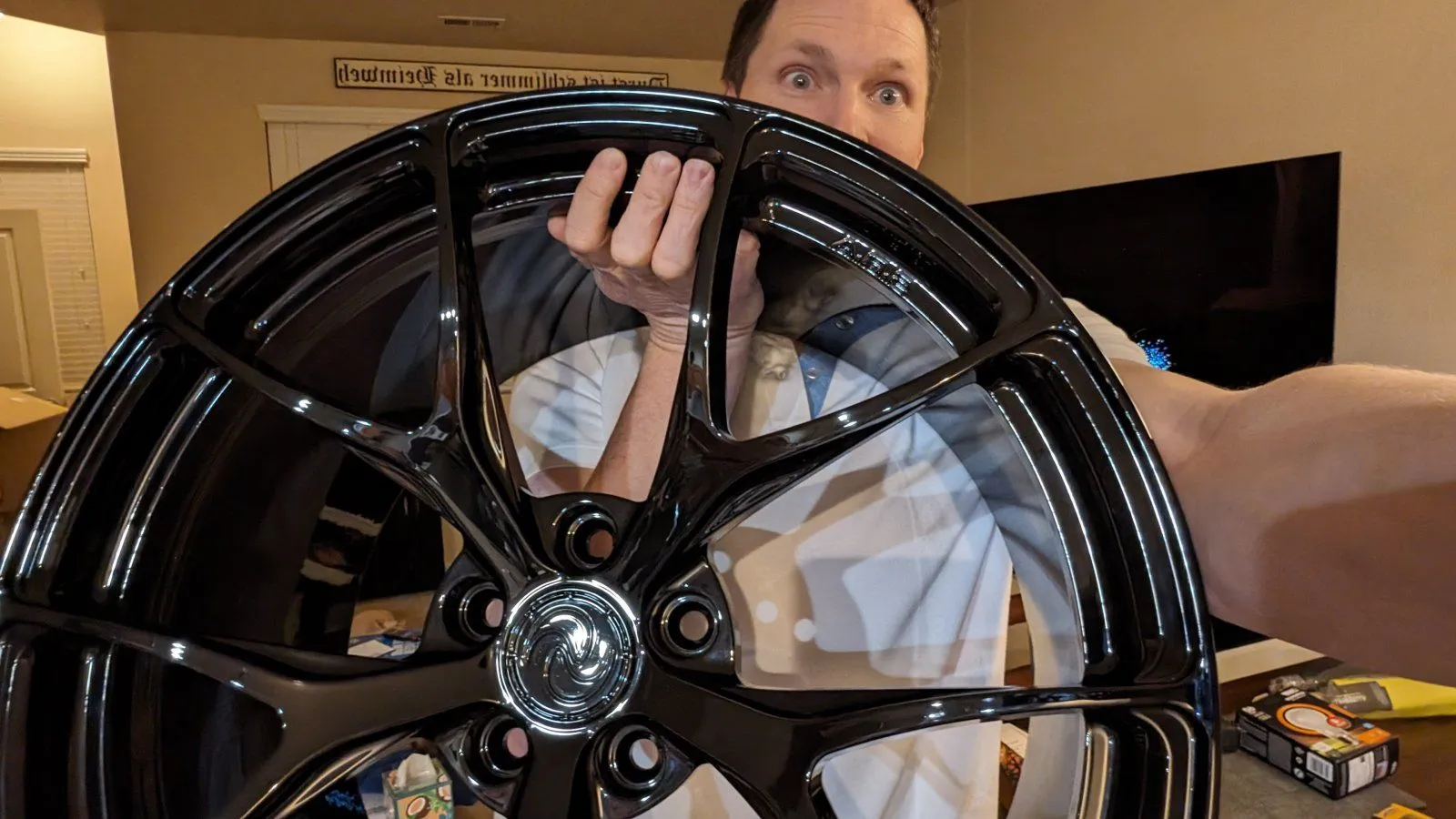

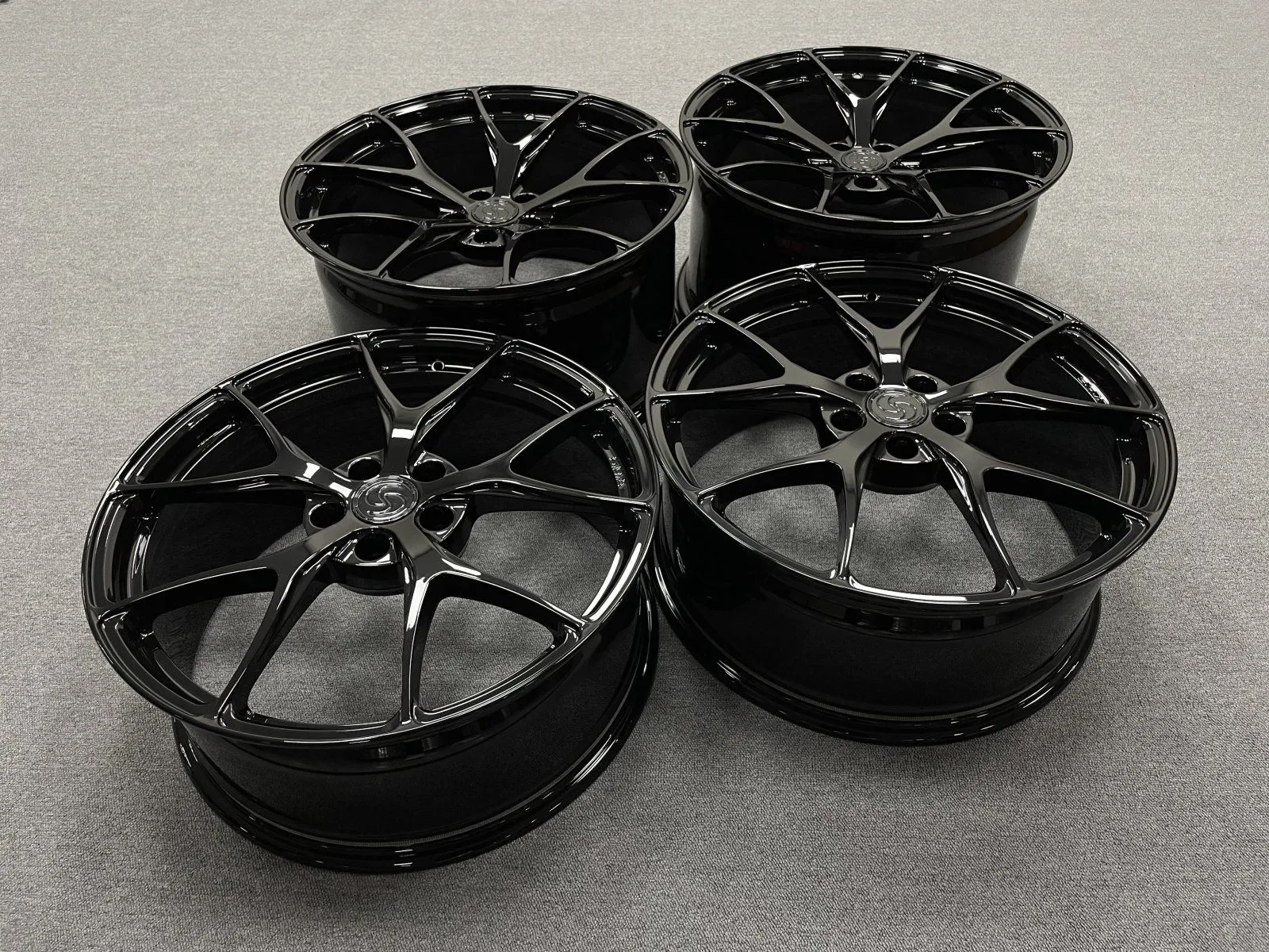

Well these got here very quickly! They look amazing and come with blank center caps as spares.

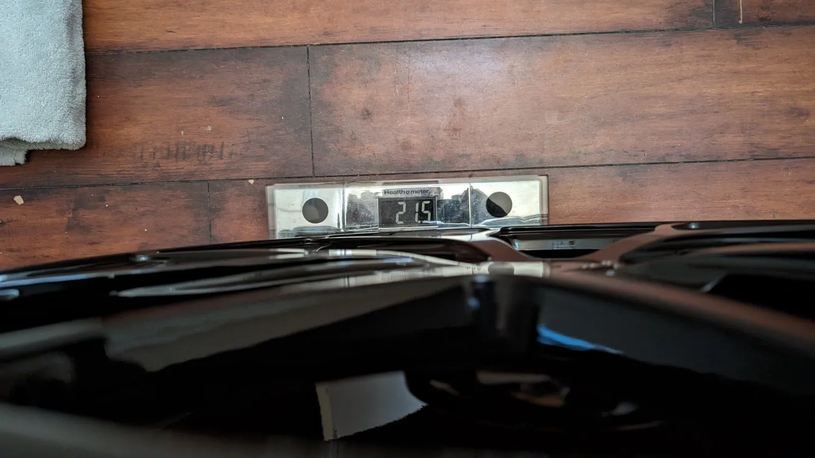

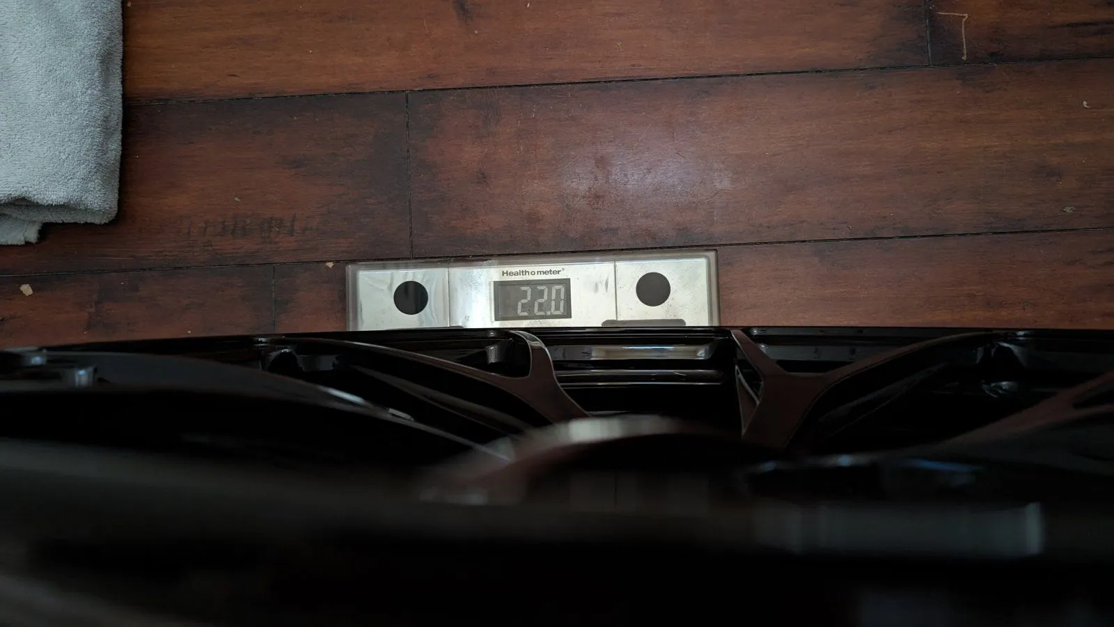

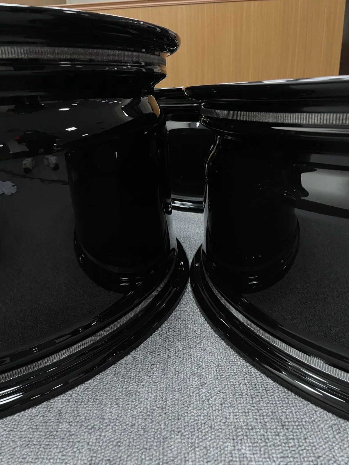

Out of curiosity how much did they end up weighing?
Front
Rear
I'm surprised they're only a half pound difference between the 10.5 and 8.5 width but I weighed them alone and with me holding them.
I did opt for the Signature Reinforcing Architecture (reinforced band just inside of the spokes) that adds 1.5-2# per wheel but I wanted the peace of mind over total weight reduction.
So 3.8 lbs saved per front, 7.7 lbs per rear. 23 lbs total unsprung weight.
@JohnB it's a little less than a quarter inch but it meant I was still inside the body work which I wanted for clearance and for debris and tire spray, and that I was able to get a little more of a deep dish effect on the wheel. As you can see the back looks pretty deep while the front is minor but present.
