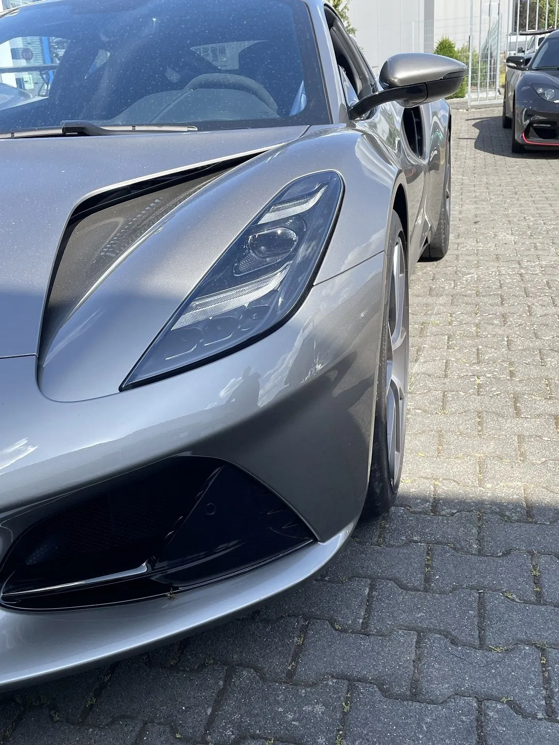

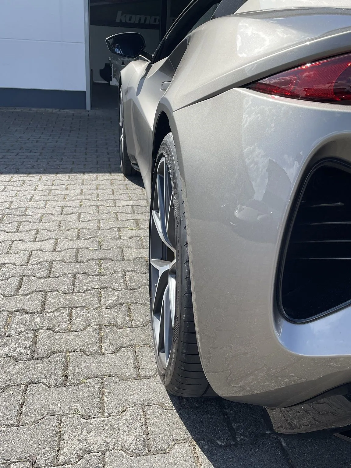

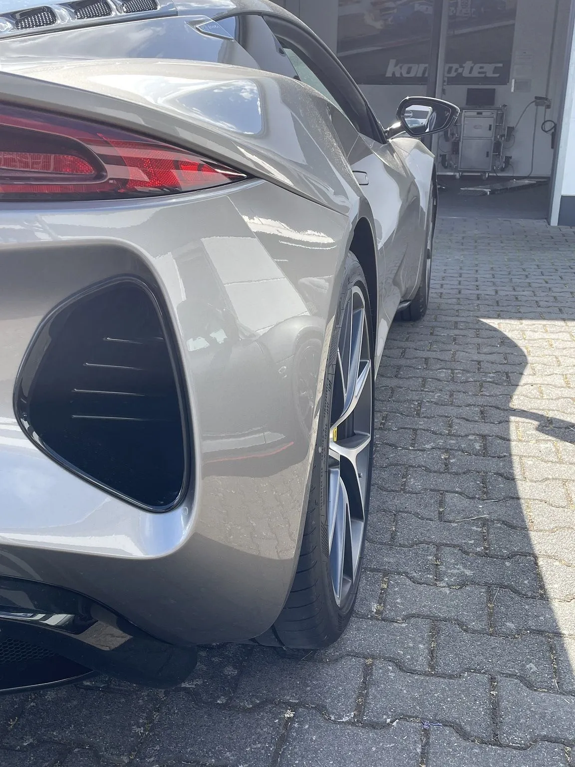

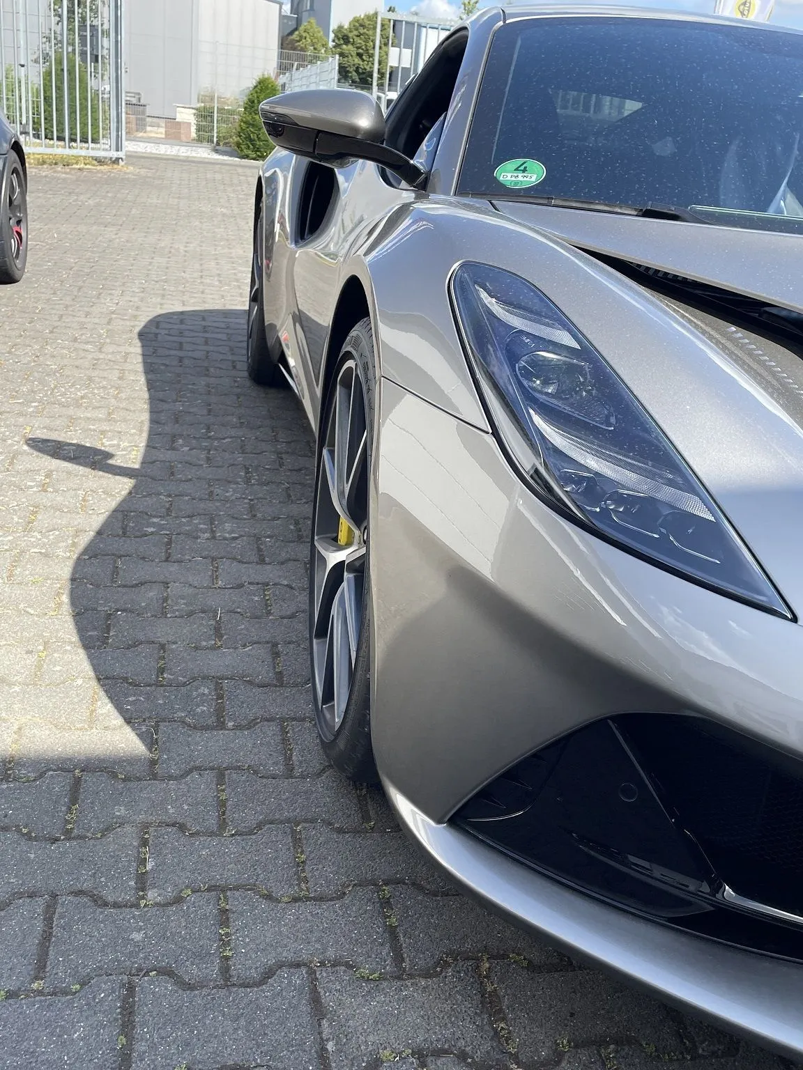

Hallo Zusammen,
Ich habe an allen 4 Rädern H+R Distanzscheiben in 5mm. Optisch perfekt und vom Fahrverhalten kaum bemerkbar. Habe ich bei KT einbauen lassen und für Deutschland natürlich mit TÜV Eintragung.
Hi, do you have some pictures with the spacers on your car?

Cool. They look nice. Curious to hear your impressions and it would be great to get a confirmation on the weight difference between the Aerie rims and the standard rims.

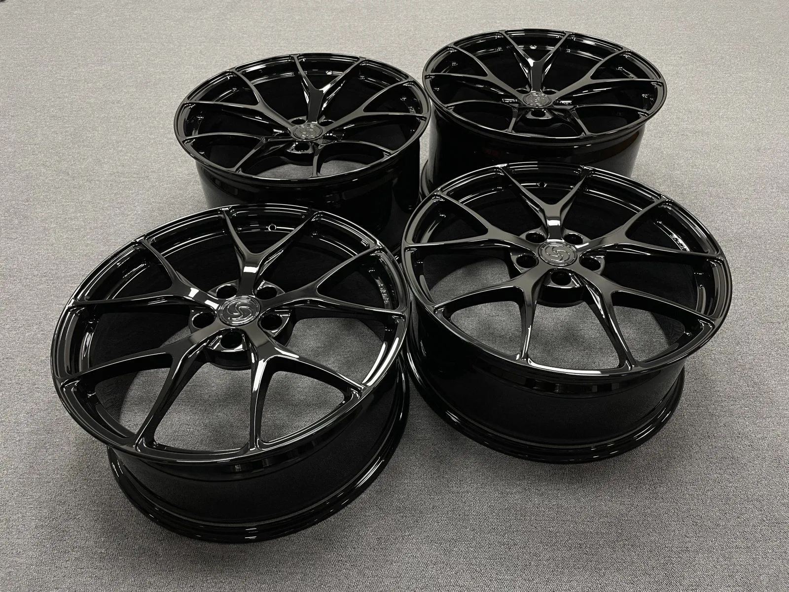

Went with Aerie’s V2 Forged in a custom desaturated Gold satin finish.

Thanks. I’ll certainly share my impressions (probably in a video) and I’ll definitely weigh them.

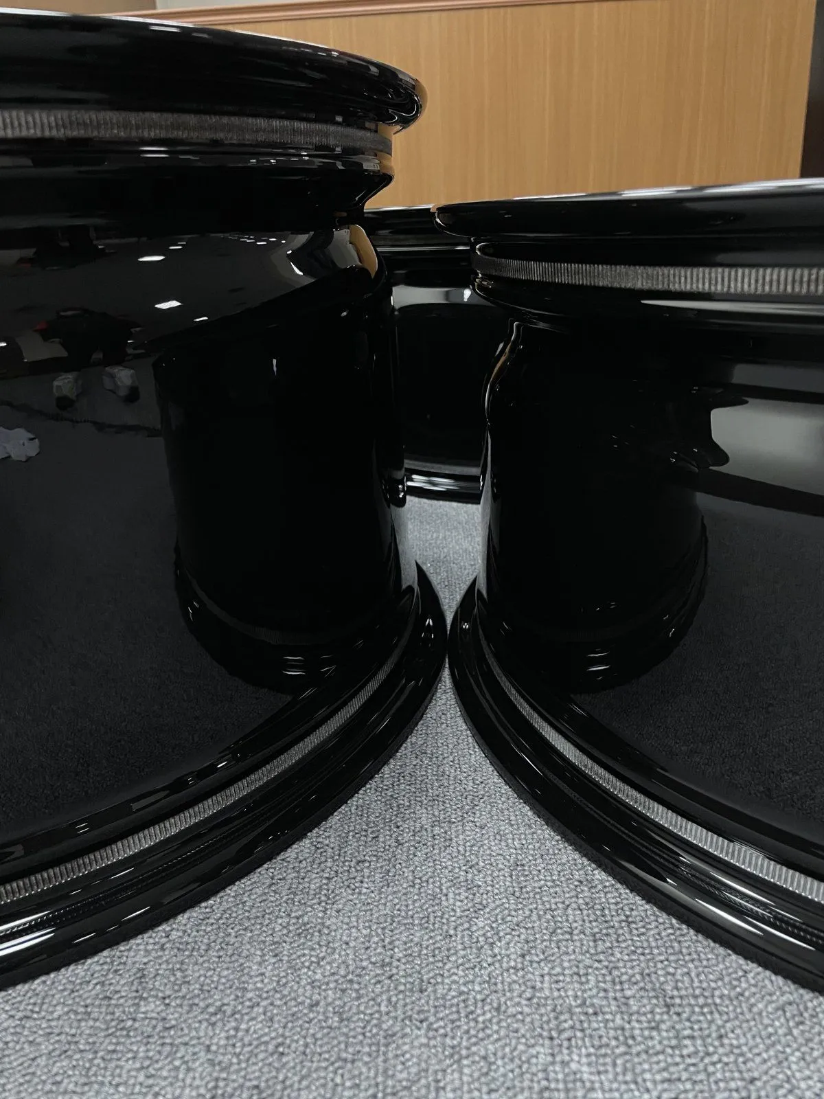

My Signature Wheels are on the way! I had them pushed out to 2mm under inside of flush.
SV104 in gloss black with friction lock and SRA
Front:20x8.5 ET52 20.7#
Rear:20x10.5 ET47 22.8#
Weight savings over stock 23.3#
