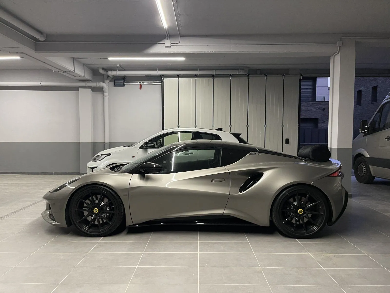

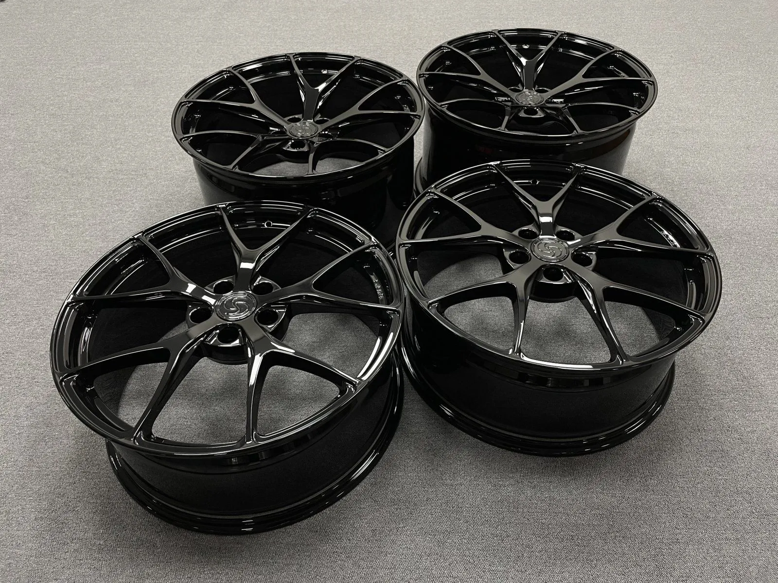

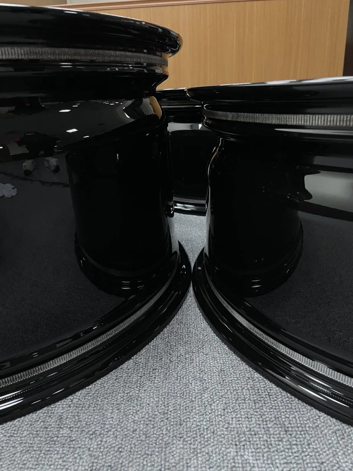

My Signature Wheels are on the way! I had them pushed out to 2mm under inside of flush.
SV104 in gloss black with friction lock and SRA
Front:20x8.5 ET52 20.7#
Rear:20x10.5 ET47 22.8#
Weight savings over stock 23.3#

I asked them that too. They don't have weights because they're made to order. You can take mine and subtract about 1.5-2# if you don't take the SRA option.
