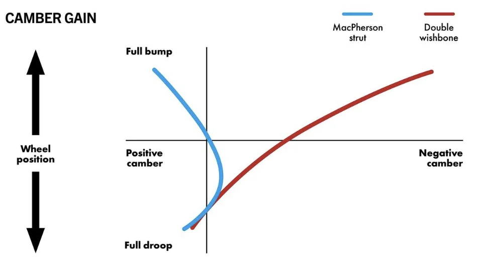

The negative camber needs of the Emira maybe different than that of many other cars that use strut-type suspension. The big benefit of double-wishbone architecture is that it provides more control of dynamic changes at the wheels.
The resultant impact on camber changes is nicely depicted in the following diagram by Grassroots Motorsports,. This is not the rule, but general natural of strut-based vs. wishone-based.
Interesting. I appreciate your explanation input
