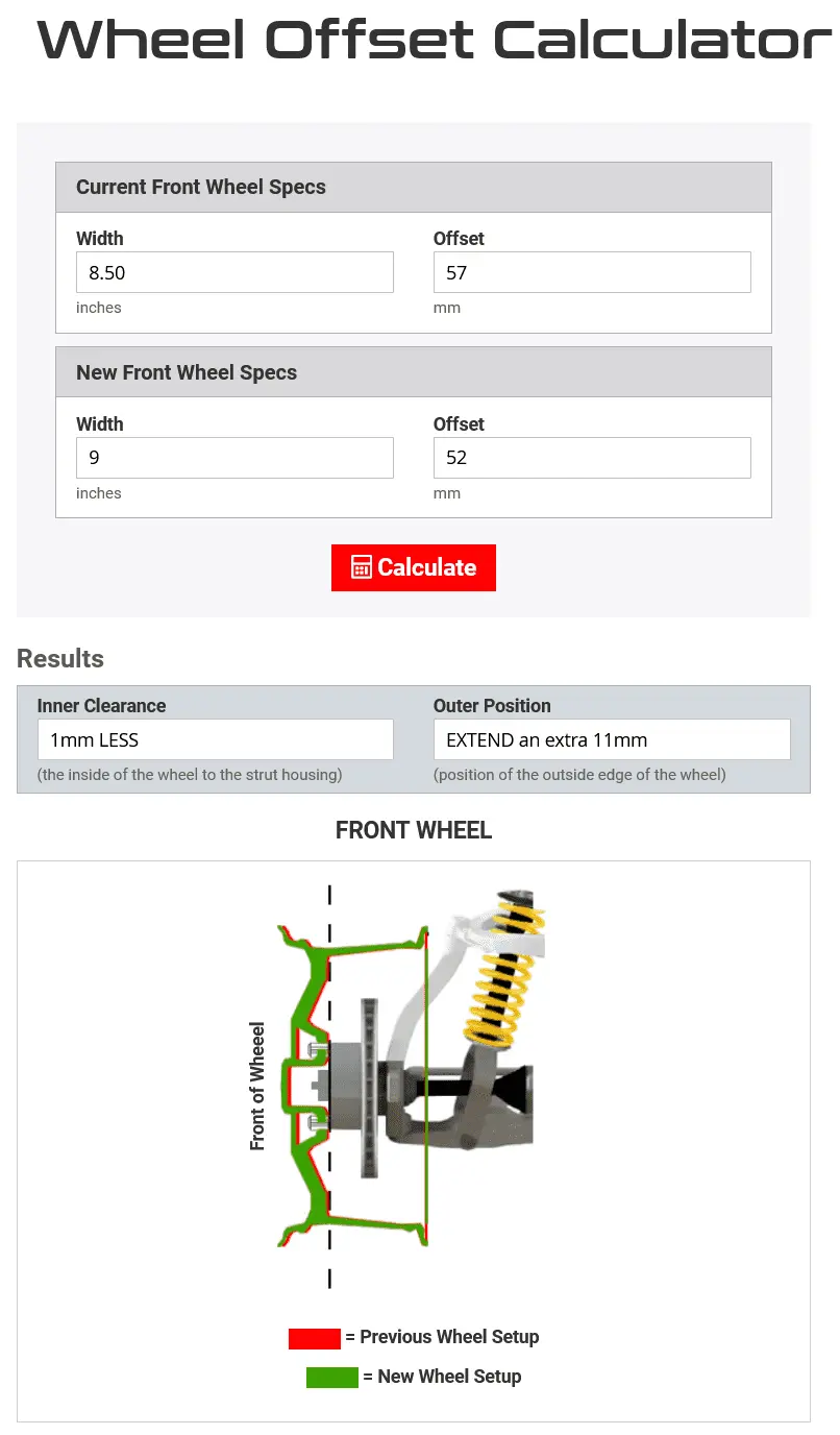

I'm planning to order some EMIRA wheels, but want to slightly modify the front wheel size/width for a staggered look.
FACTORY SIZE
Front: 8.5J x 20 ET57
Rear: 10.5J x 20 ET54
Factory Wheels are all 20" Non staggered.
MY CUSTOM SPECS
Front: 9J x 19 ET52
All I am doing is changing the front wheel from 20" down to 19" and then making the wheel 0.5" wider for a staggered look.
I used the following calculator to get the offset as close to factory

Why ET 52?
Per the offset calculator if i increase the width of the front wheel from 8.5 to 9, I would need to adjust the ET from 57 to 52 to make sure there is enough clearance and as close to factory.
That's doing the math for inner clearance (to the suspension) and maintaining the factory gap there.
I think in order to optimize this, you'll need to know how much room you actually have between the rim/tire and the suspension components.
Ideally for a 9" wide wheel l think you'd want to get your scrub radius (center of turning axis) as close to zero as possible, so that the center of the track doesn't change compared to the factory tuning. Increasing the scrub radius (moving the wheel/tire outward) will increase the perceived weight of the steering and change how it feeds back information from the road to the driver's hands.
With a zero scrub radius change and 9" width, I'm calculating a retention of the 57mm offset. That moves the inner wheel/tire surface inward by 6mm toward the suspension, and also 6mm outward toward the fender. If you have the room on both sides, that's a good solution. Here's a zero scrub radius example: https://www.wheel-size.com/calc/?wh...40-19X9ET57&fcl=50mm&wcl=30mm&scl=50mm&sr=0mm
If you don't have the clearance inboard but you do outboard, you'd want a lower offset as your math indicated, something like an ET54 or ET52, depending on how much clearance you really need inboard. Here's a conservative example that would probably be workable on the actual car even if the factory inboard clearance was relatively tight: https://www.wheel-size.com/calc/?wh...40-19X9ET54&fcl=50mm&wcl=30mm&scl=50mm&sr=0mm
If you do have the clearance inboard but you don't outboard, you could go to a higher offset like an ET60 if necessary, but that's not typically encouraged since it tends to make the steering lighter.
